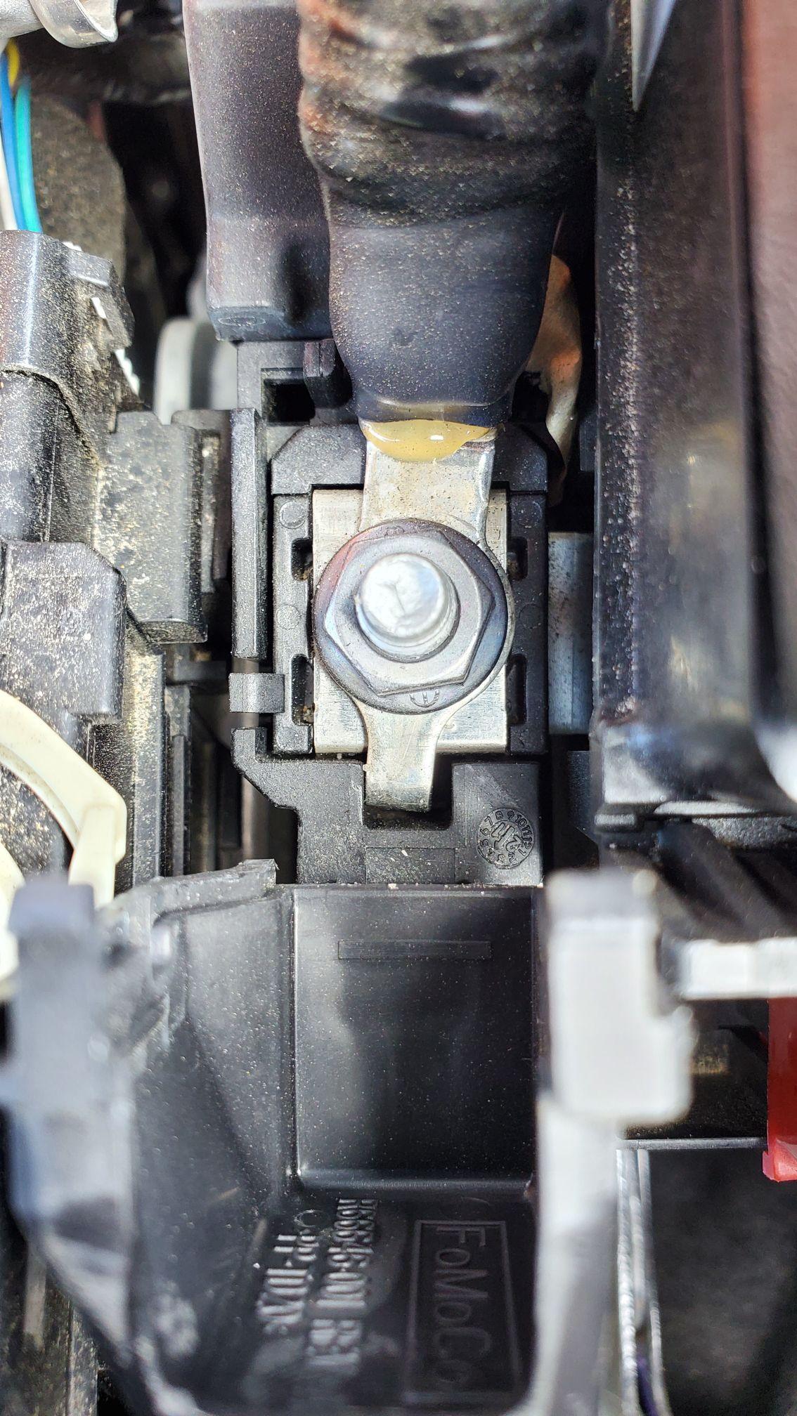

Wiggle the cable connection and see if you are able to start it.
I tried wiggling it around a little bit and then pretty firmly. Feels pretty solid still. No dice.
With that and the fact that your battery was reading 12.5V, it definitely sounds like a different issue.

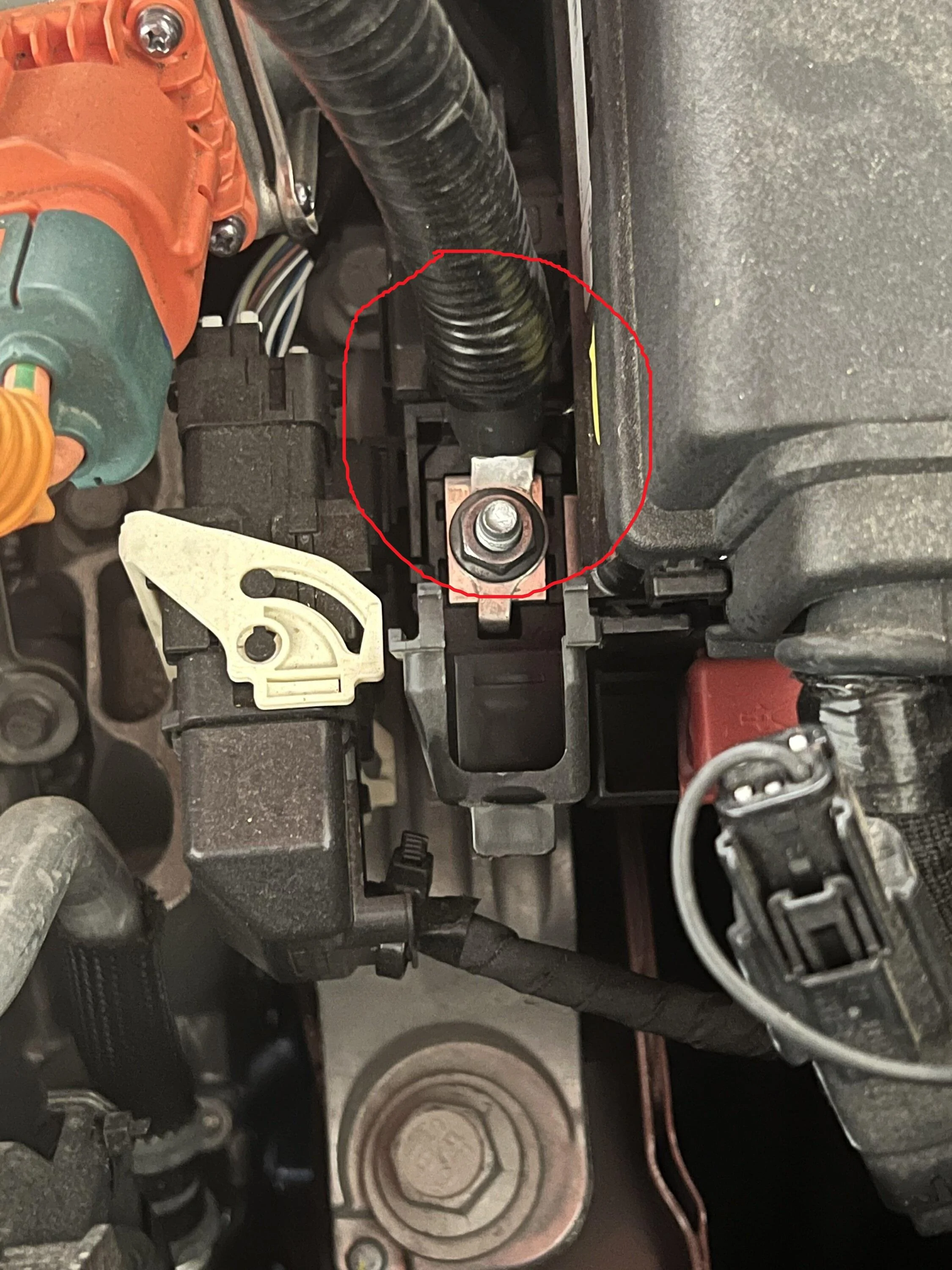

Note! you have to pop that black cover down to see what is pictured here. BTW the red cover to the right is where you would jump start it. Do NOT jump from the wire in the picture.
