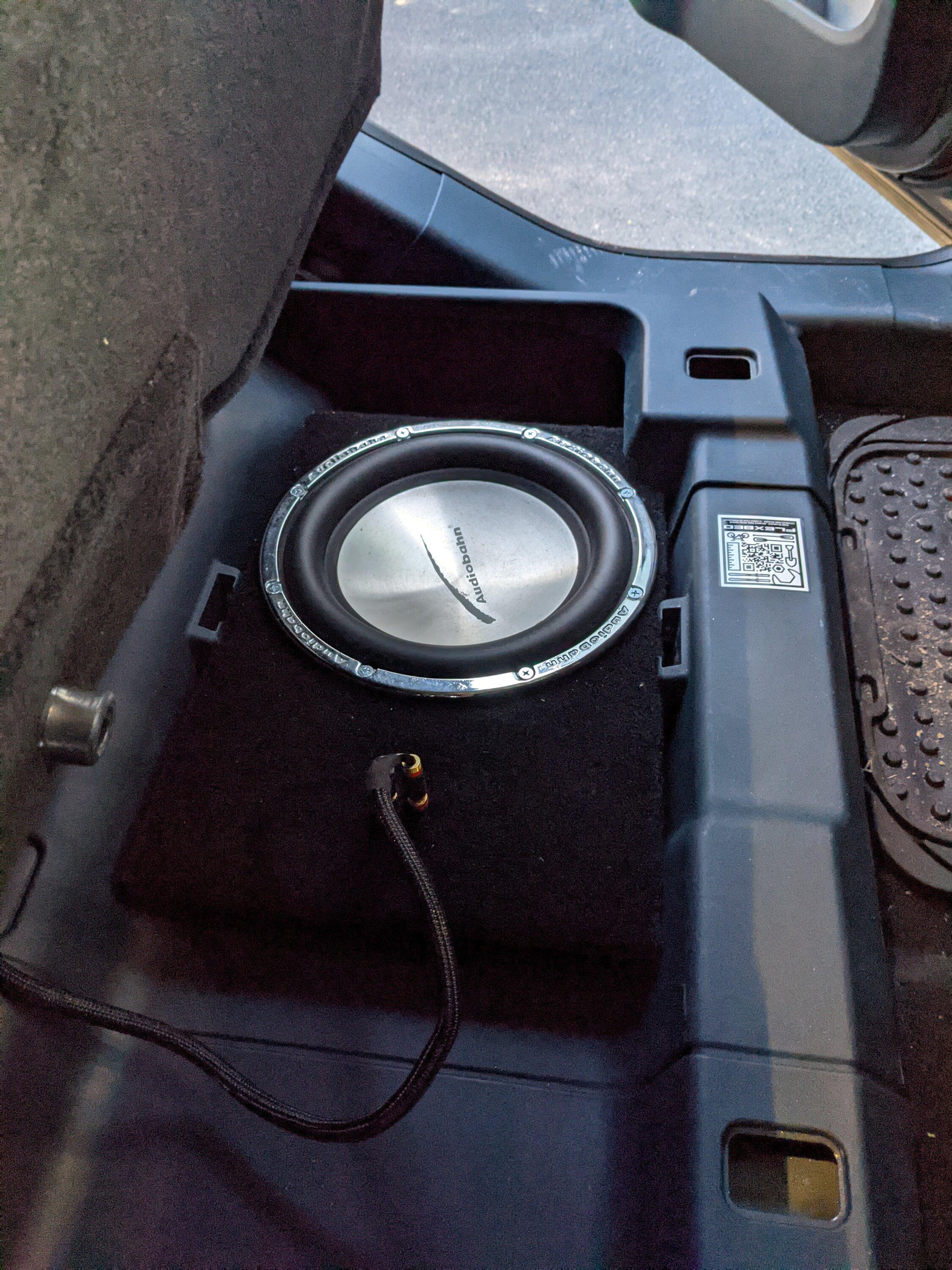

Pretty much done with the audio upgrade, but I will update this thread with any new changes.
There are already lot's of great threads and videos that show the step-by-step, of wiring etc, so I didn't document that. However, I'd be happy to answer questions regarding wiring things up.
I used the PAC audio LPHFD31 to integrate everything without modifying the factory wiring. A standard 8ga amplifier kit, speaker wire and some RCA's were used. I had an old 1 farad capacitor, so I figured I might as well use it. Obviously, the hybrid makes 12v access super easy. I need to order another roll of Tesa tape and finish cleaning everything up. I'm going for an OEM+ look.
The DSP is the Expert PX2Connect and can be found on Amazon. I chose this one because it has the option of Bluetooth connectivity and still allows direct inputs if you don't want to use the app.
I've got a 4ch amp driving the front factory speakers and the 10" subwoofer. The rears are still powered by the factory radio.
So far it sounds much better. It's amazing how just amplifying the factory speakers improves their sound. And of course, adding a subwoofer is an absolute requirement. I'm still tweaking the DSP and hopefully I'll have it dialed in this week. I'm trying to avoid replacing the factory speakers, but I haven't ruled it out.

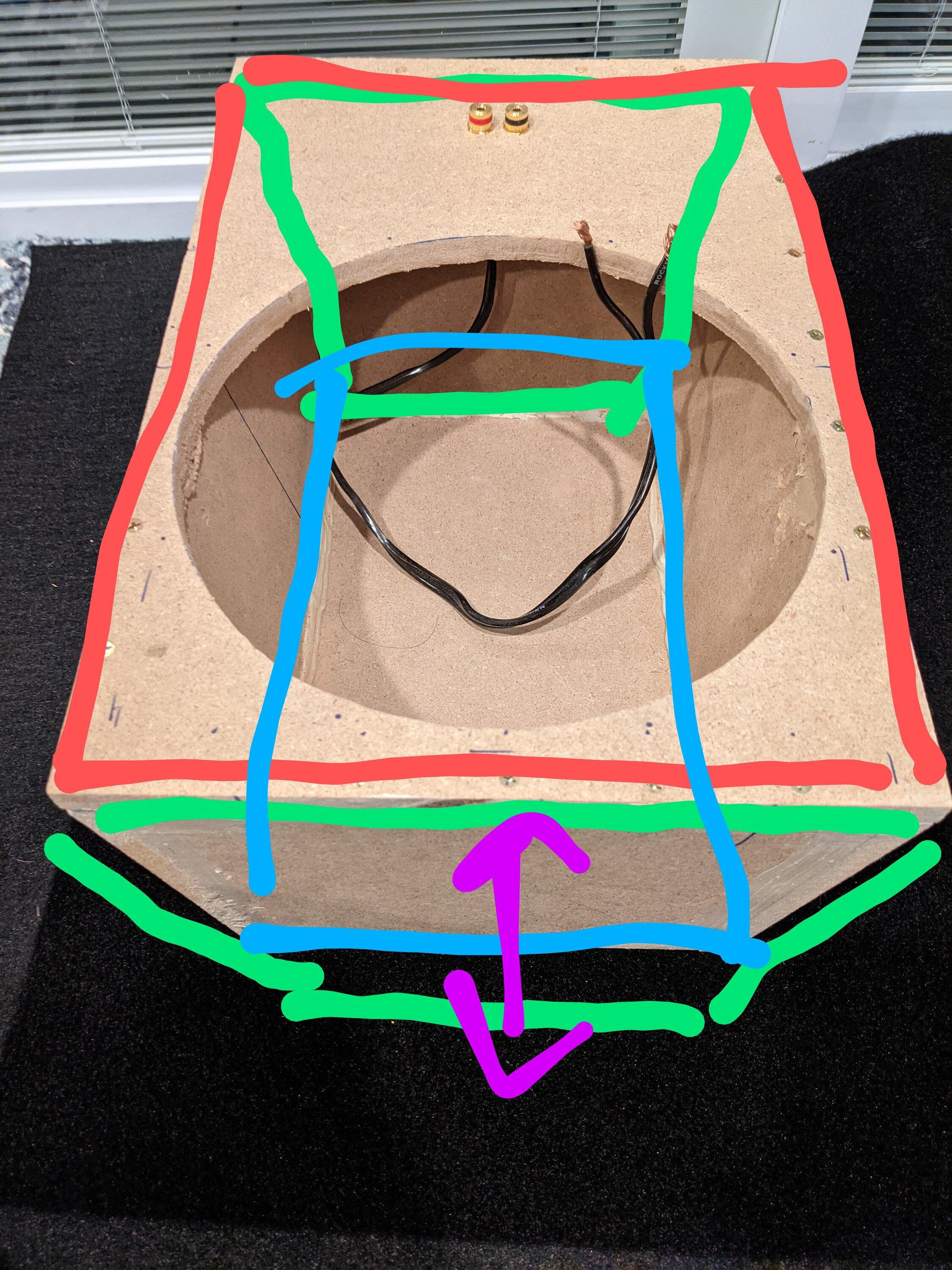

This is a great setup! What are the dimensions of your sub box?
blackb13
Nov 22, 2022
200
227
Using 1/2" MDF.
The baffle (red) is 16x10.5in and the bottom (blue) of the enclosure is 12x8.5in. The height (purple) from top of the baffle to the bottom, where the enclosure hits the bottom of the storage is 6.5in. The ends (green) and sides are angled to connect everything together.

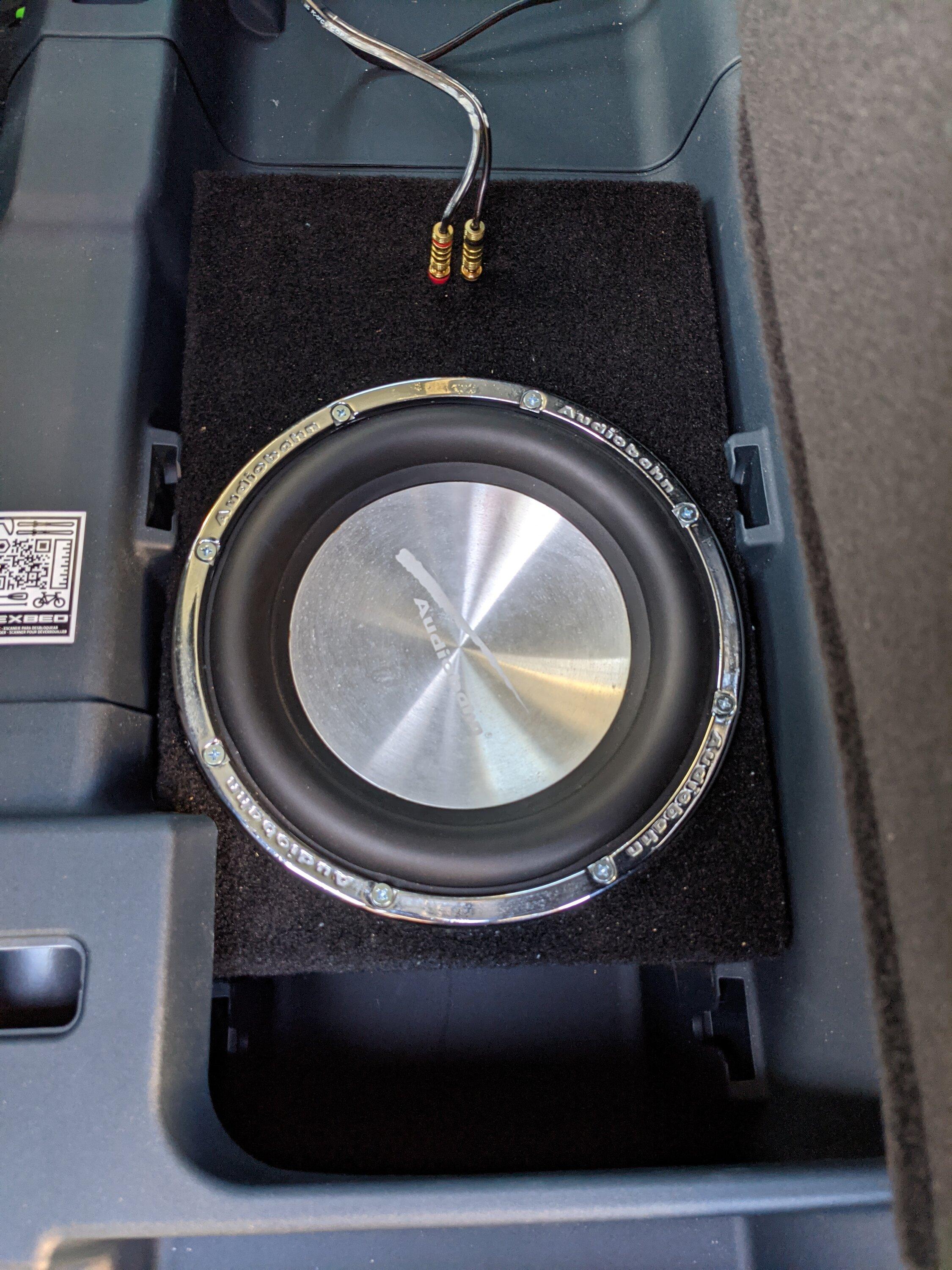

Cleaned up the wiring with fabric tape and mesh loom.
Finally tweaked the DSP using some test tones and an audio analyzer app. The factory speakers aren't that bad once they get some power and tone adjustment. There are definitely some voids in the 600hz and >15khz range that fortunately the DSP is able to address. Obviously, the factory speakers are dead below 100hz, so the subwoofer is an absolute must. Having the DSP also helped flatten out the subwoofer as it was a little peaky in the 80-100hz range due to the smaller enclosure.
Over the summer I may add components because I'm not a fan of having the tweeters bounce of the windshield. That should allow for a better sound stage. For now, I'm satisfied.
