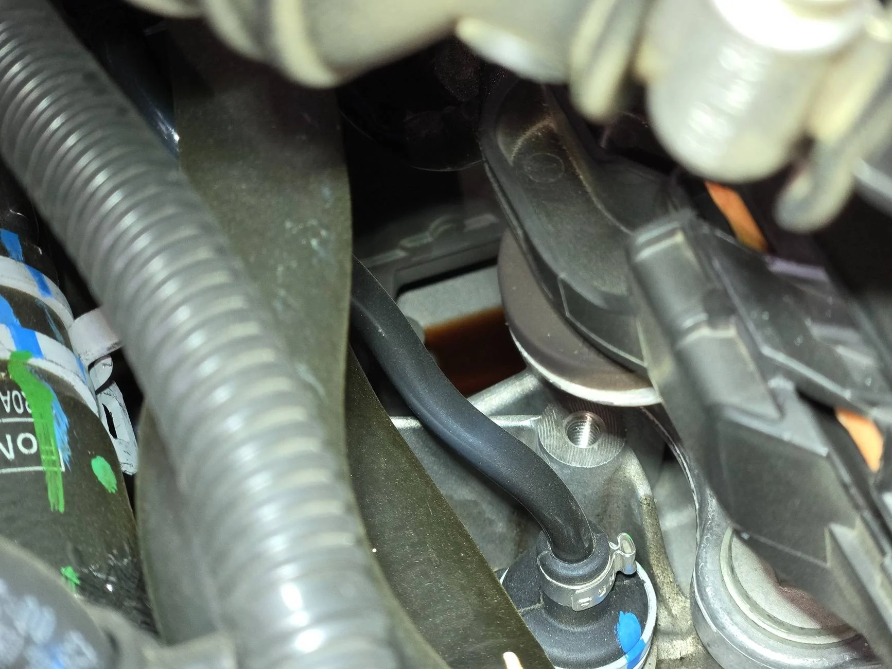

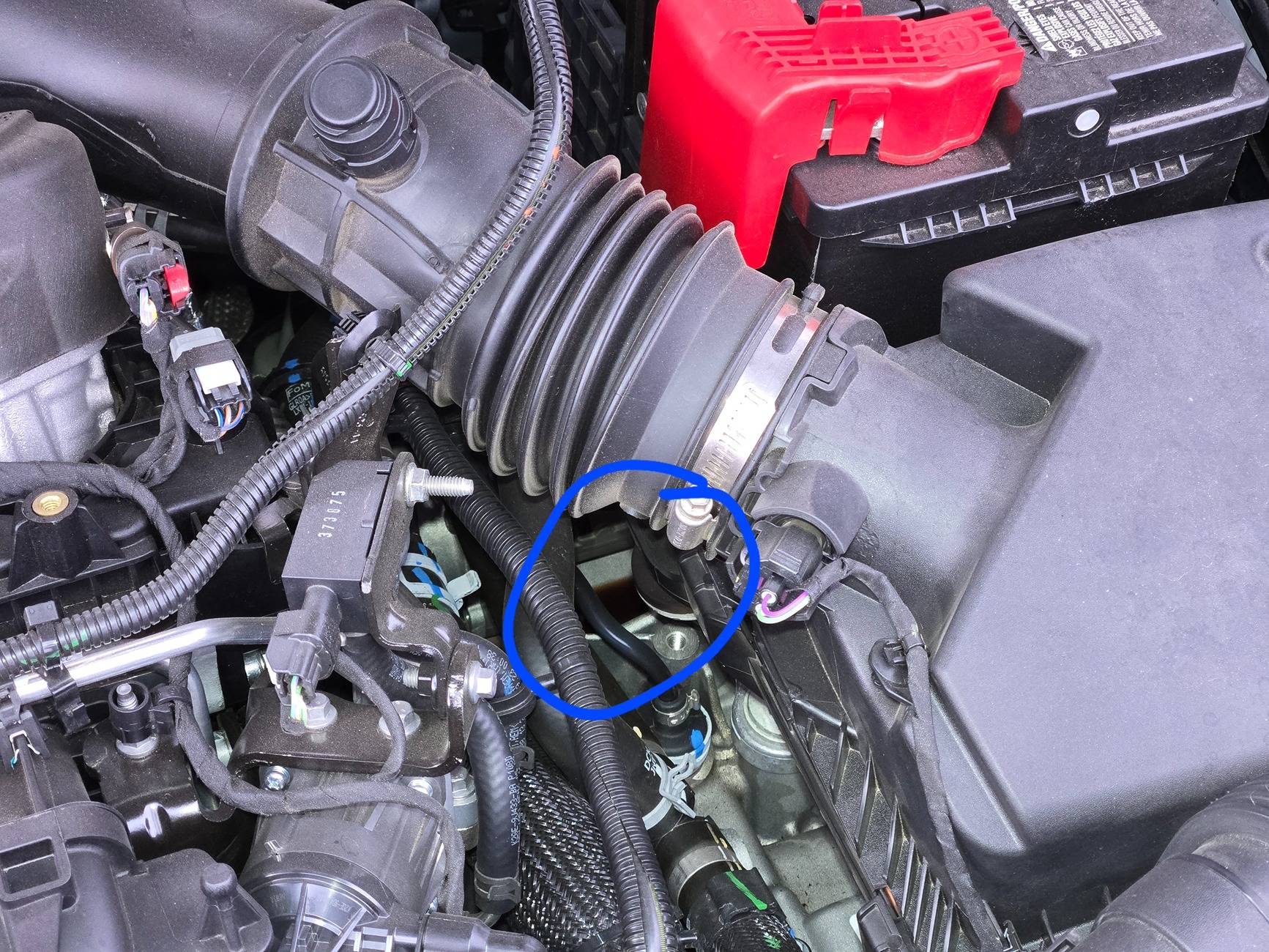

Just encountered this on my 2024 Tremor lariat after a 2.5 hour interstate drive. Coming from under the hood and into the cabin through the air. Didn't start till I stopped at my destination though so it's a bit confusing. Anyone ever come to a answer on this? Was. A pretty dry drive. Only a small bit of water here and there, but there was some dry salt on the road. Just adding my experience as to hopefully add to this issue and see if we can find a solution.
Went out and looked again under the battery for fluid and found a big pool of liquid. Any thoughts?

That looks to me like transmission fluid from the vent on top of the transmission case. Unfortunately there's no dipstick to check the fluid level. That's done via a plug on the side of the transmission case - I think you can see the plug through the drivers side wheelwell. IIRC there's two plugs, the lower of them is the drain and the upper one is the fill, although the drain may very well be on the bottom of the case and not the side. I've slept since the last time I looked under mine 😀
Edit: so much for memory, LOL. The procedure to chech the fluid level is a PITA and requires removal of the underbody skid plate allowing access to the plug on the tranny to check the level.
https://www.mavericktruckclub.com/f...pecs-per-the-service-manual.34319/post-621421
Since it's a 24, I recommend a trip to your dealer to get the issue documented for warranty purposes.

Took it to the shop and they said it was that the transmission was over filled and they drained it a bit and topped it back off. Haven't had time to run it too hard and see if it happens again.
I haven't encountered it again since they fixed my transmission fluid levels. But maybe I just got lucky. Dealership did it for free too for what it's worth.
