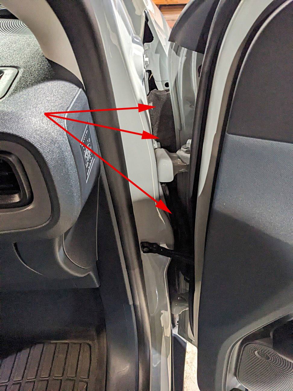

Can you attach a pic of where you put the pipe insulation?

Here's one of the passenger side. There's a couple gaps at the top I missed bc I ran out of insulation.
The pipe insulation I used had a linear slit with self-adhesive strip to attach it with.
Thanks! Will try this out.
