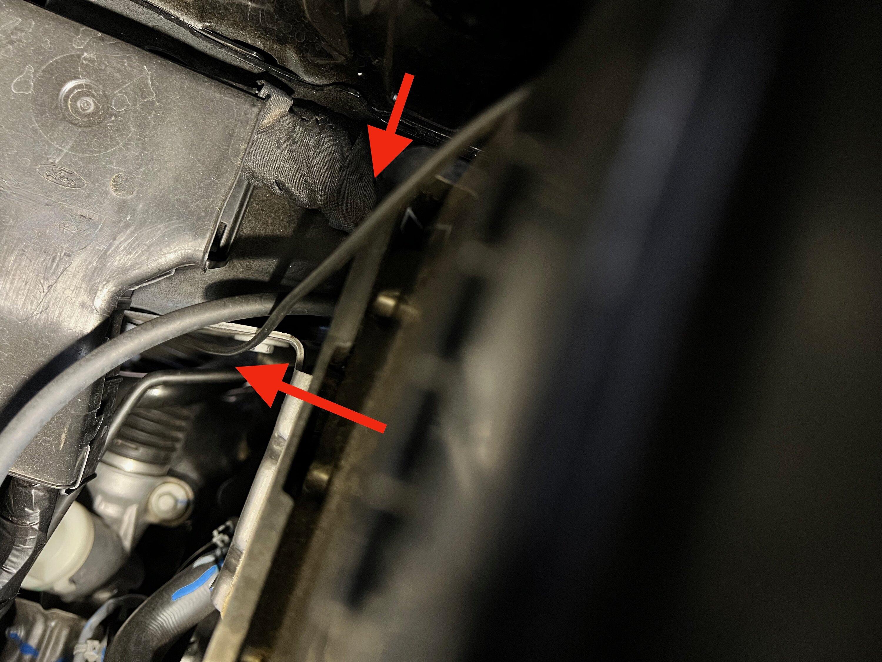

Anyone know what this might be for? It clearly looks like it was an afterthought. It certainly isn't a clean look.
Here's where it starts.
Ford Maverick Wire added on after the fact at the factory? See Pics. IMG_5616
It goes through the firewall here. It looks like someone took a razor blade and cut the grommet.
Ford Maverick Wire added on after the fact at the factory? See Pics. IMG_5617

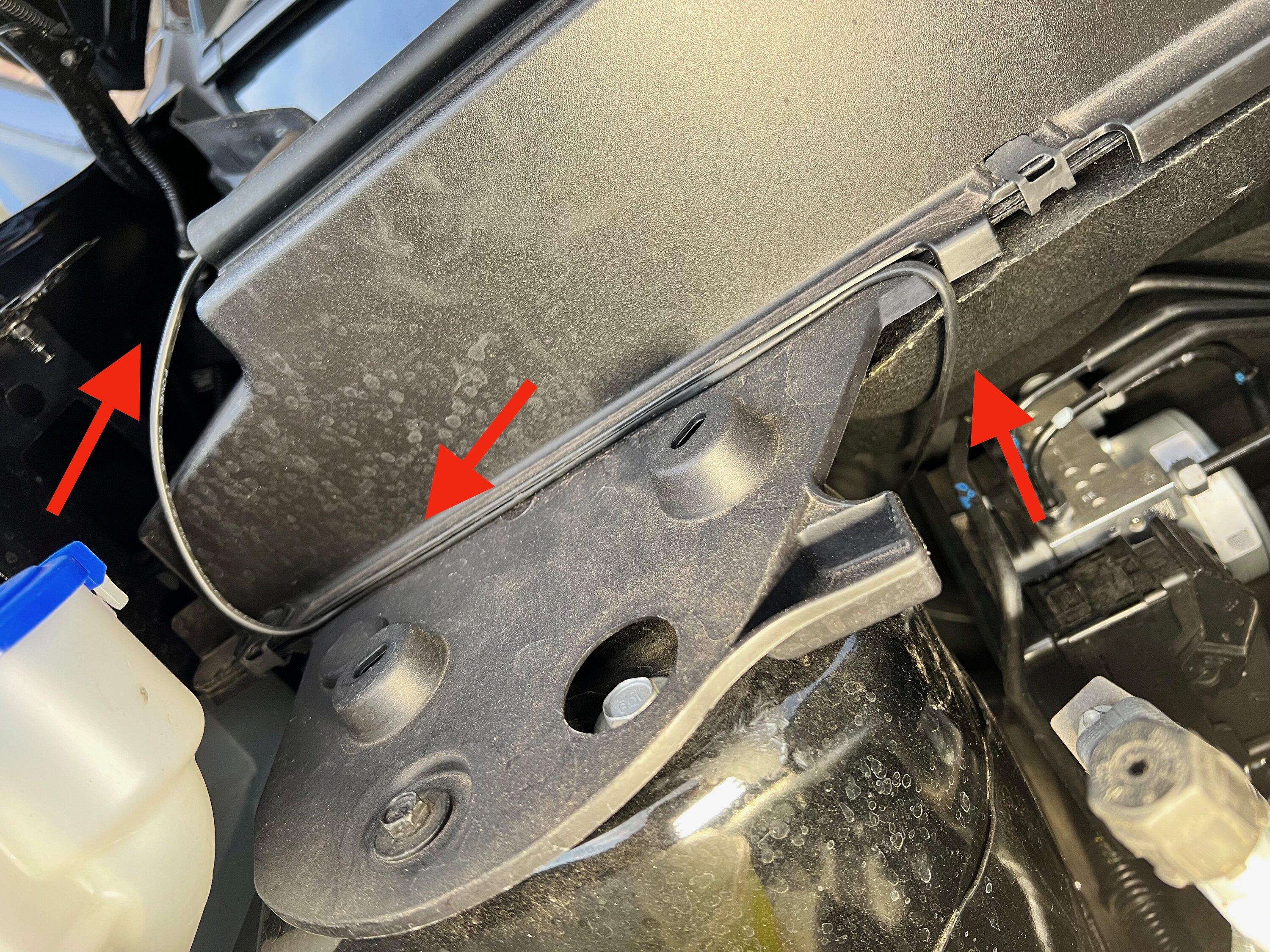

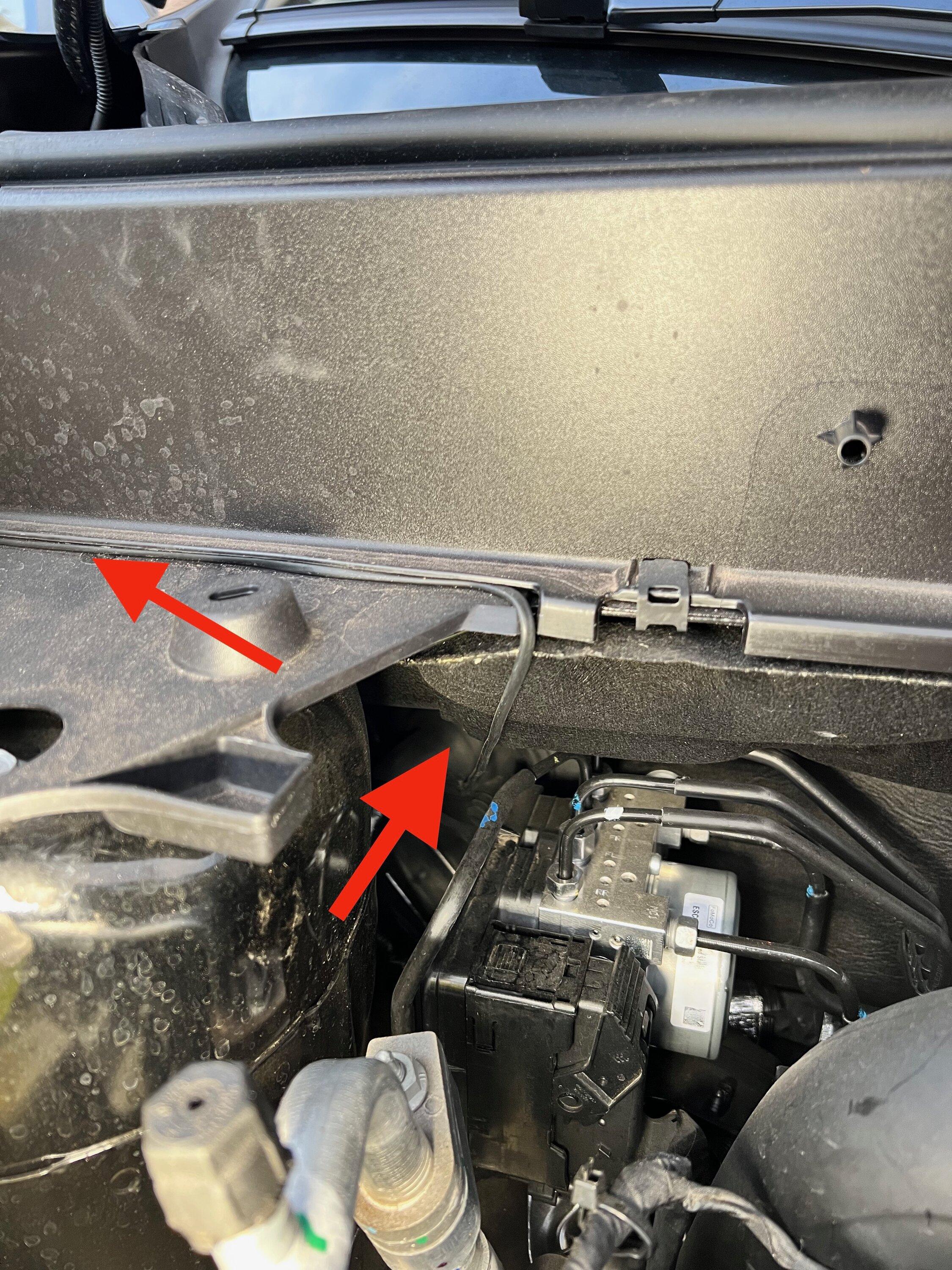

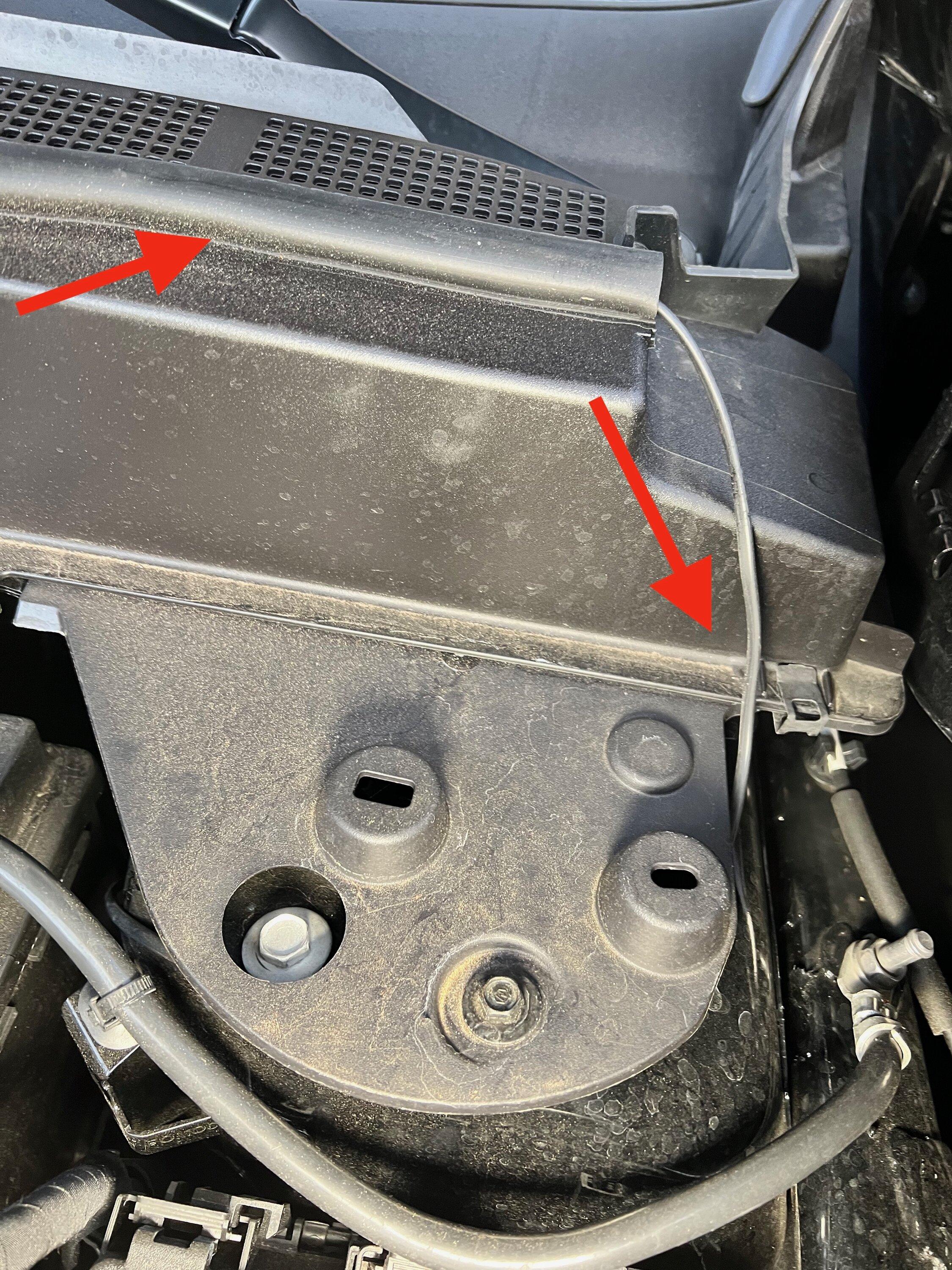

It comes out of the firewall, runs along the tray below the windshield wipers.
Ford Maverick Wire added on after the fact at the factory? See Pics. IMG_5618
Then it goes into the weather strip for the hood.
Ford Maverick Wire added on after the fact at the factory? See Pics. IMG_5619

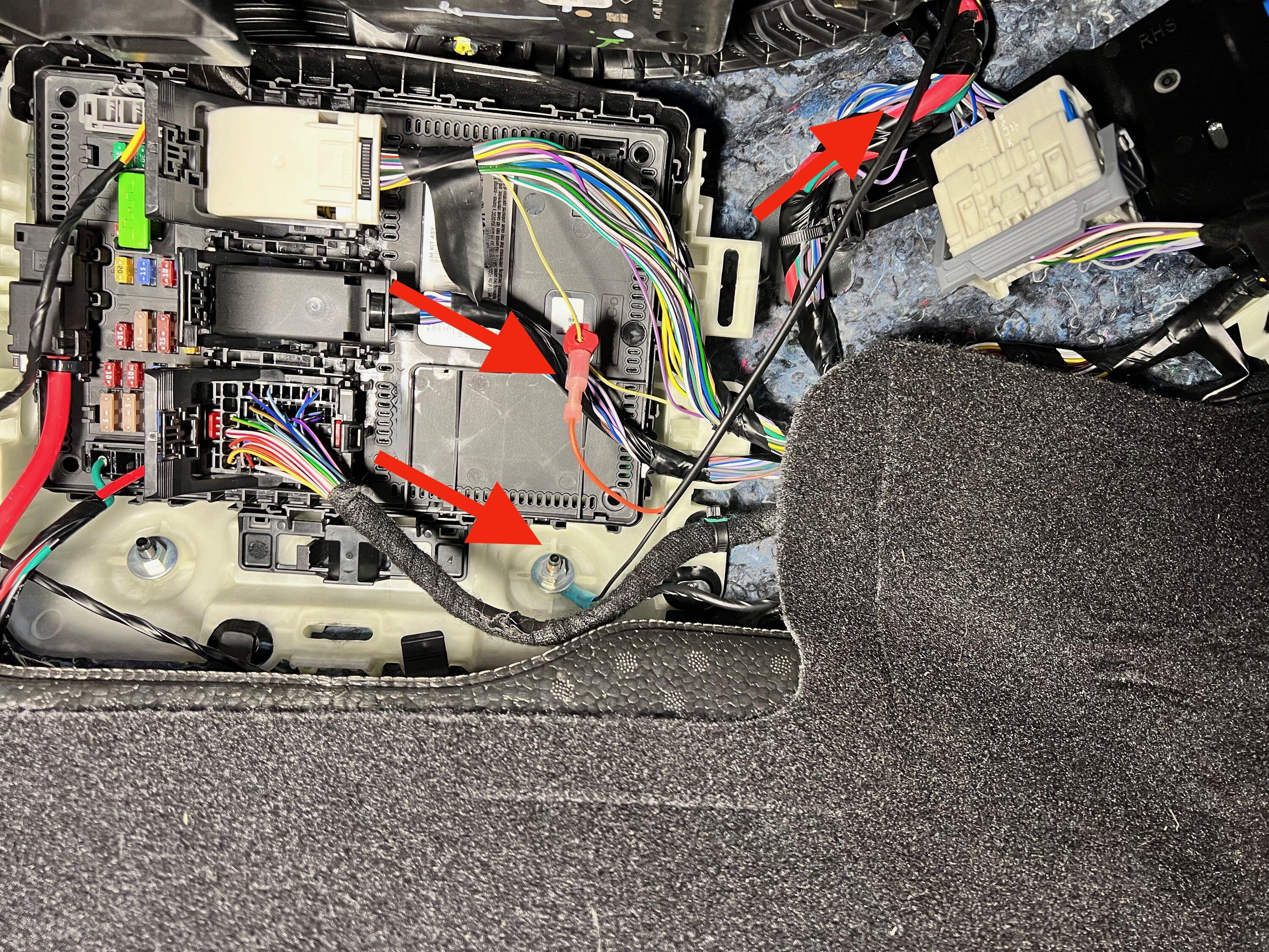

It comes back down the drivers side and goes behind the battery.
Ford Maverick Wire added on after the fact at the factory? See Pics. IMG_5620

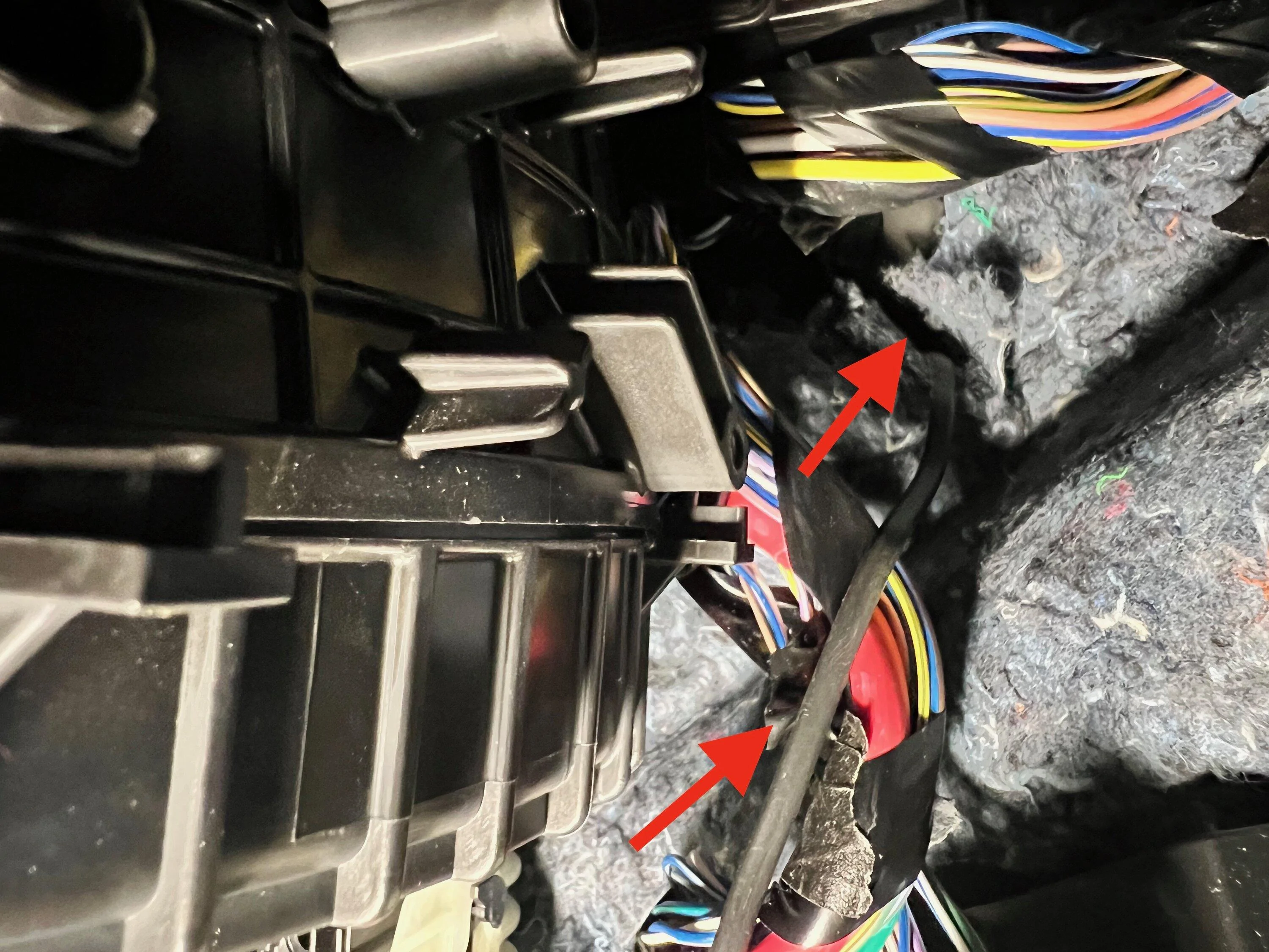

It then goes underneath the floor pan toward the back. I can't see it past about where the drivers seat is at.
Ford Maverick Wire added on after the fact at the factory? See Pics. IMG_5621

Is there a dealer add-on tracking or locating device under the dash close to the OBD2 port or under the steering column?
We’ve seen it before... installed by dealership to protect lienholder

Looks like one of the Yellow / Striped wires off of BCM Connector C2280F
Can't tell from the photo what the tracer color is on the wire that's tapped.
C2280F - BCM
Pin --- Color --- Circuit --- Function
13 --- YE/VT --- CR167 --- FUEL SHUTOFF EVENT NOTIFICATION
38 --- YE/GN --- CPK31 --- SWITCH KEYLESS KEYPAD LINE C ---> Keypad Switch Assembly
57 --- YE/GY --- CLS17 --- CTRL. MOD.---> HIGH MOUNT STOP LIGHT (CHMSL)
59 --- YE/VT --- VDN14--- CTRL. MOD. LIN BUS BCM 6---> Rear Parking Aid Camera
71 --- YE/RD --- SBP18 --- BCM FUSE 18 (7.5A) ---> Wireless Accessory Charging Module
72 --- YE/GN --- CNL09 --- BATTERY SAVER---> Interior Lights, Driver Door Window Control Switch

Delavainia
crippled f150 10r80
Dealer installed topper/cap ??
aftermarket brake light bar ??
BlueSpec1
Gene
Jul 10, 2022
790
815
23 F150 XLT Powerboost, 22 Escape Plug-In, 23 Bolt EUV

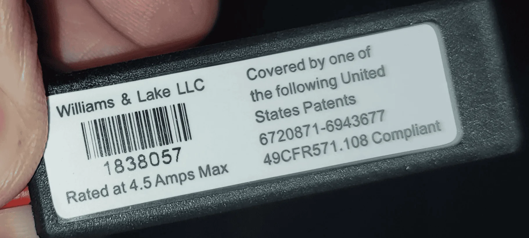

A dealer installed Pulse module?
Don't know why it would be tapped and wires routed like like that as I thought it's output has to be inline with the 3rd brake light.
Edit: Reading thru the patent, this may be installed in paralled w/o cutting the 3rd brake light wire.
Pulse® is available at many dealerships across the nation
https://pulseprotects.com/contact/
This product is protected by either of the following US PATENTS 6,720,871 / 6,943,677
https://patents.google.com/patent/US20160318441
2019 PowerPoint Slide showing dealer profit $100 to $300 added.
https://slideplayer.com/slide/17205535/
http://www.hltsystems.com/Videos/Dealer_presentation.mp4 :ROFLMAO:
Ford Maverick Wire added on after the fact at the factory? See Pics. Pulse 3rd Brake Light Pulser Module Label
