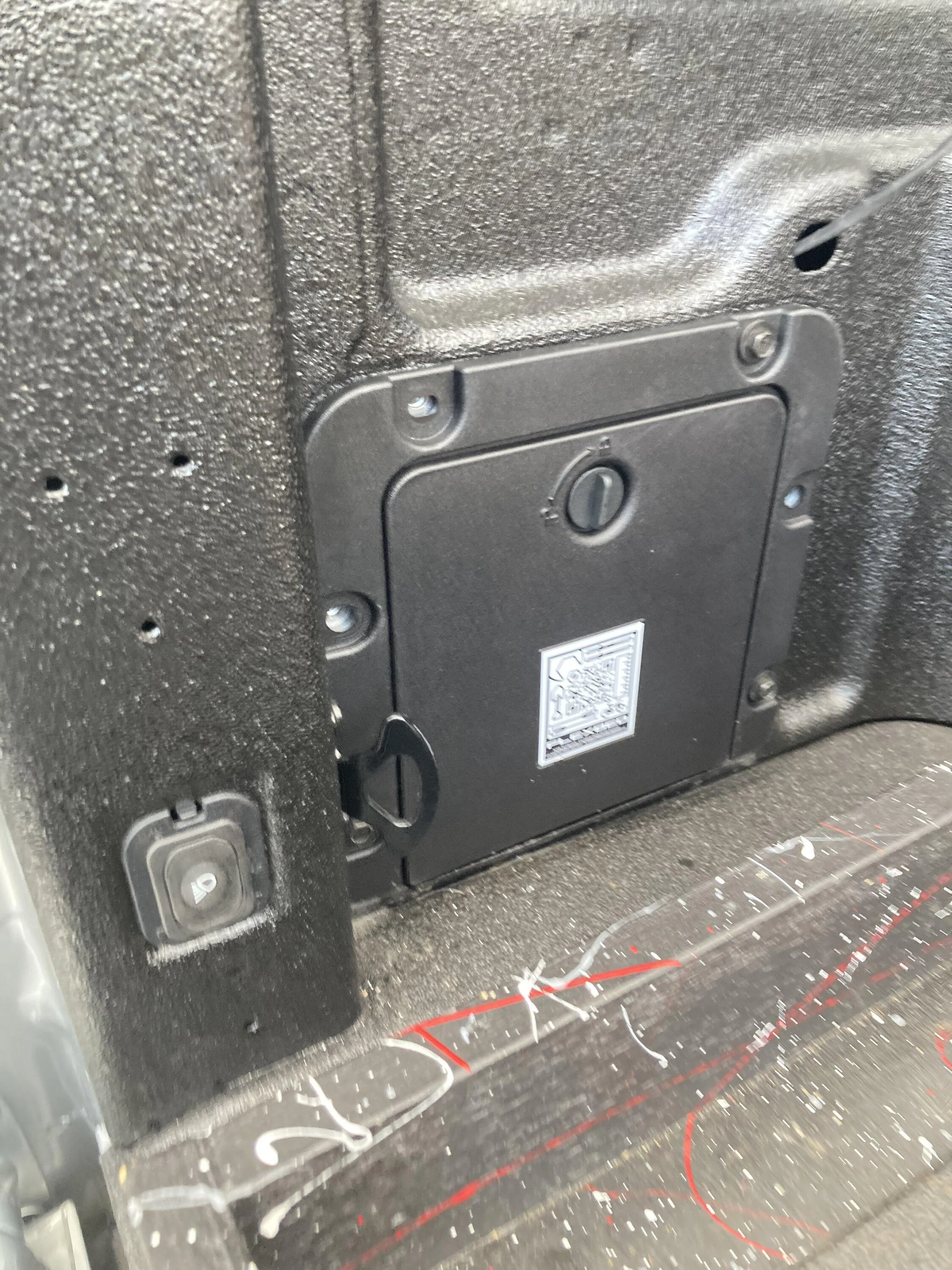

Looking for some help/quick advice: just had a Line-X SIBL done and when I got home I noticed the factory bed light (not cargo) was stuck on (and fluttering) even with the truck off and key out.
I’ve removed the box and clipped in the harness to the light and switch but it’s persisting. Unhooked the light harness for the night and stowed it in the fender.

The light is functional, but dim. The switch and outlet are not. I assume it’s a bad ground or loose connections somewhere. Line-X is going to check it out tomorrow. One thing they did do was spray inside the bed panels where they could, not my request but I’m sure this is actually useful for rust prevention (they didn’t spray the wiring harnesses).

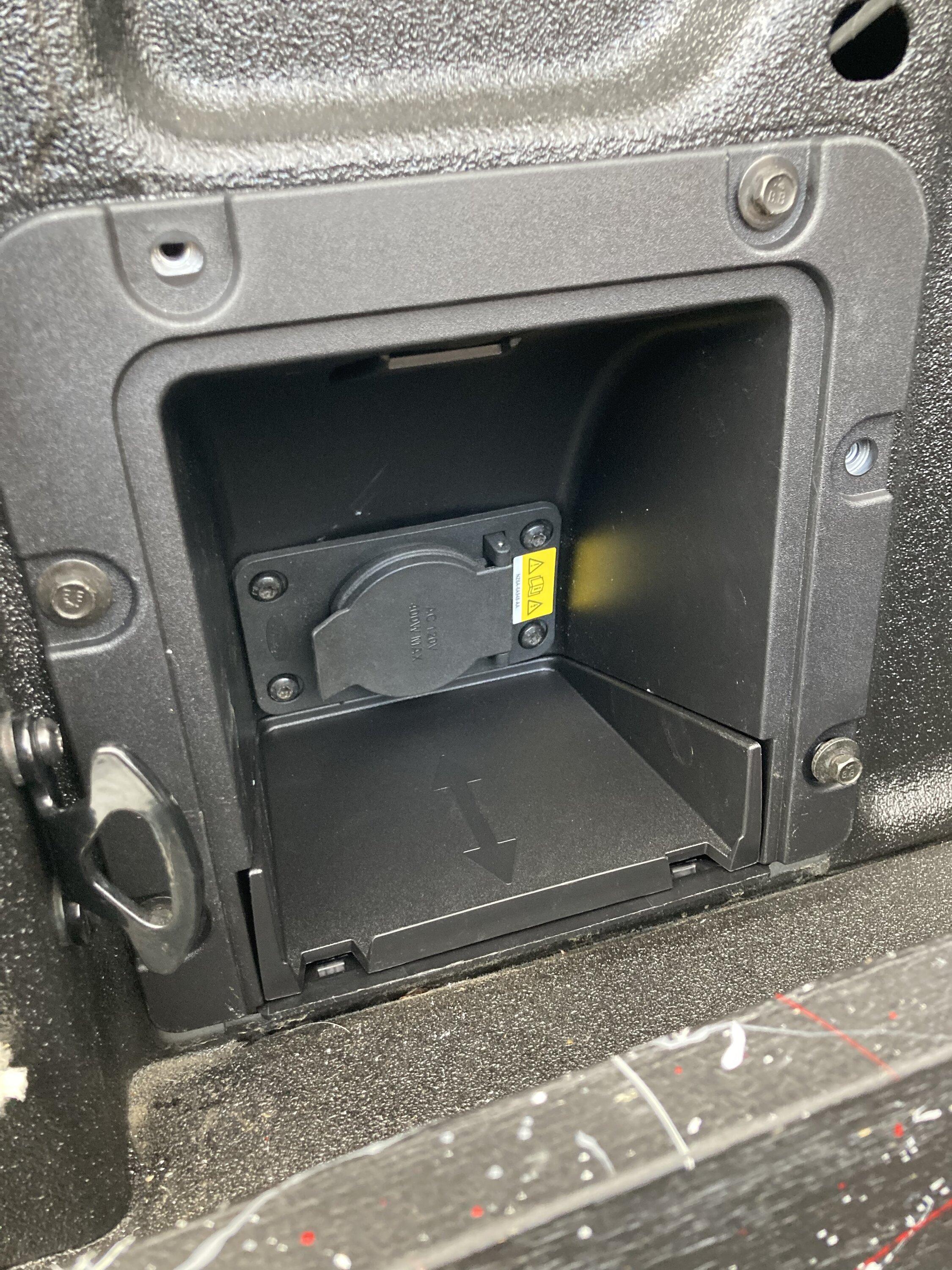

Hoping it’s just a loose connection. I moved my oem switch for the bed light to the little panel that houses the extra 12v power, it barely reaches but I did notice the plugs for the light and switch “lock” when fully in where you have to push a tab to get them apart. My guess is still just a loose connection but If it turns out your bed light is bad, don’t overpay for one from dealership, mine is in a bag under the back seat.

just thought of this, wondering if they unplugged the panel and when they put it back the plugs for the bed light and switch are reversed?

You sir are a prince among men! Not sure how I missed trying this, but this was the problem!

wouldn't go that far........I tell the wife I sometimes have Wiley Coyote "super genius" moments. when I did the outlet move, I made sure to mark what plugs went where so I didn't muck it up. That was my favorite mod so far, swiped the idea from another guy on here.
