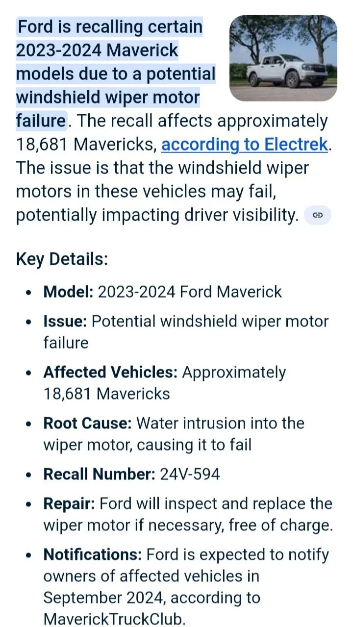

I have enjoyed my 2024 XLT Hybrid and have had zero problems until today.
I was driving in the rain and the windshield wipers just stopped working.
No bad motor sound nothing. Hopefully it's just a fuse, but where, and how Do I get to the fuse box, or should I just take it in to the Ford dealership ? I am under warranty but don't want to have to pay them anything. Has this happened to anyone and what was your remedy ?

Yes I made a appointment to take it in Thursday Morning. They said it was probably the wiper motor.

Warranted . Over hill and through the dale to the dealership you go .

Agree with recall/warranty/dealer visit, but just for a quick check the fuse for the wiper motor is a 30 amp fuse, fuse #75 in the fuse box under the hood.
