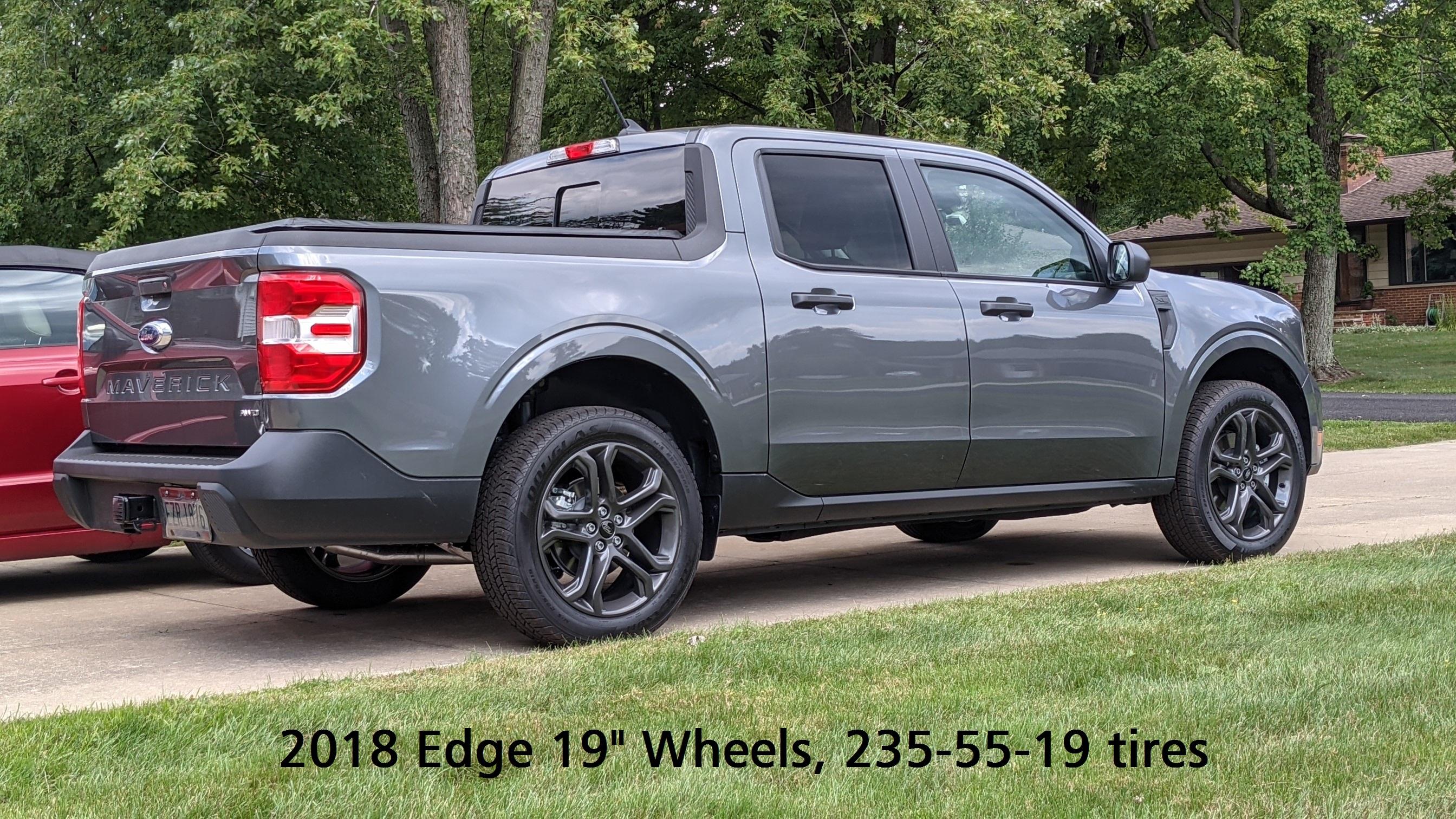

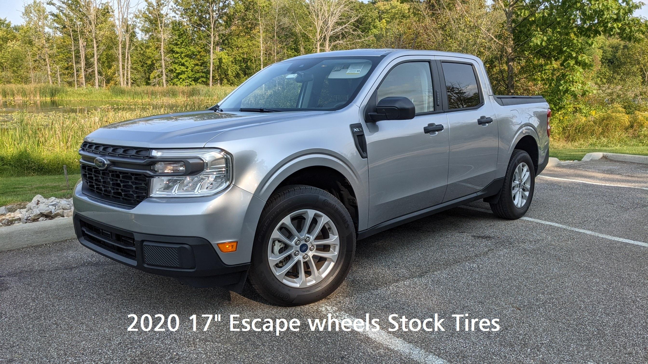

Correct, Fusion, Escape, Edge. Here is pics with 2018 19" Edge wheels (painted GRAY), and another with 2020 17" Escape wheels.
Ford Maverick Which Ford vehicles' takeoff factory OEM wheels work on the Maverick? PXL_20220915_204011810 b
Ford Maverick Which Ford vehicles' takeoff factory OEM wheels work on the Maverick? PXL_20220918_181030403 - Copy
I noticed the offset of the Escape wheels is a little different. Any problems with rubbing?
BensNewMav
Ben
Apr 28, 2023
Maine
2023 EcoBoost
10k miles, no problem at all.

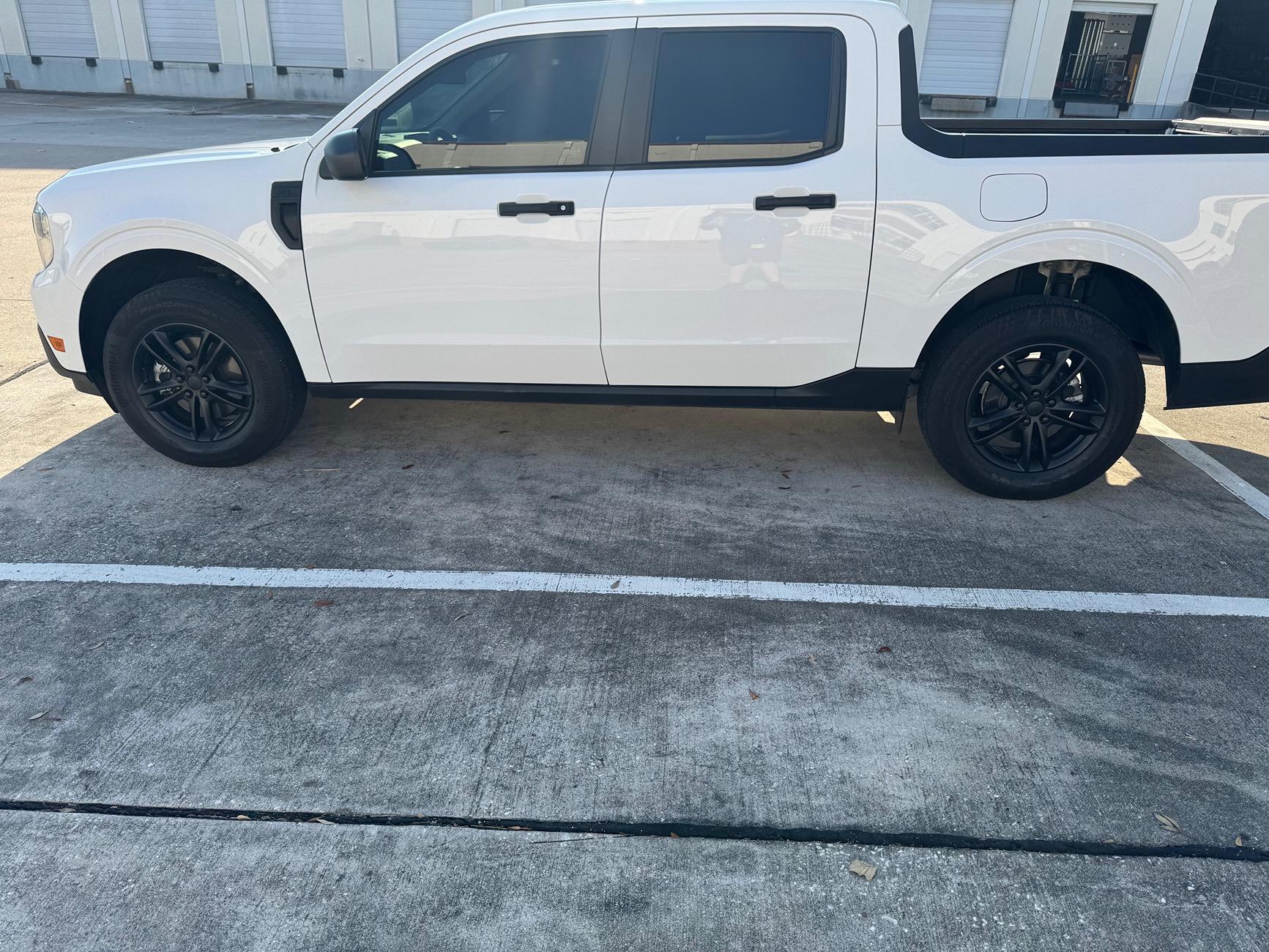

2018 + fusion wheels fit perfectly
Ford Maverick Which Ford vehicles' takeoff factory OEM wheels work on the Maverick? IMG_5212
