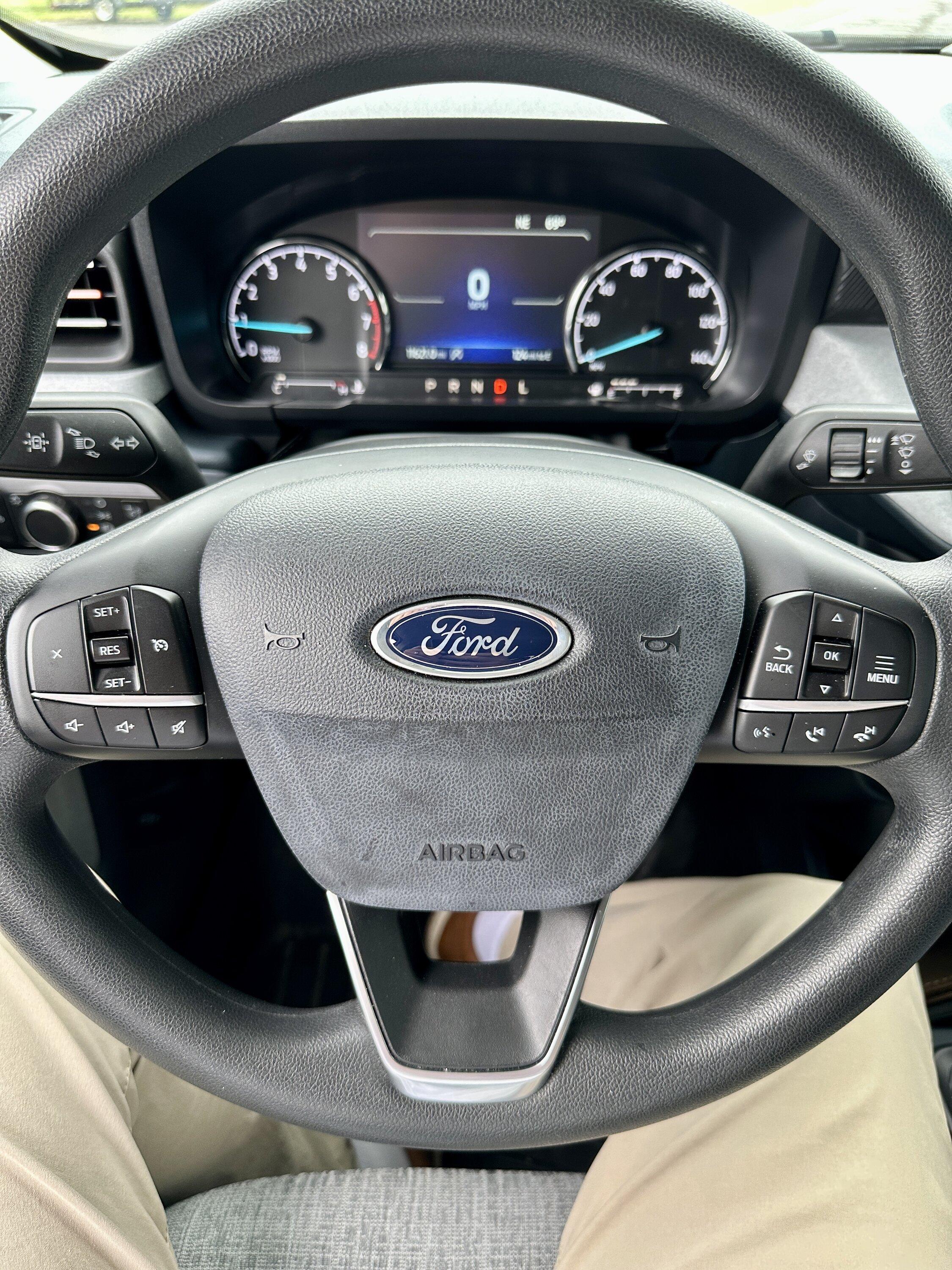

Thank you all for the replies. Some of you have good reading comprehension, others I fear have been failed by our public school education.
As originally stated, the truck is over a year old and it never had anything applied to the steering wheel. Heck, I don’t even touch the airbag cover with my hands. They are on the wheel of the steering wheel in order to steer! I’m going to go with your suggestions that it is a substance created by the manufacturing process that was then affected by heat, light, temperature and humidity. Interestingly this discoloration was on the backside of the cover as well which rules out transfer from my hands or a chemical applied without my knowledge. Furthermore, this supports the manufacturing theory
I also took other’s advice and cleaned it with soap and a damp cloth.
It cleaned right up.
I worked in auto for many years. This is probably vinyl. Vinyl is made with plasticizers to make them soft for auto interiors. These migrate through the vinyl to the surface over time. This is called blooming in the industry and vinyl is well known for it. Ever wonder what that new car smell is?
Without plasticizers your shower curtain would be as stiff as PVC drain pipe. More or less if the manufactuer chooses vinyl this is going to happen.
After vinyl looses it, it becone stiff and more brittle. This is why old cars have cracks in the vinyl.

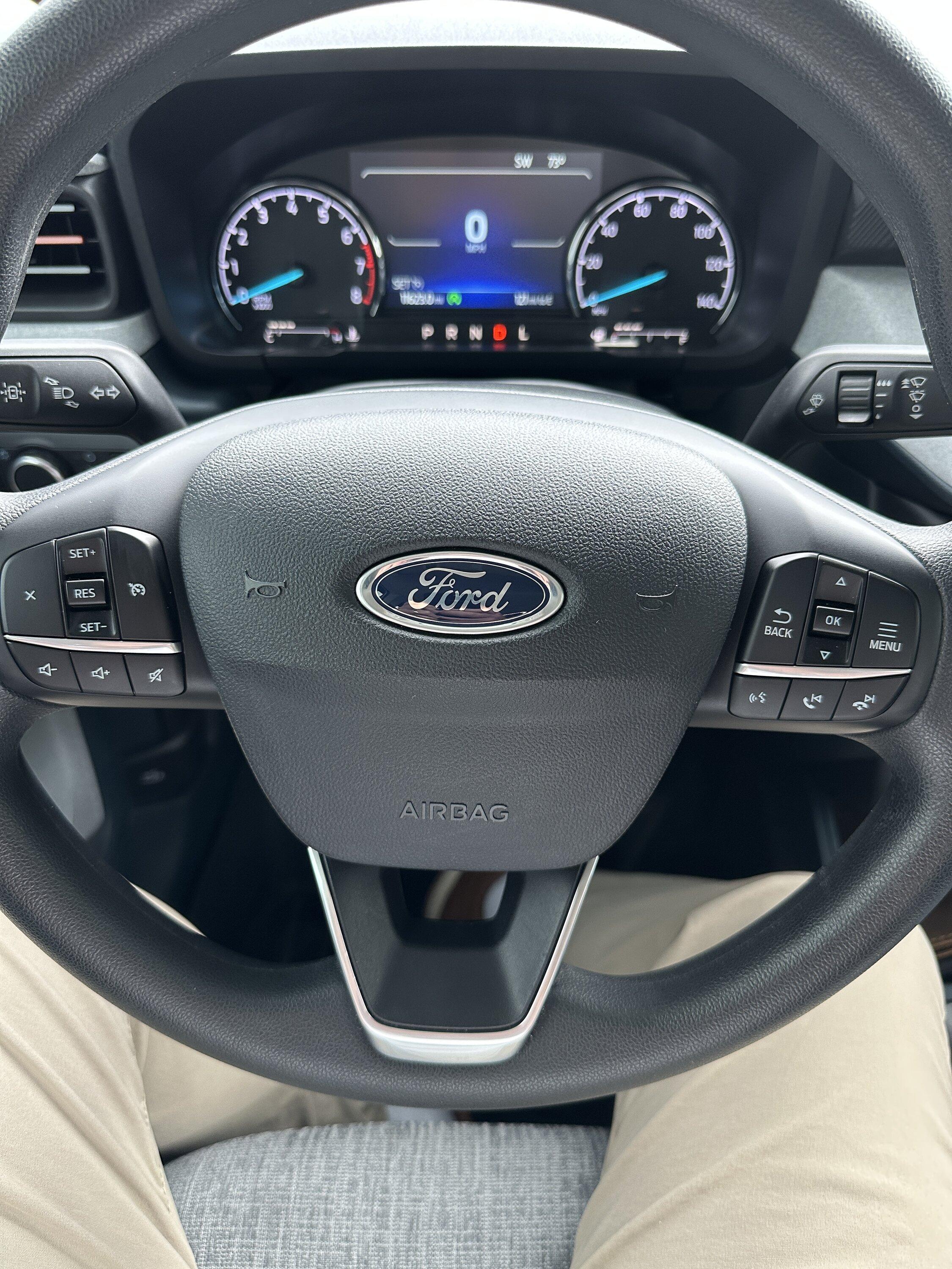

As the title says… “What the heck is this?!”
I got in my truck today and it looks like the plastic on the steering wheel (just the center piece) in my Mav aged 15 years overnight! To be clear, this plastic, like the rest of the interior, looked fantastic yesterday. The truck is a year old and it is (was) pristine. Additionally, before anyone asks or suspects it, I’ve never applied any cleaner, protective treatment, or any other product or chemical to this plastic.
Anyone have any ideas?
It looks like you ride your hands on each side of the horn pad while driving. The plastic reacted to something on your hands. You might also be a center wheel thumb tapper as you go down the road as palm touch around the largest area. The plastic that interiors are made of contain oils. As human skin touches these surfaces, the oils are removed and need to be replenished. Soak the plastic with an interior car care product such as turtle wax interior, exterior protectant. It should look fine after that. However, it may require repeat applications at first and just maintaining after that. It looks very depleted of oils.
Reading comprehension isn’t the failing. It’s disbelief in the situation and what it appears to be. If soap and water took care of the problem, what type of soap did you use? Illuminate us all as to the type so we may all do the same if it occurs. Does the cover just pop off?
