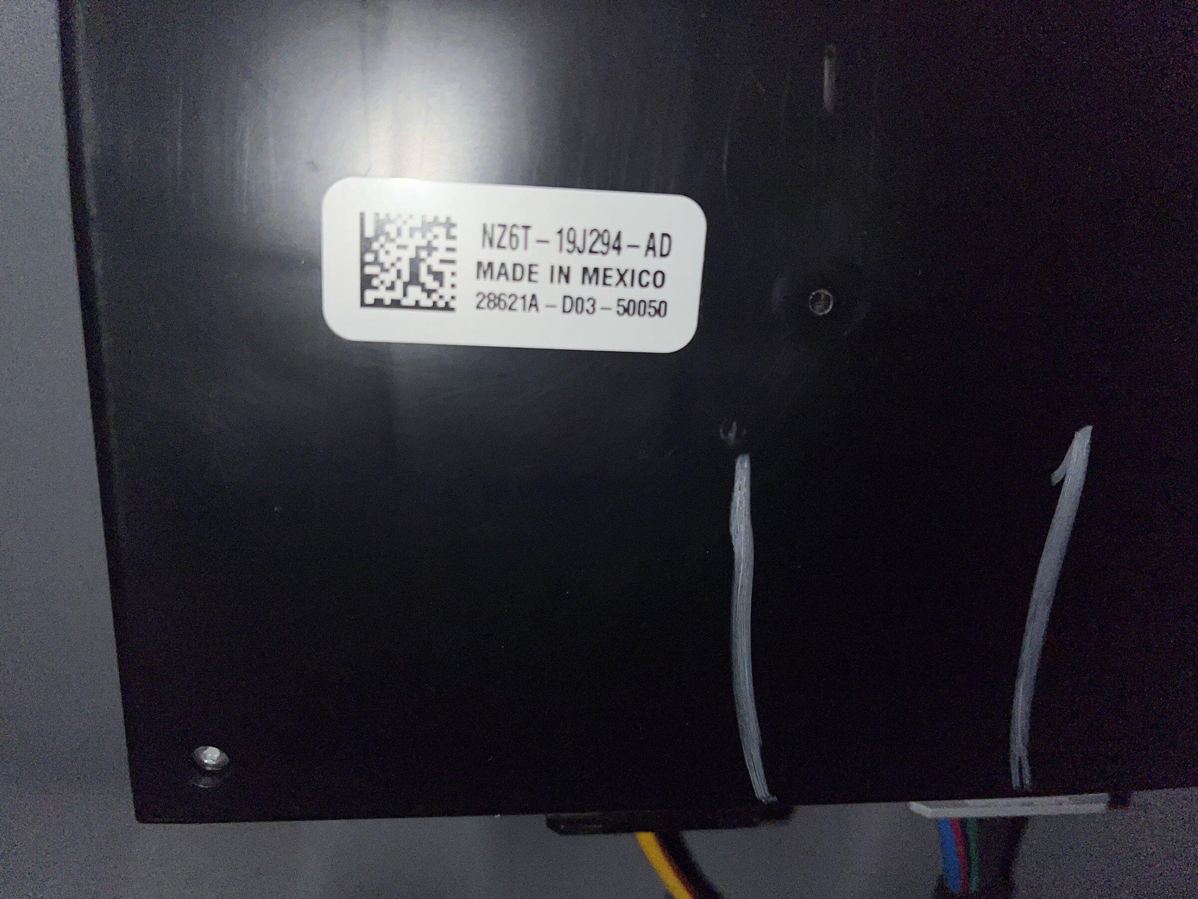

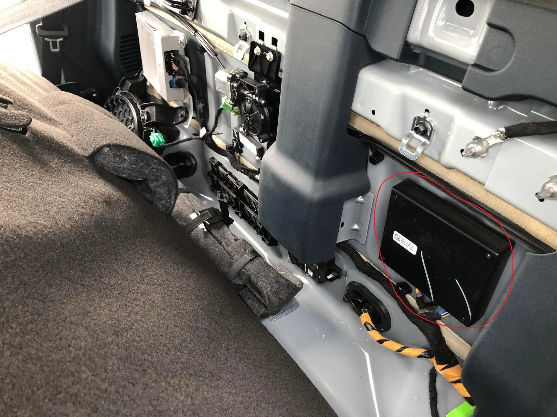

What is this little black box for?

Thank you all for the effort. I think the mystery is finally solved!
I'm still trying to figure out the best way to get access to low-level sound signals in the back.
Let me know if anyone has figured it out.
As an alternative, I would also be OK with the high-level signal.
ffoc01
Jan 9, 2022
134
358
02760
2022 Mav Hyb FE, 2014 Flex
Unfortunately, I don't think you'll be able to get low level inputs from the stock radio, but the speaker wires run right down the C-Pillars on either side for the rear speakers. Look for the twisted Gray/Violet and Brown/Green wires on the Driver's rear and the Green/Violet and Gray for the pass rear.

Still needed if it has a 4pin trailer plug. It controls the trailer lights.
Thanks, so it comes when you get the $100 Trailer Hitch Receiver?
Big_T
T
Jun 10, 2021
51
1,745
3,489
2022 Maverick XL Hybrid
Yes. 4 pin connector comes with trailer hitch option.
