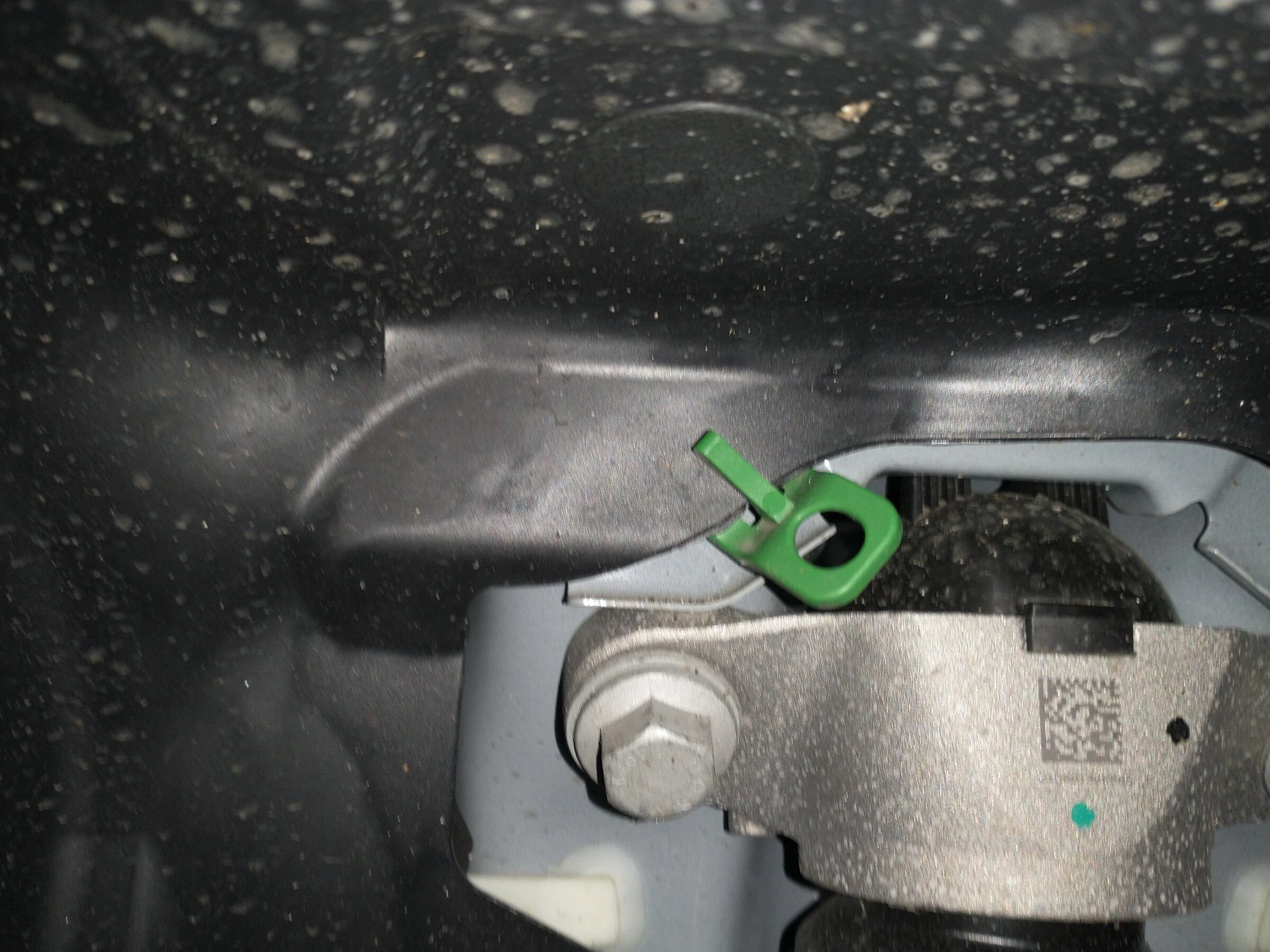

What is this green tab?
Dec 30, 2021
79
Ford Maverick XLT
I looked at an xl in the dealership and it had this too. Salesperson had no idea. What is this for? It's above my left rear tire.
Ford Maverick What is this green tab? IMG_20220118_100618879
Ford Maverick What is this green tab? IMG_20220118_100601183

I wonder if that is something from production to allow access without battery power that is intended to be removed. The owner's manual doesn't mention it, only the levering tool included in the jack kit to pry the hybrid fuel door open.

Sure enough you are right. I pulled on it and the fuel door opened. Thanks for helping me not go crazy.
It's like the Pull inside your trunk so you can't get accidentally locked in your trunk. Same way that you can always get gas no matter what
