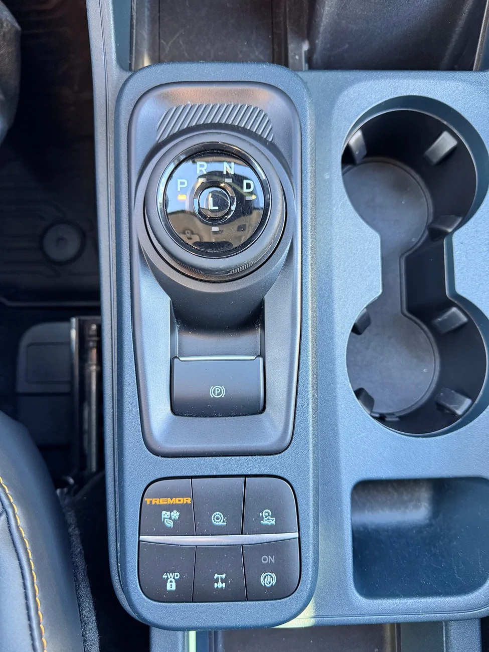

On my '24 Lariat Tremor, I found using the L button pretty much locked the trans in 3rd gear, as indicated on my ScanGauge3.

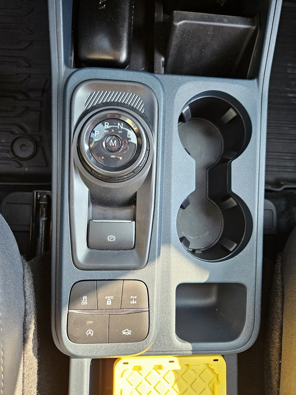

Still learning on our 2026 Tremor but it has changed far as modes. No L, rather the button in the shift dial is M for manual shifting with the paddle shifters. Sport mode will hold a gear till a higher RPM range before shifting up along with increasing the throttle tip in.

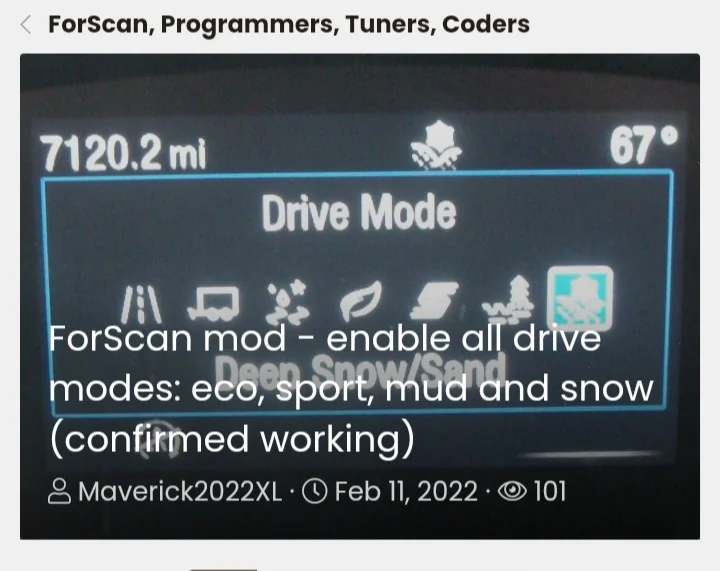

You can add Sport Mode to your 2024 via FORScan.
Maybe we'll get a reply🙏
It's in that other thread for adding sport mode...super easy. Just need to use easy mode and enable the drive modes that show as disabled.

I use the button marked M often, handy during the break-in. Have not noticed anyone collapsing and going stiff so far!

I just did my XL4 Lariat for Eco and Sport modes. I didn't but could've enabled Rock/Crawl and Baja too. Don't need a bunch of choices for city driving. If I go off roading I may enable those last 2 as well.
