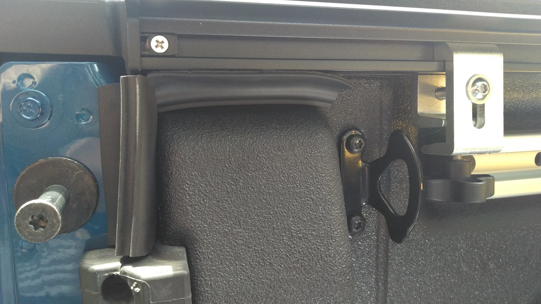

how do you move it? I tried it seems to be 'set in place'? thank you
Move what? I just placed the rubber seal on the side like mcc10403 is pointing to in the picture. Not sure what you are referencing.

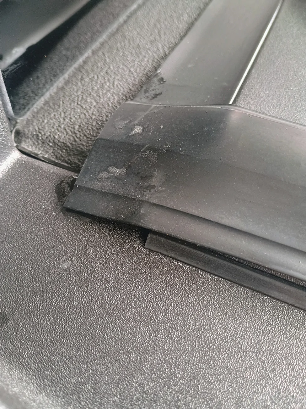

I don’t have a part number for the neoprene weatherstrip, but it needs to stick out 3/8”-1/2” from the adhesive. You can find it in rolls at big box and a quick search at retailers.

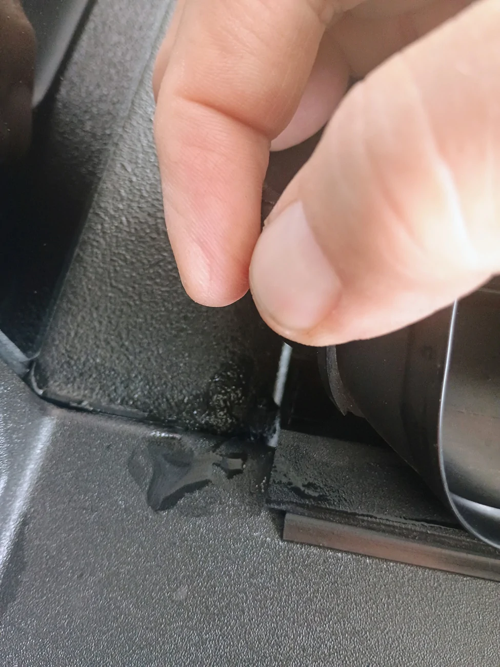

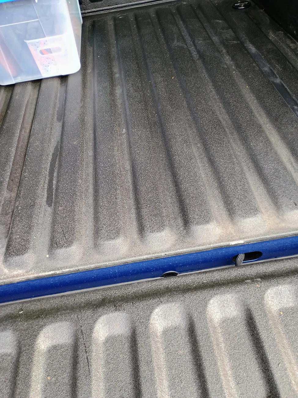

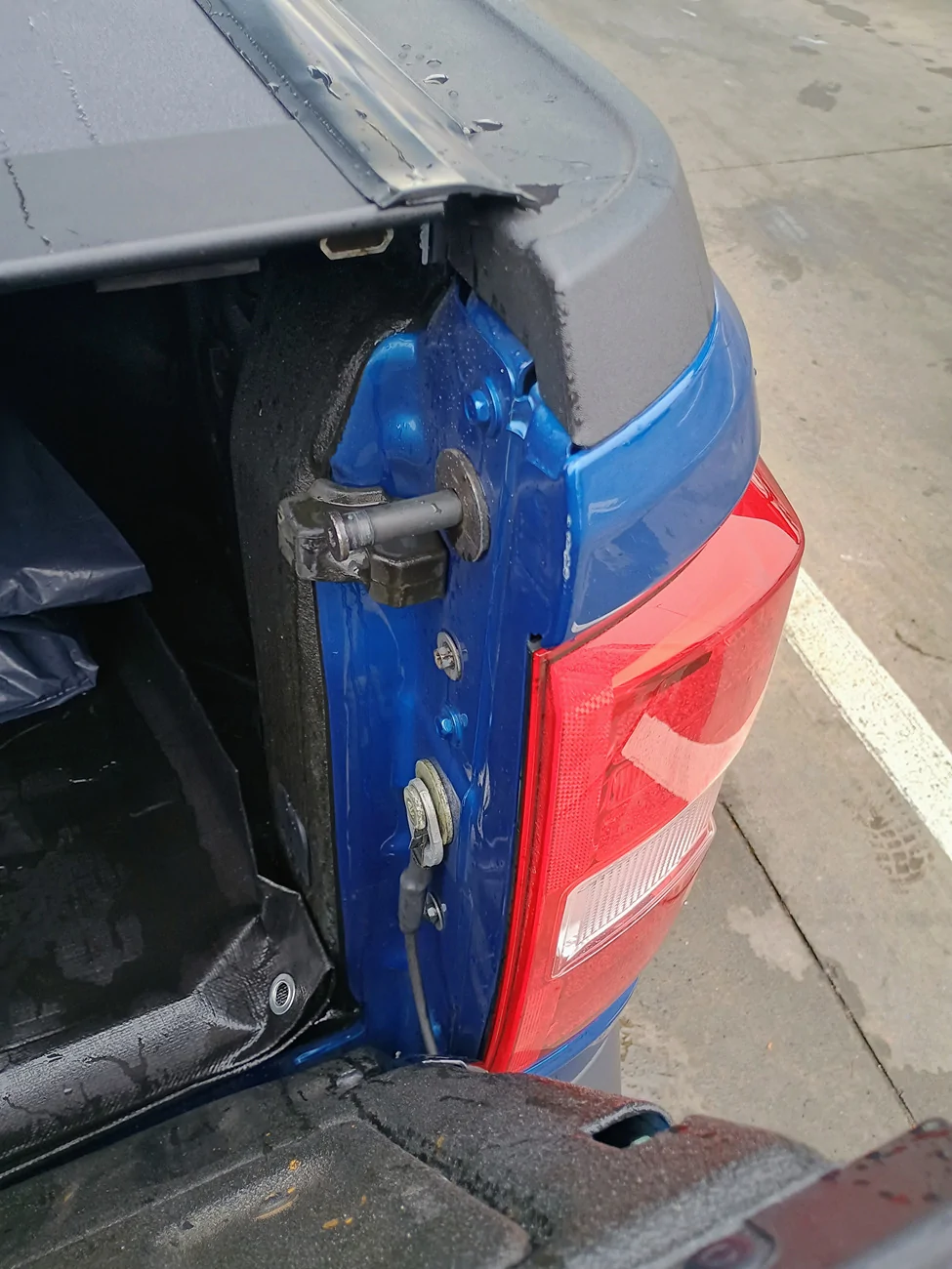

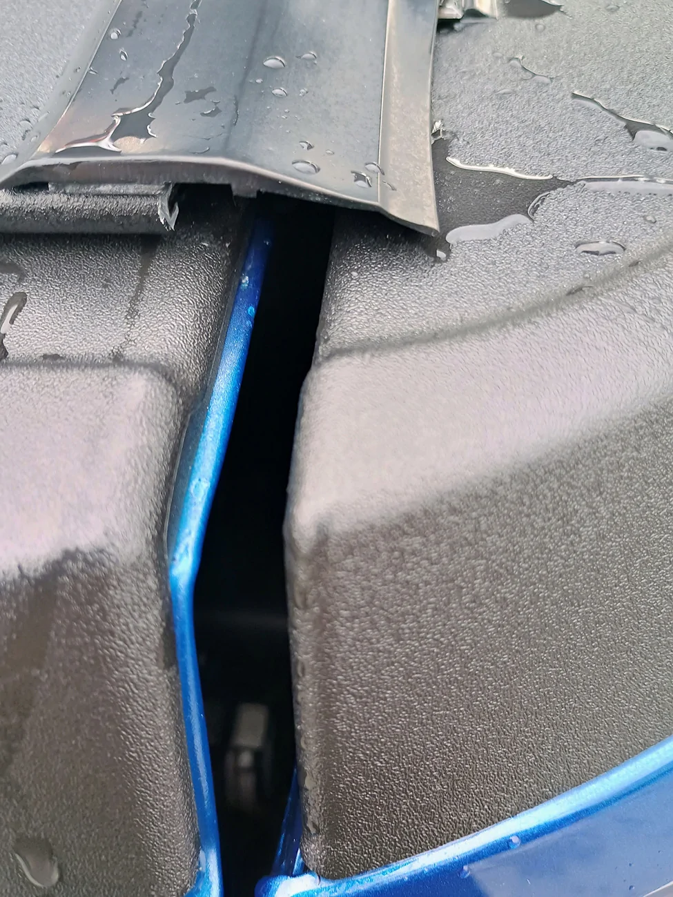

pictures: I think a large amount of water is getting in where the lift meets the truck
If so what can I do to plug the dike? thank you

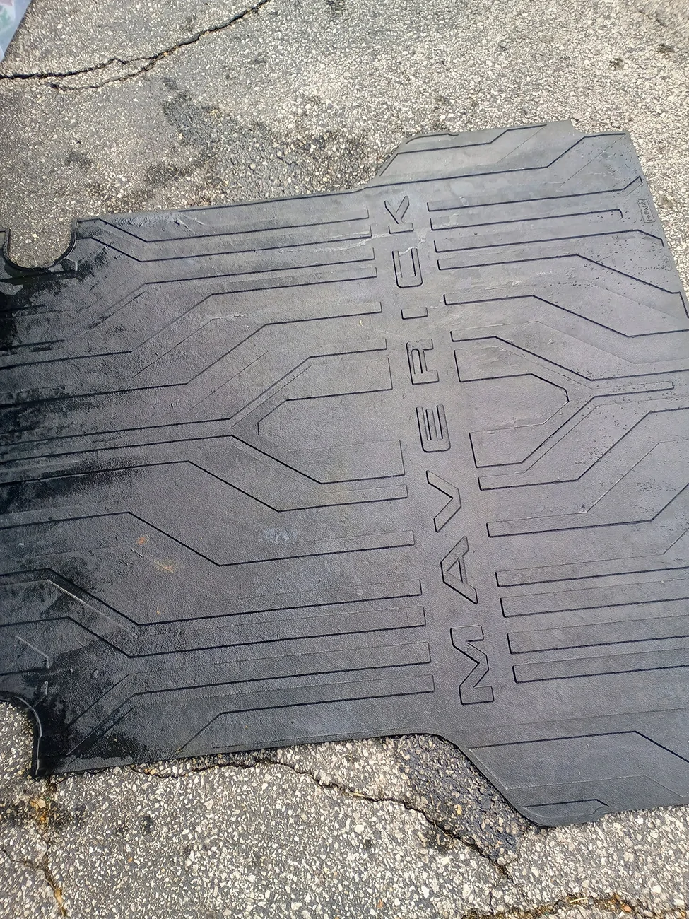

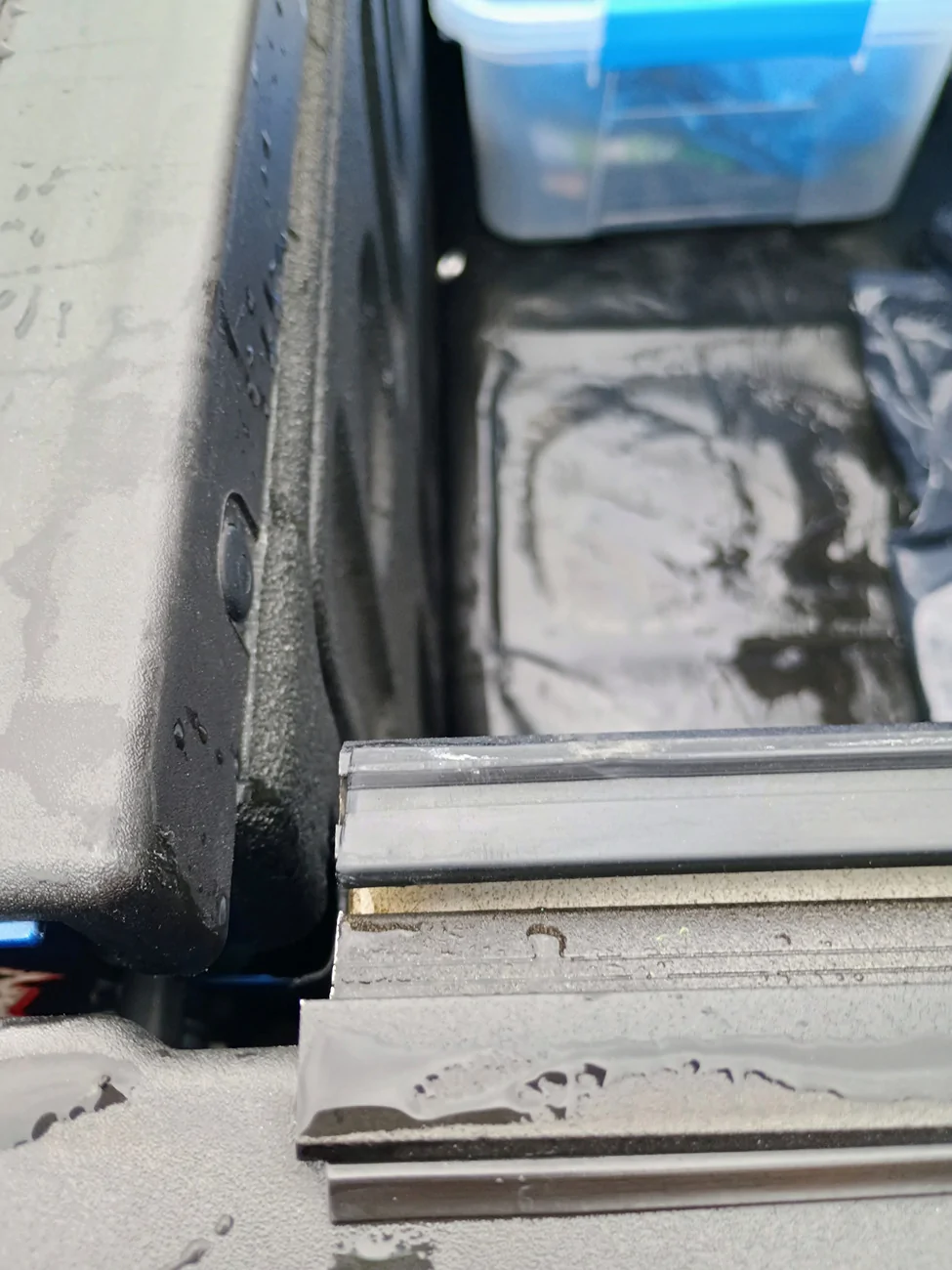

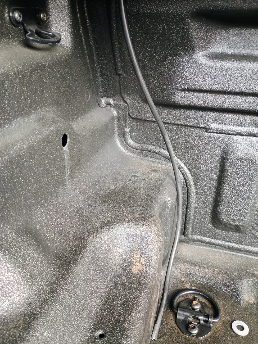

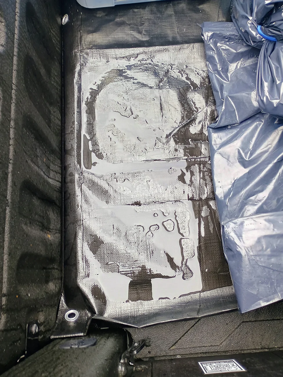

here is the update: I took everything out of the bed and low and behold one of the drainage tubes was dislodged. I reinserted it. I also took out the flat rubber Maverick flooring so I have the ribbed bottom left. I ran it thru the car wash and the amount of water was less BUT I suspect the two pics up at the cab show where the water is coming in. I now have to figure out the best way to 'plug' that water entry Thank you for reading and looking.

Get a friend and go to the (many) quarter car wash (or use a pressure washer if you have one), climb in the bed with a flashlight, and see where the leaks are coming from. Honestly, IMO, it's almost impossible to keep it water tight.
When I get home from the car wash, I just open the last section and let it air dry.
