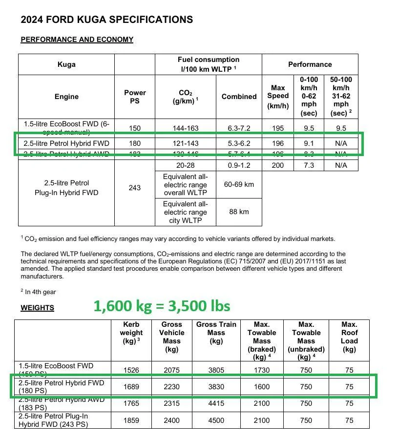

Yah the HF45 in Euro Kugas gets a 3500lb-ish rating depending on trim and that's pretty much speed limited when towing in Europe, plus they don't have heat and so many gruelling long climbs. So sticking to the double nickel probably gets you a lot more towing without instant transmission problems. Provided of course you've got braked trailer and braked controller.
I saw the quote the other day that Ford engineers "Weren't quite comfortable" validating 4000lb on the HF45, and that would I guess be for all North American conditions (heat) and long climbs, and high speeds, 60 or more. So they built the HF55 with some improvements. So if you apply some limitations and common sense to your towing, you can get the other side of "quite".
Edit: forgot to mention that some of the problem is "too much" regen with more momentum with heavy loads, so you'd be best off using a drive mode with little regen and setting your brake controller "tweaky" so the trailer is braking when you're braking in regen.
So I had to look into this, it appears as though you're correct.
