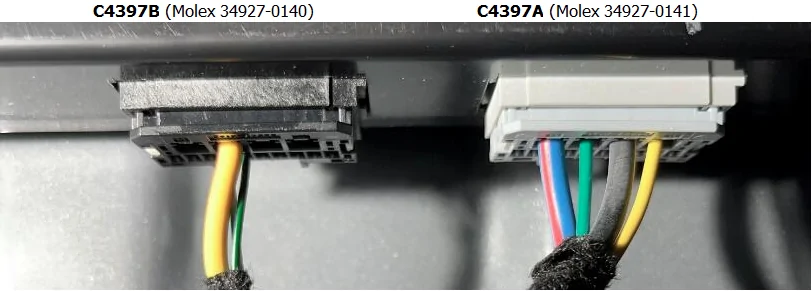

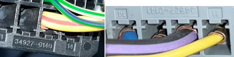

C4397B. (Black)

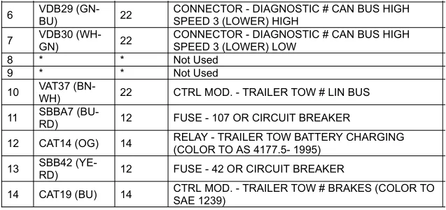

My 23 XLT TRM is missing:
Brakes(14), Battery Charge(12), Trailer Tow Battery Charge(11), TBC LIN(10) wiring.
Ford Maverick Utility trailer recommendations for 23 FWD Hybrid 1760823666264-fn
C4397A. (Gray)
Pins 1-10 Not Used
Ford Maverick Utility trailer recommendations for 23 FWD Hybrid 1749507124787-o9
2023 2.5L TRM in my truck:
Ford Maverick Utility trailer recommendations for 23 FWD Hybrid 1760823480120-ao
Ford Maverick Utility trailer recommendations for 23 FWD Hybrid 1760823509346-hz

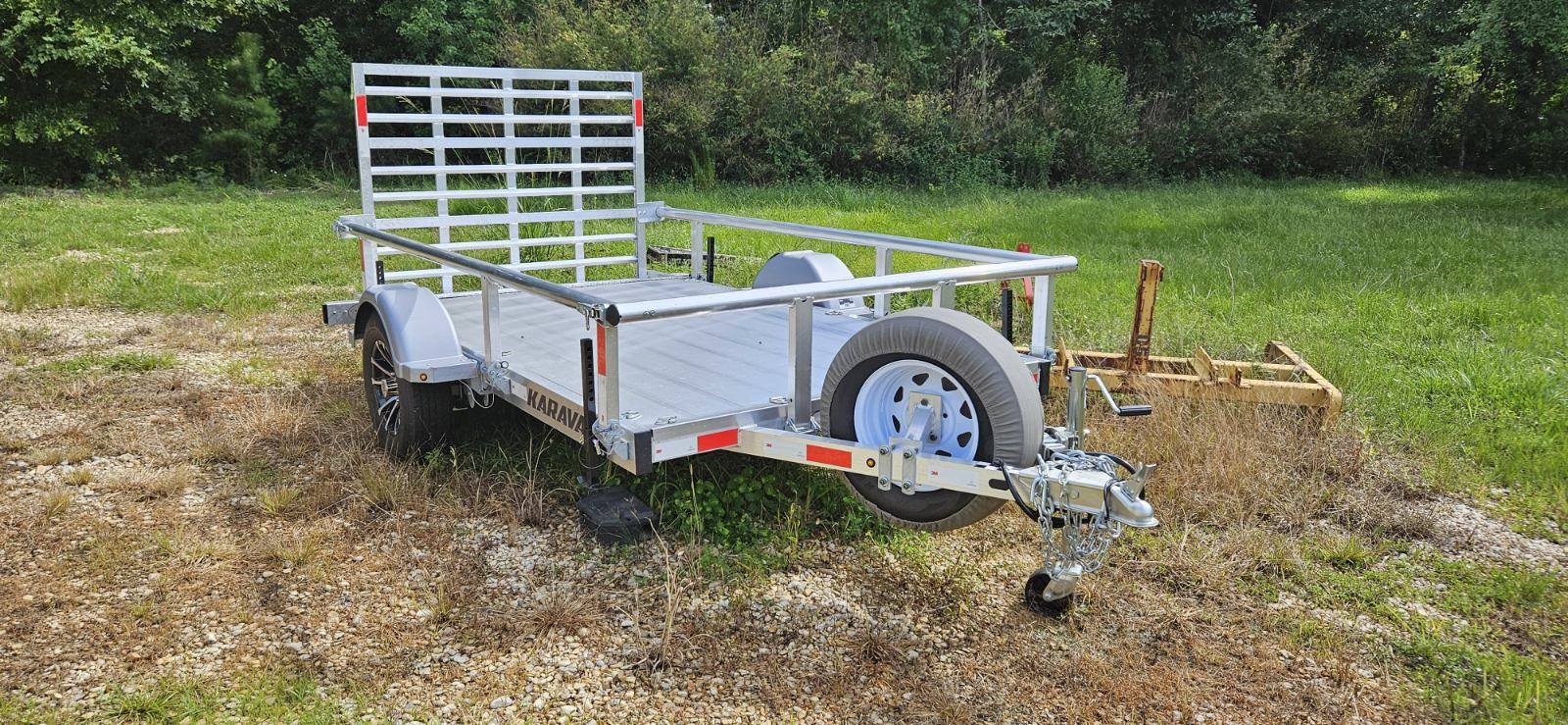

Very easy to move around! As bought, the trailer weighs about 500-550# very light on the tonque and your hands! After I added the spare tire carrier and spare to the front (Alum mount) it was a little tongue heavy for my 70 YO body to move BUT I have a trailer dolly that enables me to move it anywhere I want, Concrete, gravel or lawn. I put larger diameter no-flat wheels on the dolly in place of the normal 2 wheel dolly type. I don't do lawn parking here because even after a light rain the ground is too soft. Factory tie downs are more than adequate but with my 2370# Kubota SxS I added some more. They have a hole already in place about mid-way down each side thru the 2 x 5" beam with a rubber cover over it. I just used those holes for 2 more HD tie-downs. I also added some across the front and the rear dove-tail for ease of strapping down and some small clips for attaching bungees and tarps while parked. I have been extremely satisfied with the build quality of the trailer. If you look on Home Depot website the same trailer is higher priced thru them. But don't try to contact the Karavan trailer factory, if you can find a number or email (not on their website) they don't answer. But that's ok it comes with everything you may need. (Except spare tire!) I love the fold-down sides as my Kubota SxS only leaves about 2 inches on each side. So I drop the sides, Back the Kubota on (Tail end is heavier) and I can maneuver on and off until I get it perfect, And I can get out the door of the enclosed cab!! Then I just raise and lock down the sides, Very good corner locks also. If you want any specific pictures just ask. Also even though the website and the tag on the trailer say it is a 2770# axle, when I was climbing around underneath, I saw a tag on the axle that identified it as a 3500# axle!!!! Standard add-on brake kits will fit. But you need to use the original outer bearings, it's a slightly different axle shaft diameter at that point. You won't be disappointed with the trailer. My son said don't EVER sell it, I told him yea you will inherit it some day. It's quite at home just sitting out without any cover especially with that aluminum deck! I didn't care for the factory coiled cable safety hook-ups, that were too short to reach my other truck, so I added nice HD safety chains. Boy is this a long post! Oh yes, ALL Frame underneath is also aluminum, no steel hiding under there.

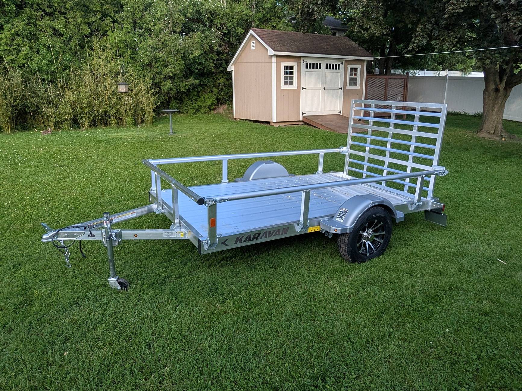

Picked up the trailer from tractor supply, glad some reviews mentioned that there was a wood block above the axle that tractor supply forgets to remove, I picked it up and saw they forgot about it before I left, they also proceeded to hookup safety chains wrong. Pulls nice and straight but pretty bouncy when empty which isn't too surprising. Happy to confirm I can easily wheel it around my yard when empty, wouldn't be able to with steel. I am curious if you know how to remove the cap to lube the wheel bearing? I see where you can pry with a screwdriver but when I started lightly prying I could hear cracking. Manual and YouTube show a different design
Thanks again, so far very happy with the purchase.

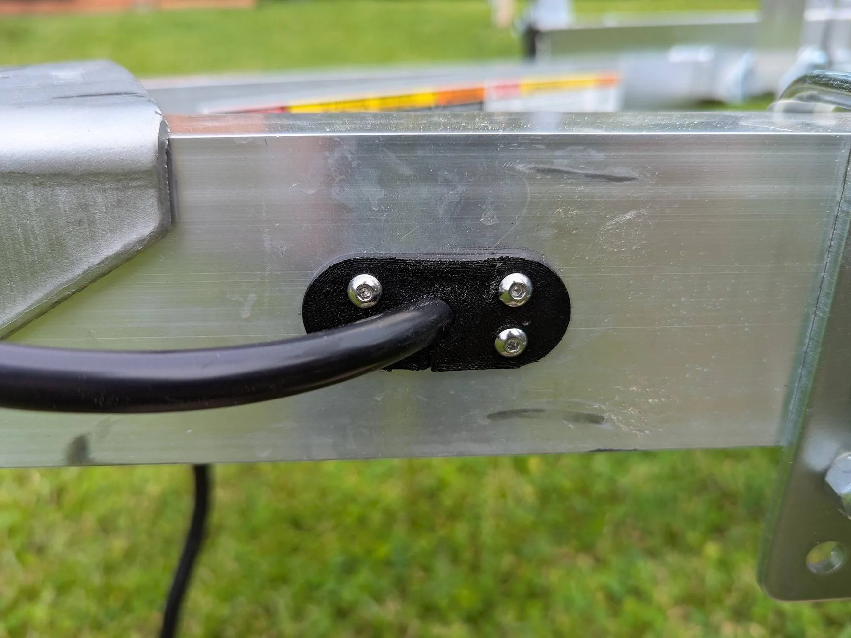

Finally got the trailer all setup and inspected, added a few more d rings and a tongue box I bought off Amazon. I also made a grommet that zip-ties to the 4pin connector cable to keep the right amount of slack between the truck and trailer, factory grommet was pretty cheesy.
Took the maiden voyage to bring an ATV home for service. ATV weighs about 550lb, on 140mile round trip, ATV loaded for half of that I got 24mpg. Outside temps were in the 80's with ac running coolant temp never exceeded 195°F. Trailer towed great, just a little bouncy when empty, nice setup for the Maverick.
