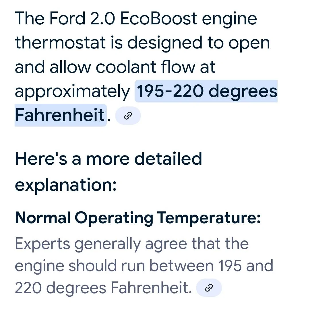

I see the Google AI symbol after each sentence in your response. Google AI is not an "expert" and has no idea who is. Nor does it give any idea of where that temp is being measured. I have seen so much incomplete and incorrect information from the AI responses, especially when technically related. On multiple occasions, I have found the exact, word-for-word, mis-information in a forum related to the same subject I was looking up. In those particular case, it was for bolt torque spec's on motorcycles.

I did not know a scanner Was manufactured to be able to tell you When a thermostat opens. Being that it is a mechanical device. I've never seen a thermostat with an electronic monitoring system. Please correct me if I am wrong. My scanner only tells me when the fans come on.
If you watch coolant temperatures in cold weather on a scanner, you can very easily tell when a thermostat opens and closes. The temperature will oscillate at the set temperature.
Just because a thermostat opens at a set temperature, obviously doesn't mean that coolant won't reach higher temperatures.
Then why does my scanner correlate to those temperatures. It's from Snap on and highly regarded as high quality.
