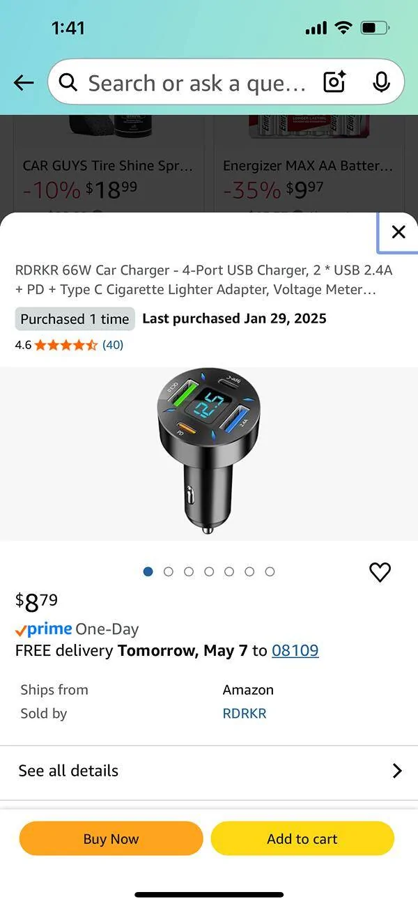

If you want to skip a dealer trip get one of these from Amazon if used for just charging. Also lets you know battery charge status for about 8 bucks.
Ford Maverick USB Type C No Longer Working IMG_4776
Thanks. I ended up taking it back to the dealership and they swapped out the right part. No problem since then, but thanks for the alternative solution.
