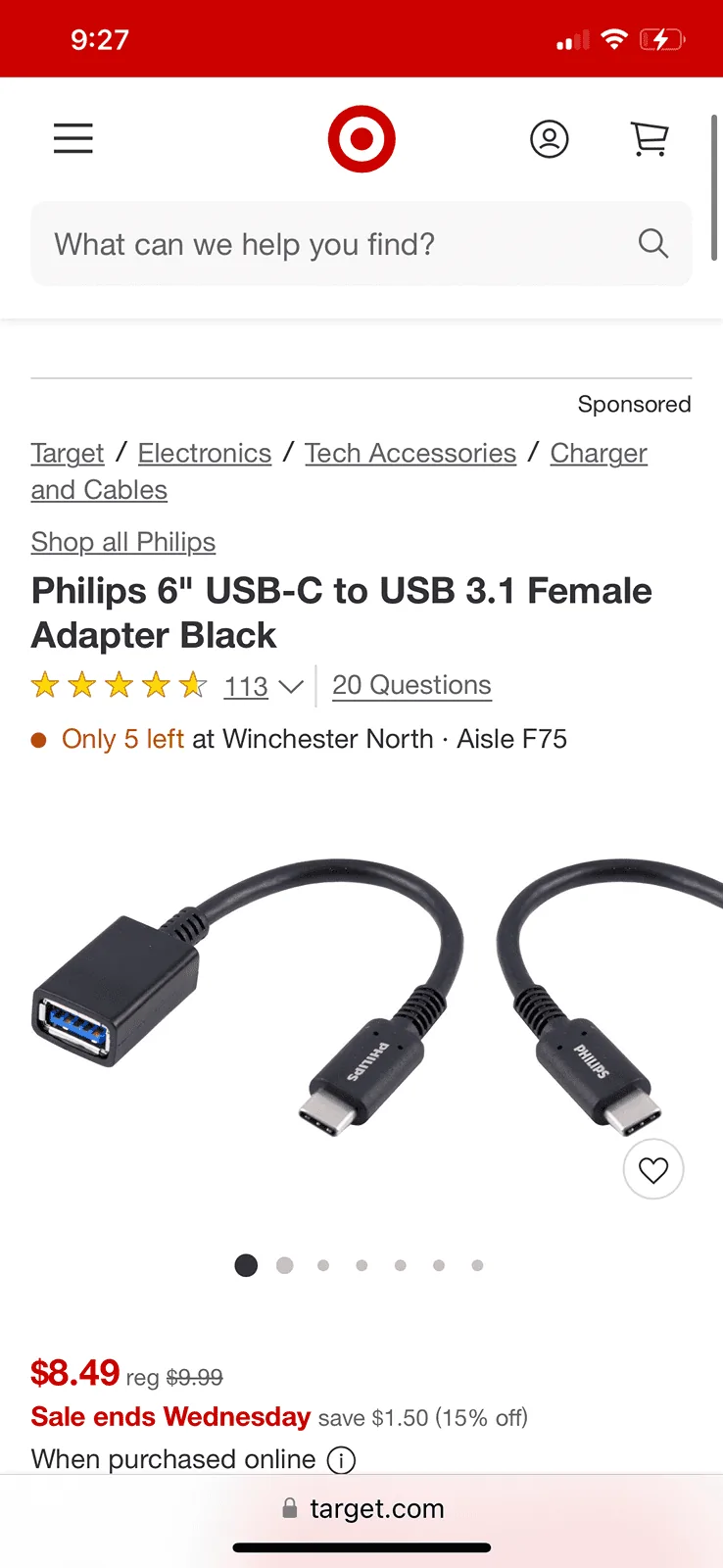

I just bought this today at target works for me
Ford Maverick Wireless CarPlay Adapter(s) Not Working With Flat USB-C Cable IMG_8307

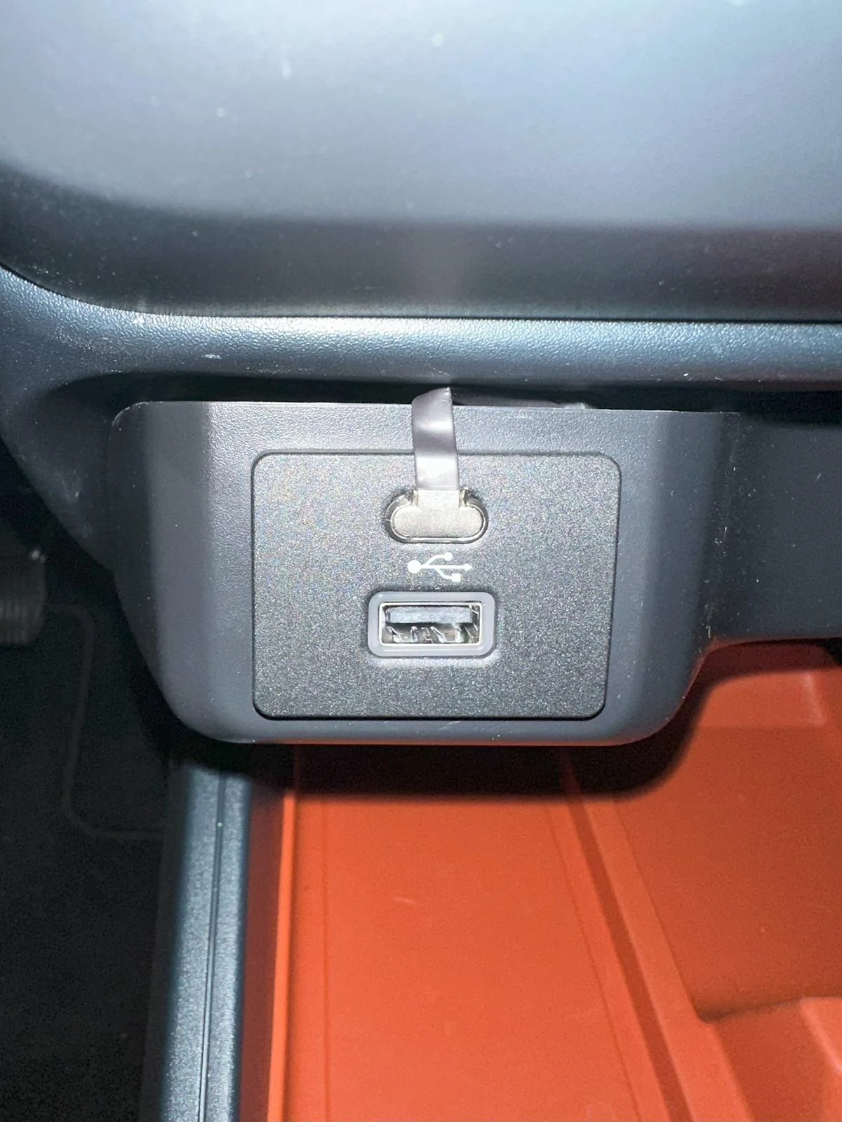

Here's what mine looks like:
Ford Maverick Wireless CarPlay Adapter(s) Not Working With Flat USB-C Cable IMG_1936

This is exactly what I’m trying to achieve. I’ve bought many of those cables and tried plugging them right into my CarPlay box I’ve never thought to run it through an adapter first which I am going to try. I’m surprised they haven’t suspended my Amazon account with how many returns I’ve done over the past month šŸ˜‚
