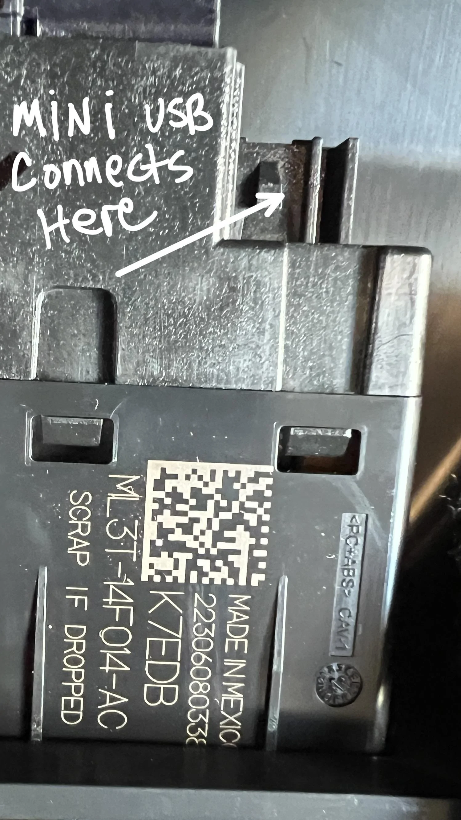

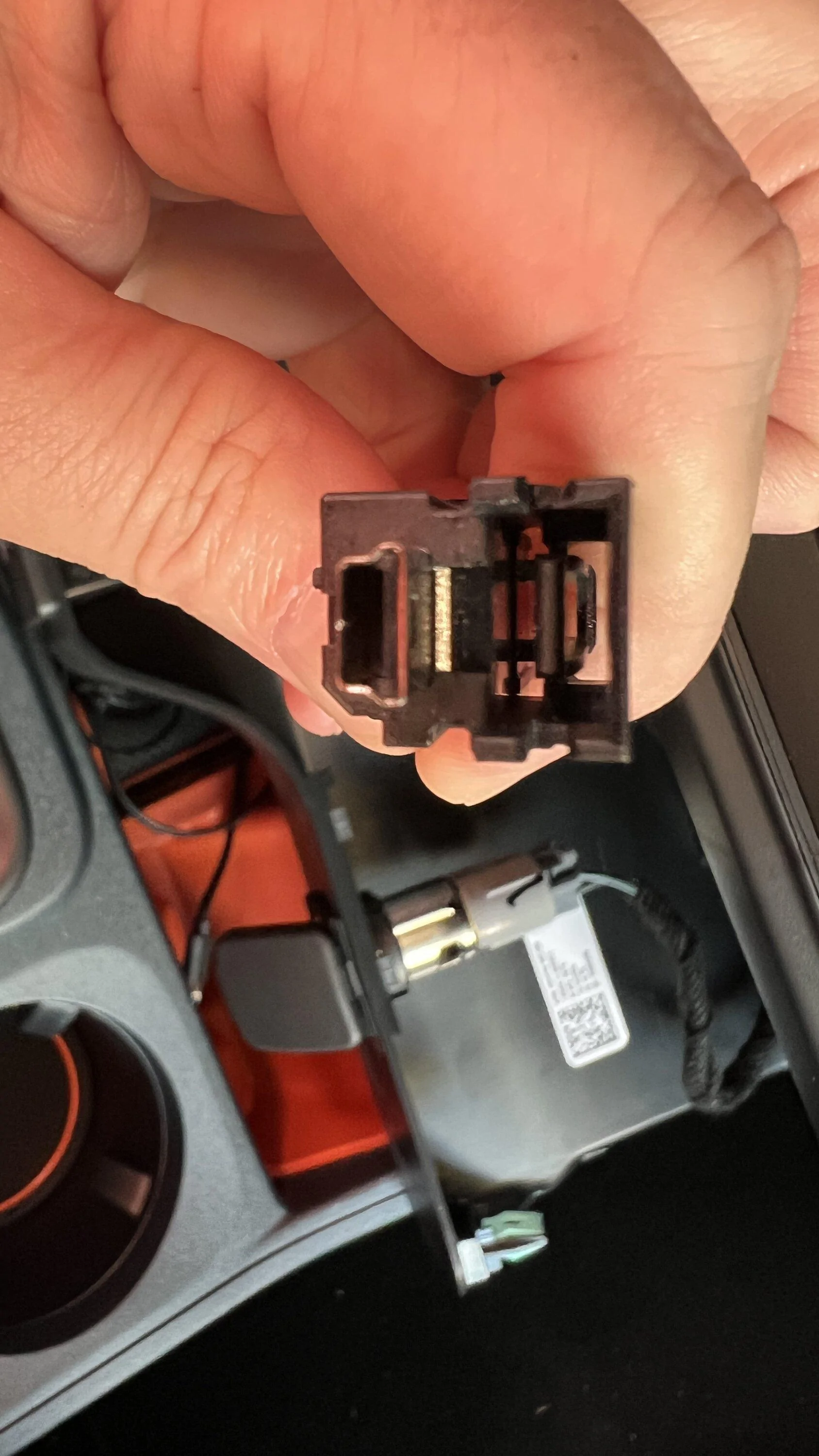

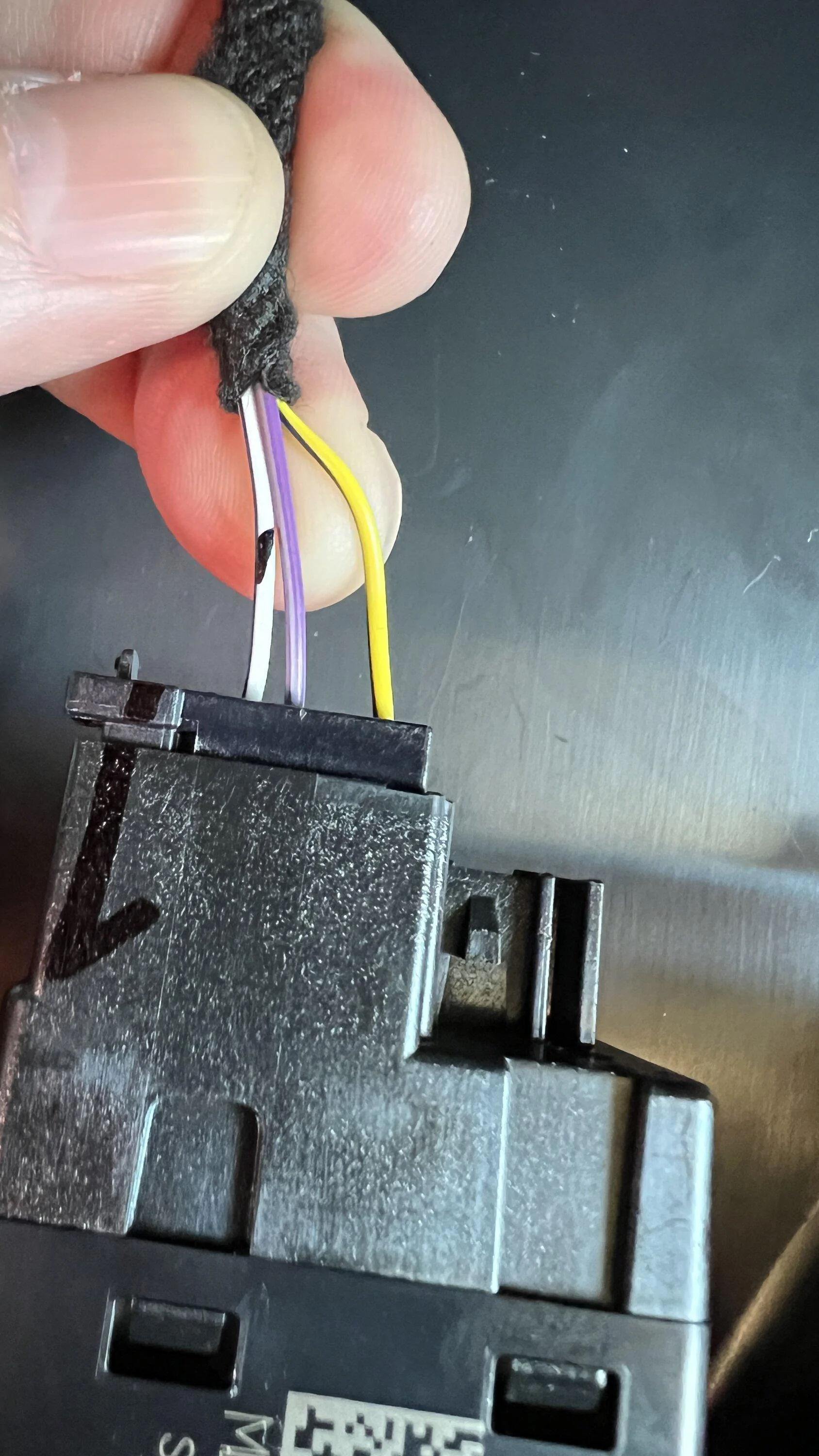

The hub inside the dash splits power and data. The data runs through a usb mini port regardless of using usb-a or usb-c.
USB mini male connector.

Power for USB ports.

The hub for USB ports. Showing where the mini USB connector attaches.
So is it possible to add another data port somewhere in the truck? You said the data is split by the hub... what hub?
