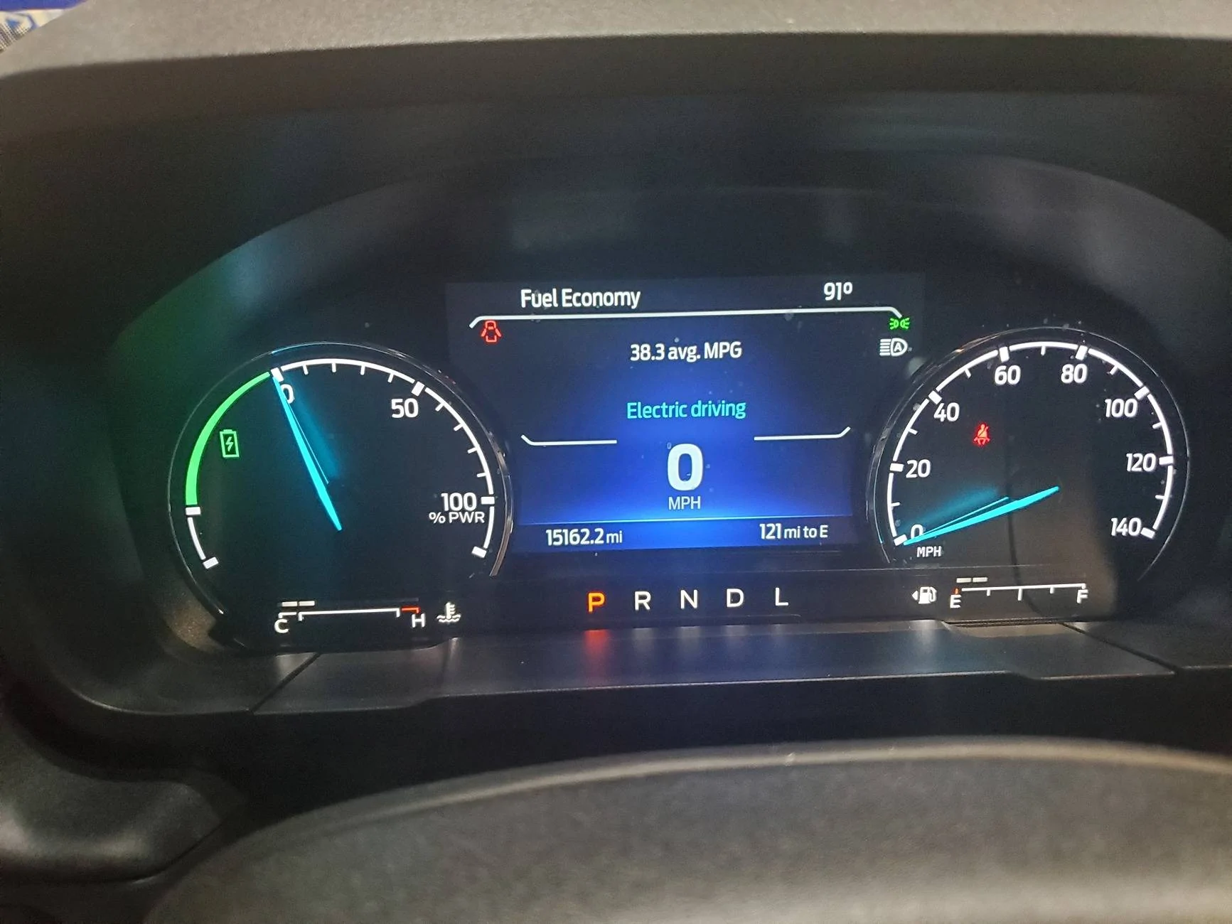

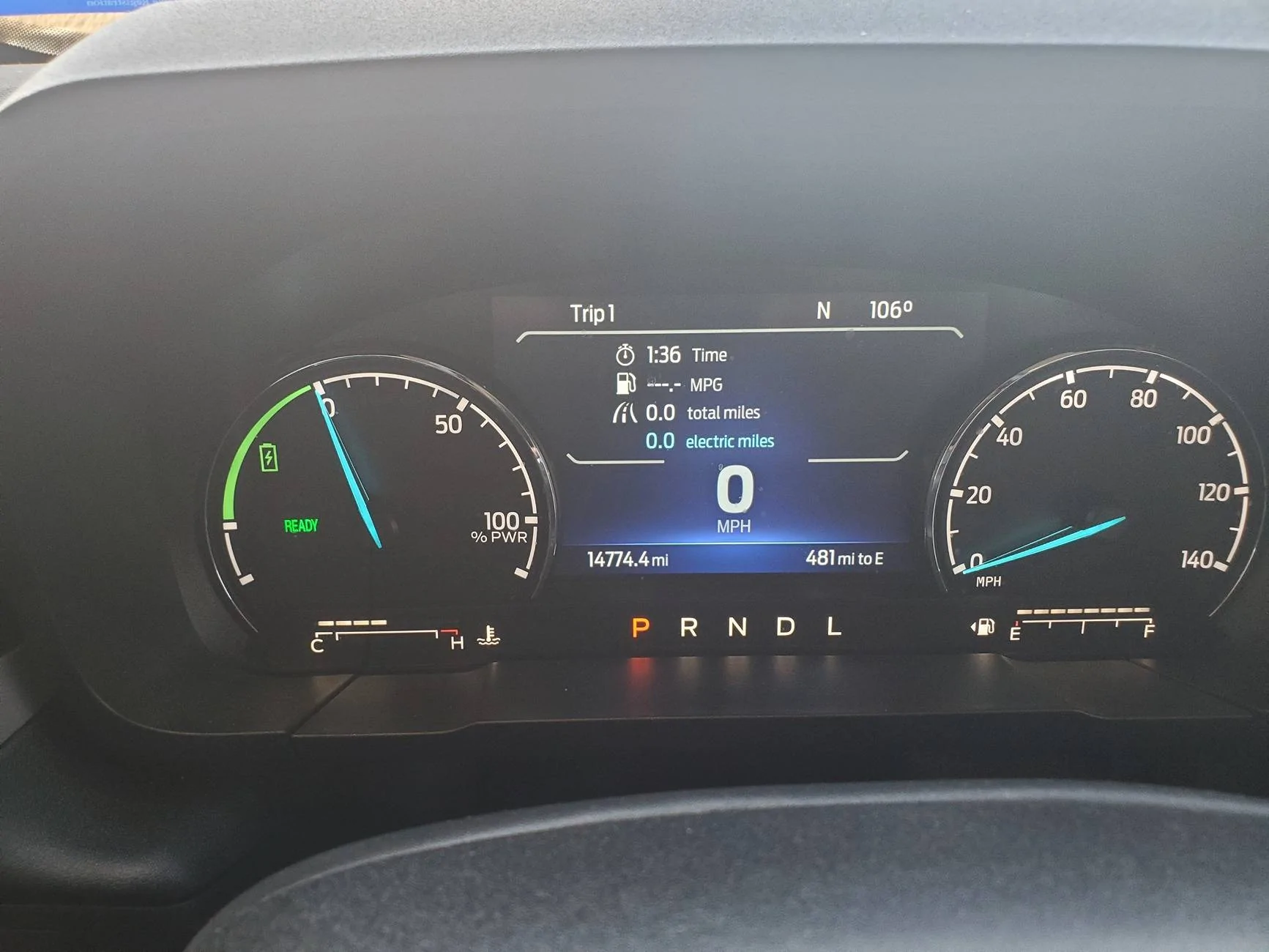

Took my '23 Lariat Hybrid into the local dealer for these two (2) recalls, software updates. As of today, 08/30/24 and just turning over 15,000 miles here are my issues since the software update.
1. On the Fuel Economy screen, the avg.MPG has been frozen at 38.3 (never changes).
2. Again, on the Fuel Economy screen, when I fill up, the mi to E was always around 560-567 from new. Since the software update, I have seen 300, 400 and last fill up, 481.
3. Fuel economy since has dropped from 39+ to just under 36. That may just be the Texas hot weather with the AC always running???
4. Does anyone know what the UPDATE THE BODY CONTROL MODULE BCM was supposed to fix?
Has anyone else encountered these problems? Any insight would be helpful!
Next stop is back to the dealer for a correction hopefully!
UPDATE: 08/31/2024. Maybe the magic number was ~3,000 miles after the software update? I filled up today and everything went back to normal all at once! No issues now.
Thanks RUski
Ford Maverick Update: Maverick Recall Software Update Causing New Problems Last fill up 481
Ford Maverick Update: Maverick Recall Software Update Causing New Problems Always Says 38.3 avg. MPG

I think the computer needs some time to recalibrate the data.

I had the same issue on my eco with the fuel mileage. I have a good relationship with my dealership and the service manager told me to expect it after the recalls were done as the computer "relearns" your driving habits. It slowly went up from 300 mte (miles to empty) to 400, and back to normally 450-500 in about a month. The recalls address a concern that if a tail bulb went out, the truck wouldn't alert the driver properly. Hope that helps.
