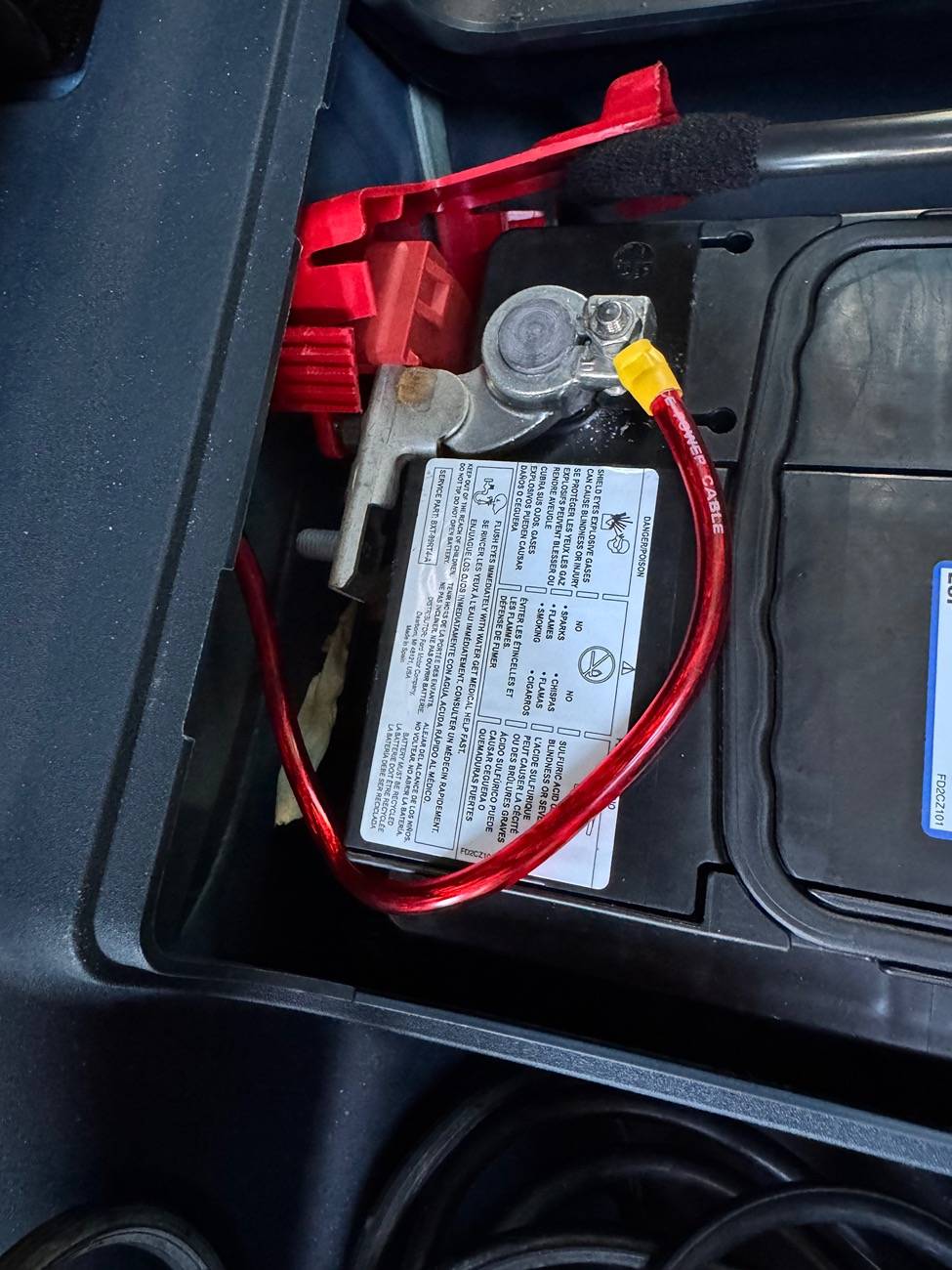

There appears to be a threaded post that is not used on the factory positive terminal clamp. I currently run 8 gauge wire directly to the post clamp but am rewiring soon with 4 gauge, could I just use that unused post and get a nut for it?

I'll be running an amplifier that outputs 600 watts

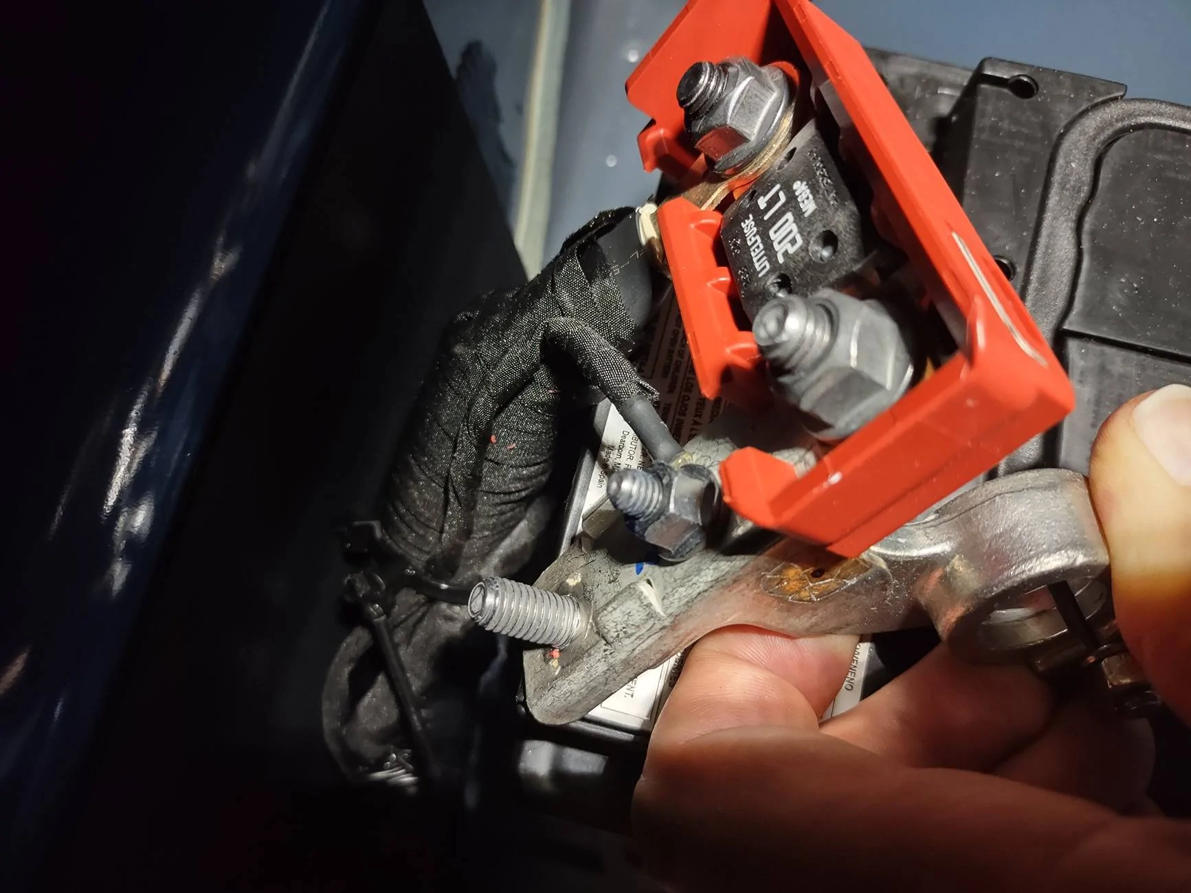

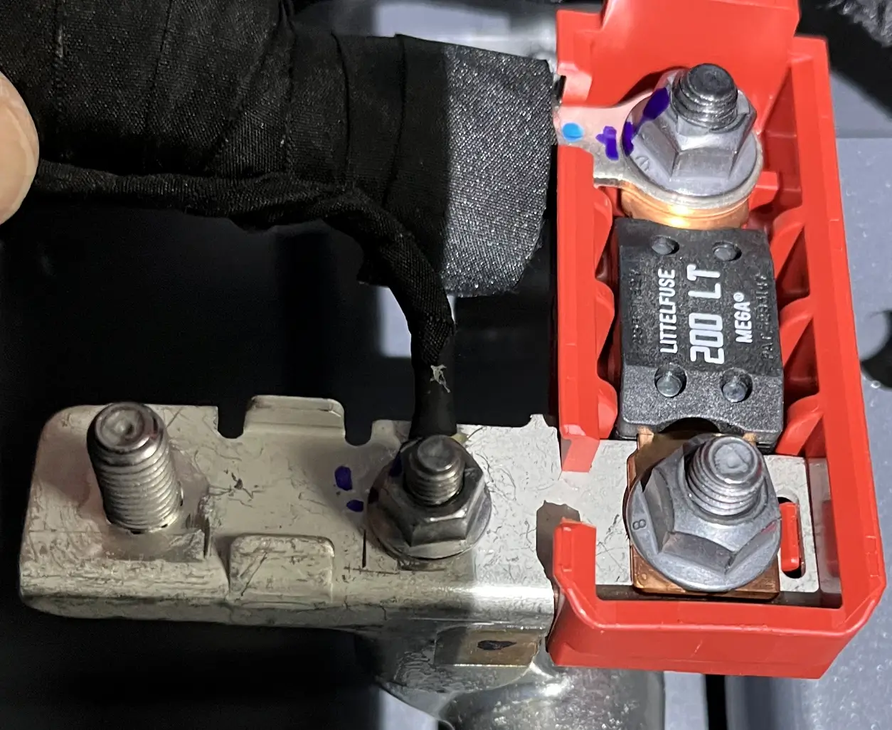

Certainly. Here's the backside, with more pics here: 2000 watt Hybrid inverter as generator
You may have to trim the red cover.
Pardon my ignorance - question for you if you're active.
Long story short, discovered my positive terminal was massively corroded, cleaned it up and replaced the battery for good measure, but I fear the positive clamp around the battery post is too loose and doesn't clasp fully anymore.
Given your photo here, can I replace just the terminal connection nearest the bottom of the image - the chunk of metal with 3 bolts, if that part is sold?
I'm far from a pro - appreciate any insight

Unbolt cable for 12V at bottom and the small 12V feed to the BMS. Replace & bolt in new.
