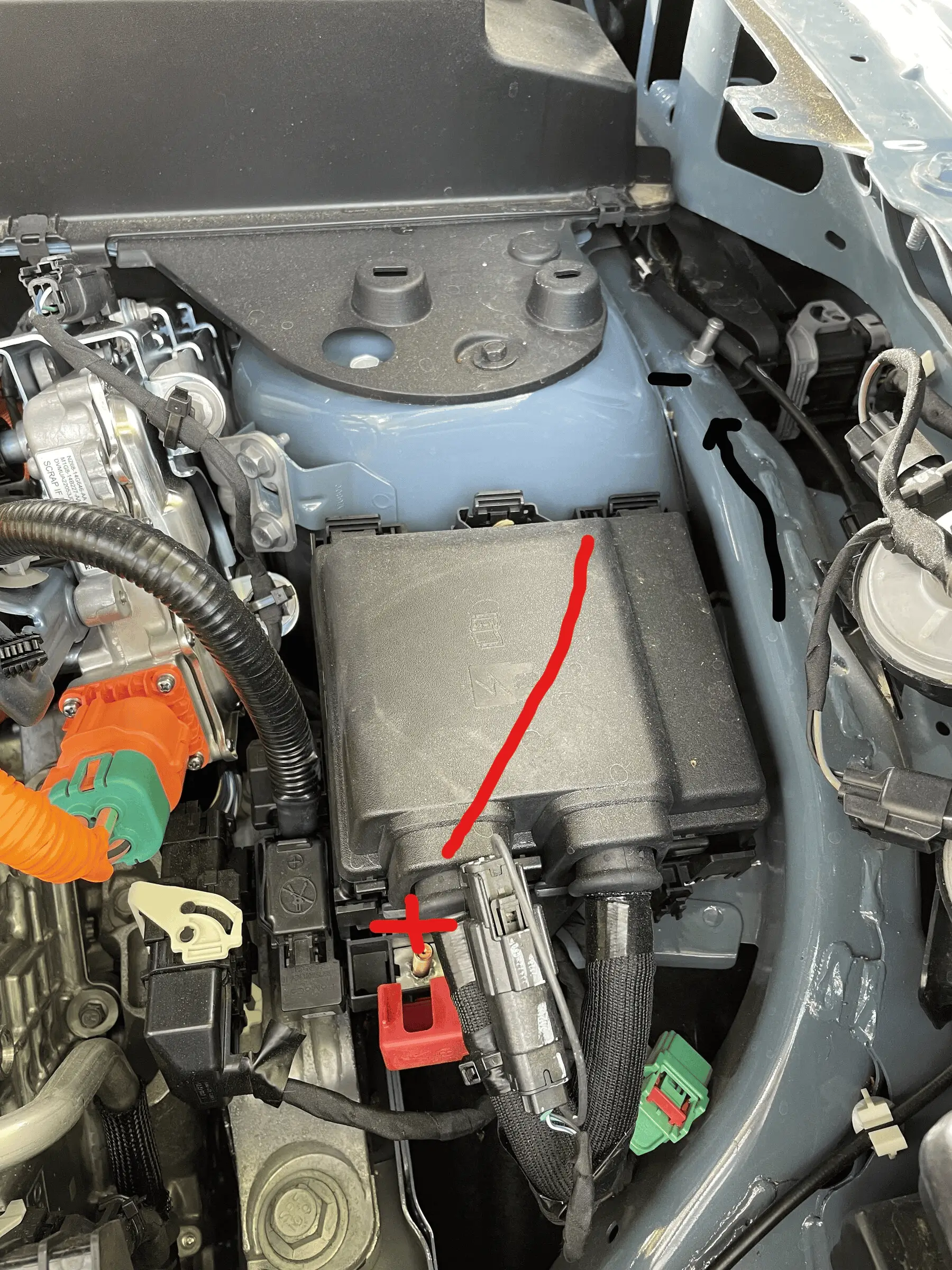

How about the nut to the left of the positive terminal? The DC to DC converter that has the little jumper cable crossed out. Also 5/16 x18?

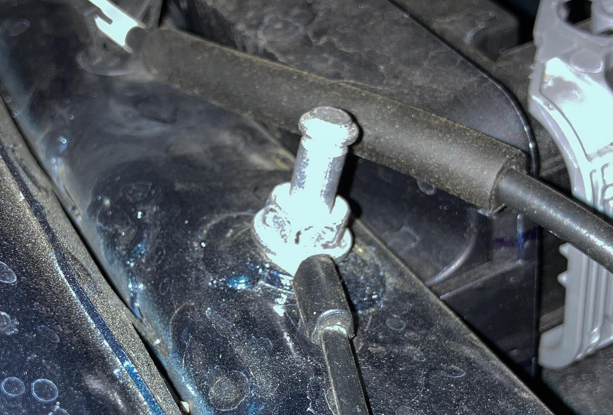

23 XLT 2.5L, 22 Escape Plug In, 23 Bolt EUV
M8 x 1.25 on a used 300A fuse assy I have.
It's the front stud, missing the flip cover.
Front stud? Are you showing the one that I pointed out?
Are the two studs in direct continuity with each other?

Front stud? Are you sending one that I pointed out?
Separate. Both bolt to bus bar. Fuse under the front stud.
