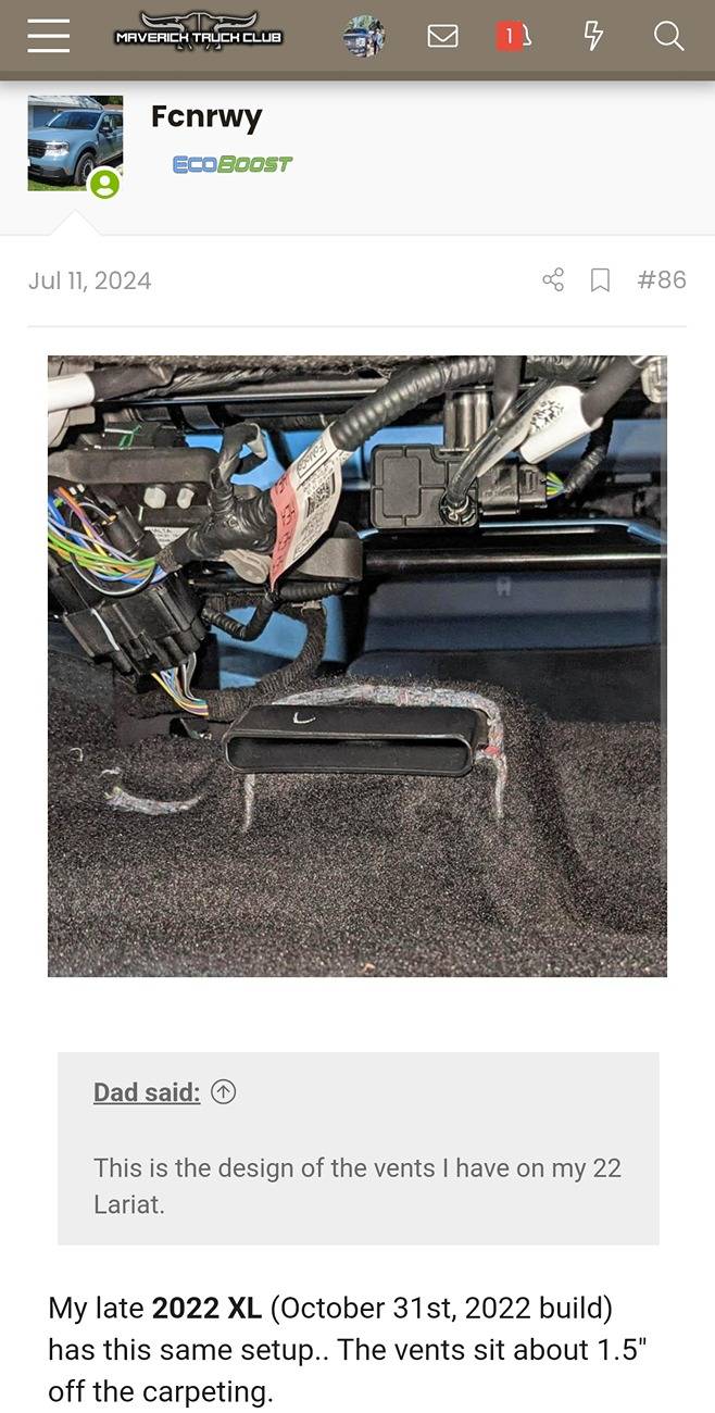

I’d swear that there were different vents under the seats in some 22’s? Guy at my work is 3d printing a set for me. I can get them to fit regardless, just soften the end with heat gun, plan to do that get a super tight fit
Yep there were.
Here's a screenshot of a post from an earlier thread.
It seems that Ford decided to eliminate the vent outlet surrounding as a cost-cutting measure.

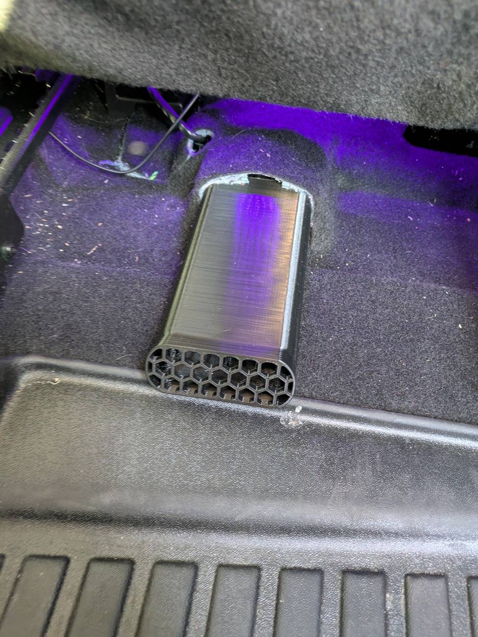

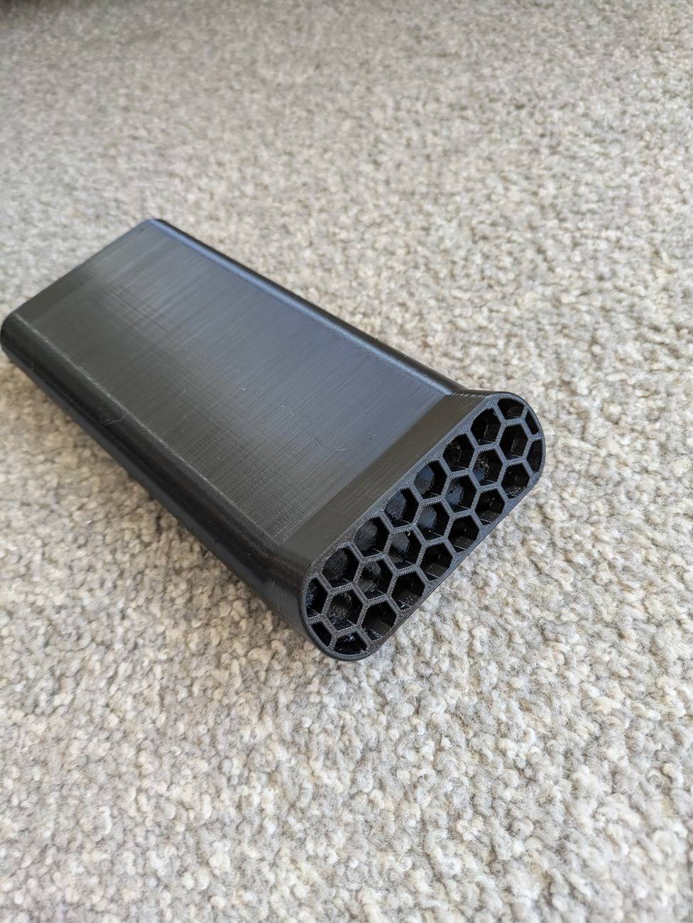

I decided to design and print my own. (free time since the layoff :LOL: )
Ford Maverick Under Seat Vent Extenders PXL_20250301_161234595

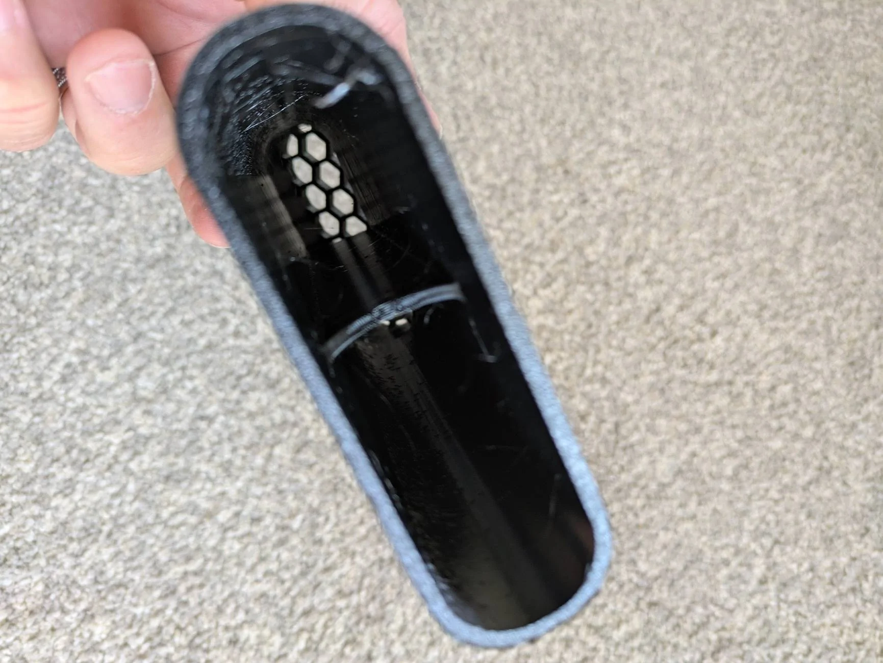

Added one center interior rib for support after printing the first version
Ford Maverick Under Seat Vent Extenders PXL_20250301_161249930
Fits snuggly on and the center rib makes sure it doesn't slide too far forward and still fit under the carpet.

Well done! These came out great. The extender body is about twice as long as the F-150
I have the 3 hole vent setup.
Well done! These came out great. The extension body is about twice the length of the ones I ordered on eBay, so I'm not sure if they are short enough to not protrude into the back seat foot well. I'm sure you factored that in when you made them. I just can't tell from your photos. Thanks for sharing these.

This is the view with the seat mid way back.
