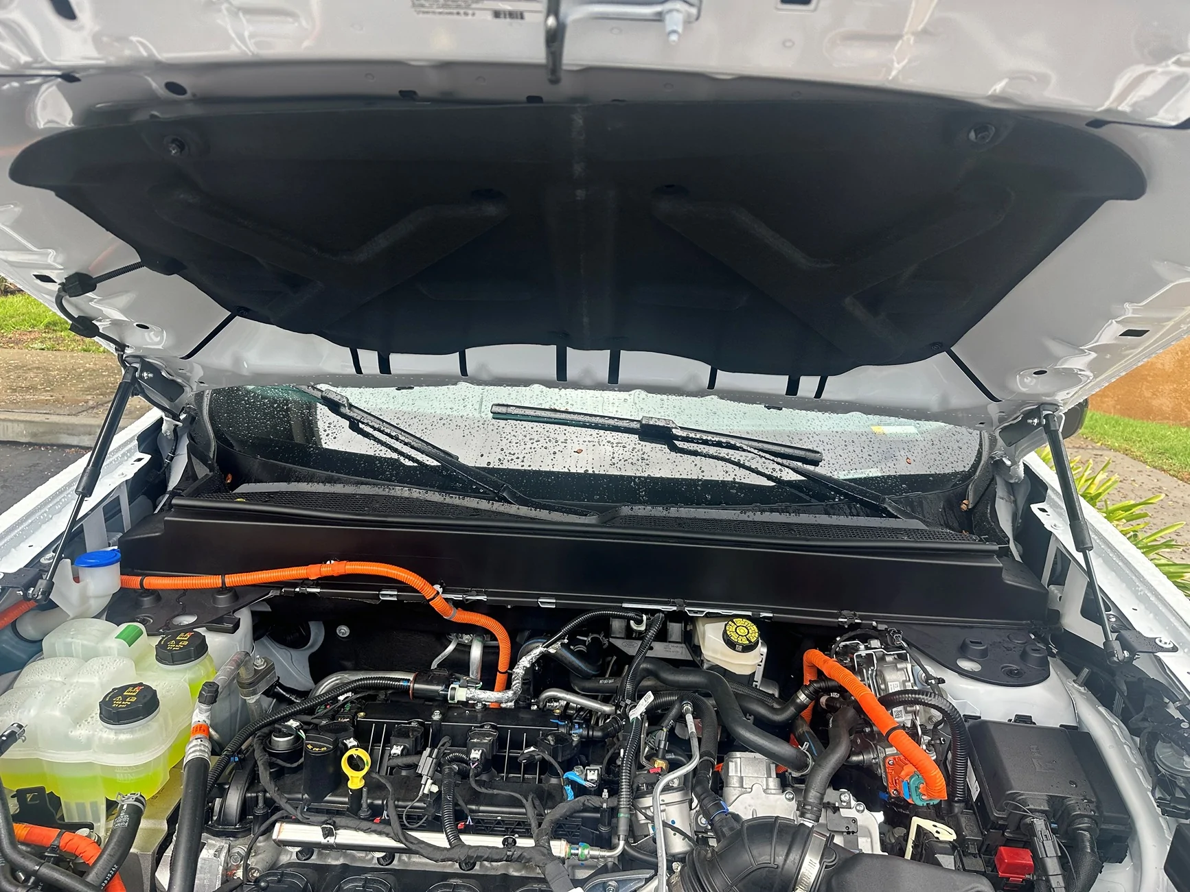

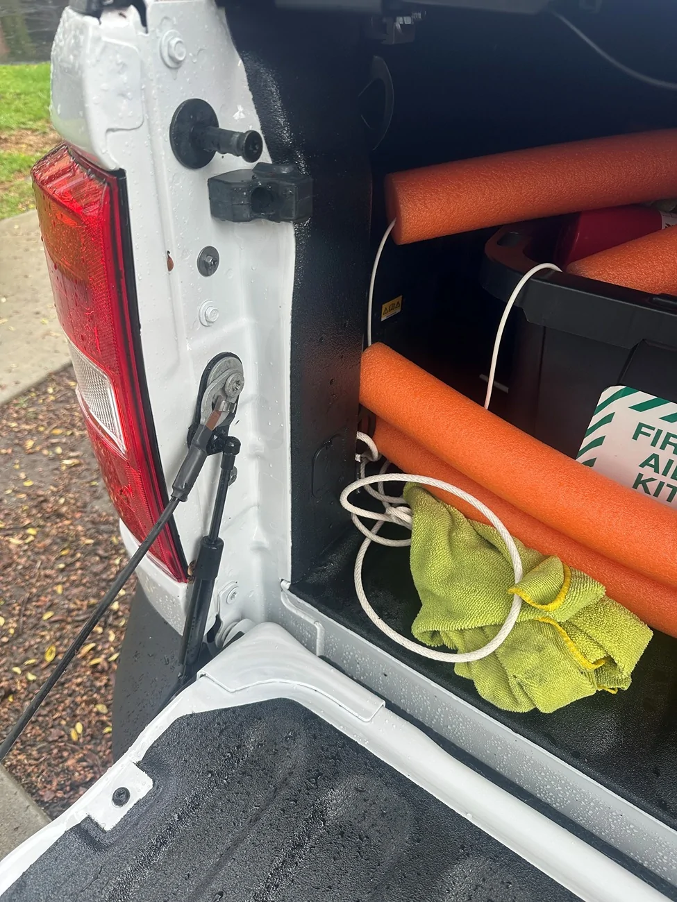

Even though the tailgate isn't that heavy, the addition of a gas spring greatly improves it when lowering. Also, the hood prop-up rod is so 1940's that I just had to install gas springs there as well. The under hood pad didn't really damp the noise much, but maybe a little.
Does anyone know of any fender well inserts for noise damping?

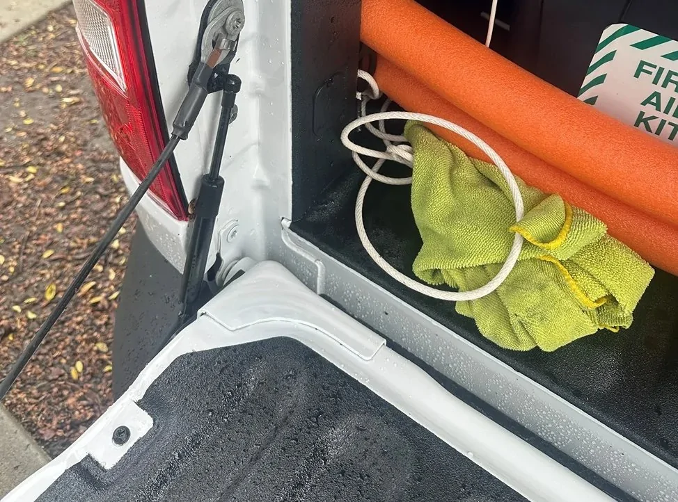

Oh no, something is now missing from this photo:
Ford Maverick TWO HANDY UPGRADES missing

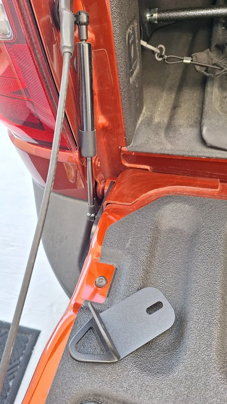

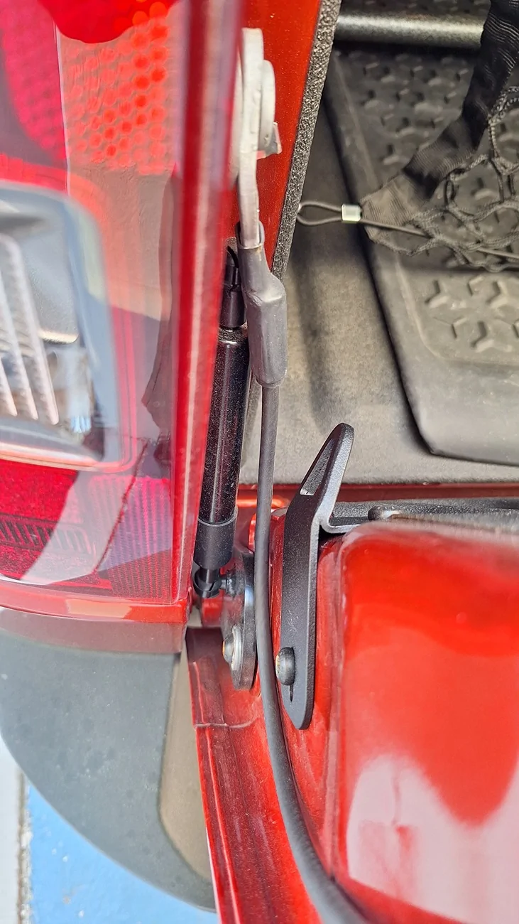

Don't let the addition of the tailgate strut mean you lose a tie-down point.
In addition to replacements you might find on Amazon, I have an option available also that I make and sell.
Ford Maverick TWO HANDY UPGRADES 221258-5d38332d1e5f7e8761f1030b274d31c5
Works well and clears the new strut and no issues with the cable. And made in the USA by a fellow Maverick owner. I have a thread here in the For Sale forum.

The hood however is not so 1940s....and you run the risk of damaging it by using the gas struts. To each their own.
Don't lose a tie-down point!
I have one of Lane's replacement tie-downs and it's great.

Not to mention the risk of your head being damaged when they slowly lose gas and the first cold day of the year sends the hood crashing down when you least expect it...lol
My thoughts exactly. Not too mention the huge dent in the aluminum hood!
The aluminum hood is easily dented but, dang, you must be "hard-headed"???:unsure:
