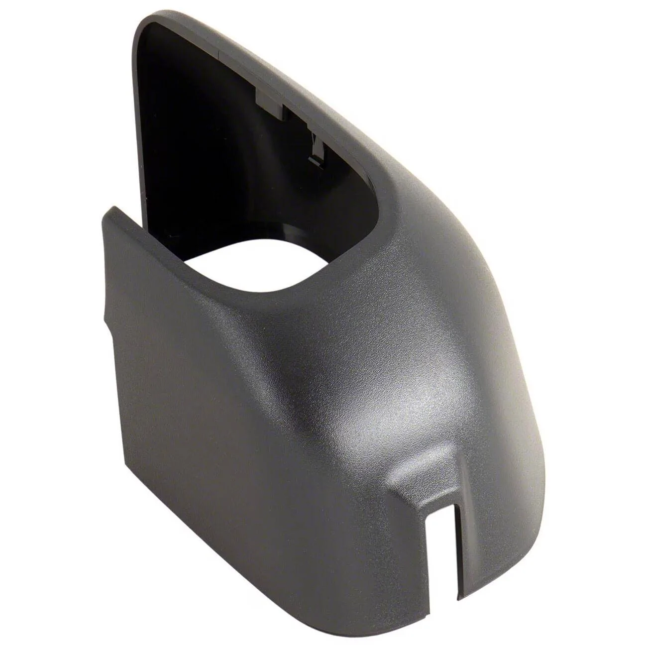

I have to wonder if the Ford Escape mirrors might be a fit. I can always add the wiring myself to make them work if it doesn’t have the preconfigured for the Maverick
Escape mirrors are much too different. They are bolted in versus stud and nut on the Maverick, also the electrical connector is in a much different spot. I believe the mirror cover plate against the door is significantly smaller as well. Your best best if you don't mind wiring is to get the Brazil Maverick mirror housing cover and install a small LED strip but you'd be searching for something that fits perfect unfortunately. Modifying your existing housing to accommodate something off the shelf might be best. If the existing wiring harness carries the signal wire for the lamp it's just a simple change with Forscan to enable the signal and then wiring it from the mirror side otherwise you'll have to pin both sides and run either to the BCM or a source wire.
