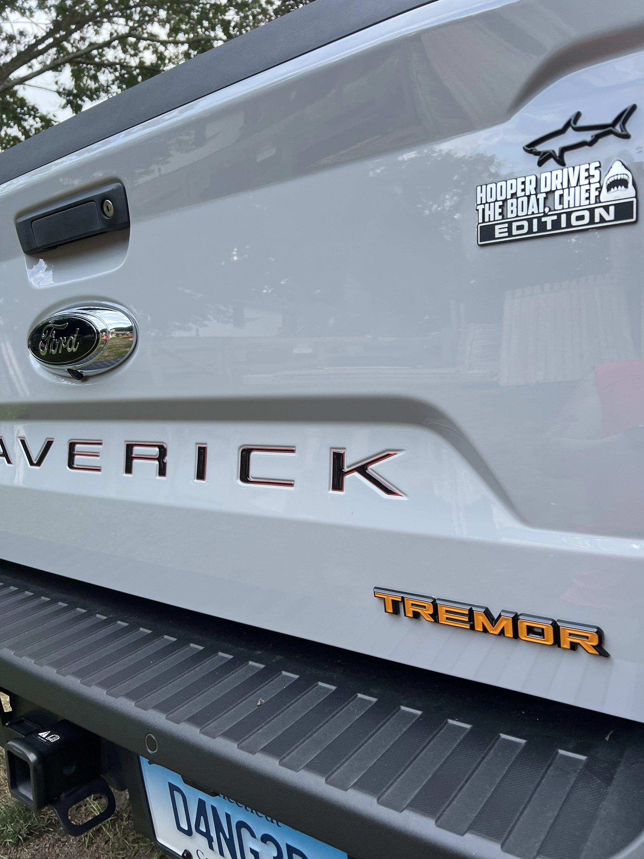

De-badged the Tremor decals off sides and tailgate. Found a Tremor plastic badge for an F150 on EBay. Love it.
Looks nice. I like how the decals on the side tie the orange together though.
Yeah I agree on the colors, just not a fan of the decals. The orange in the tires and lariat in orange were enough for me. 👍

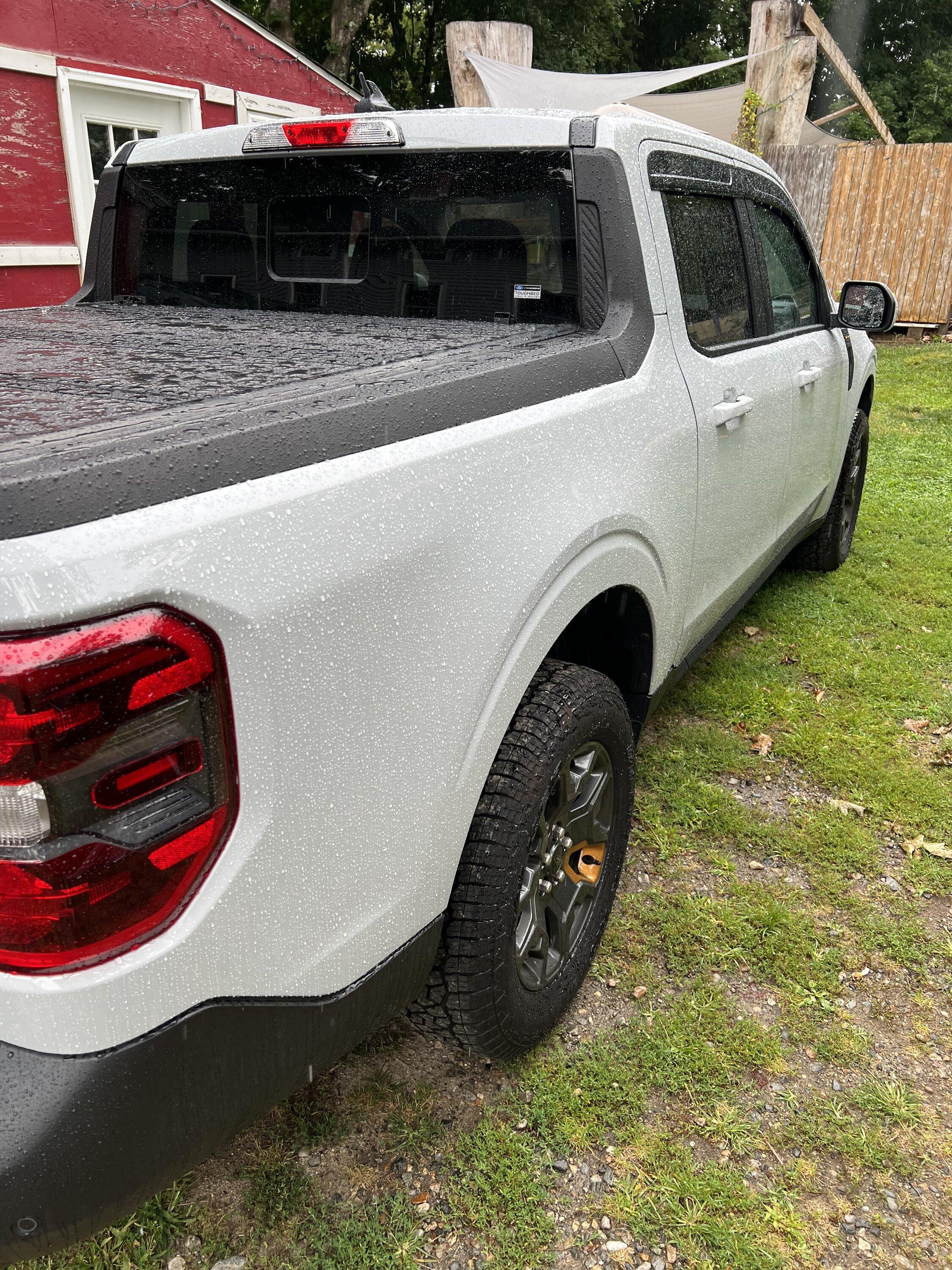

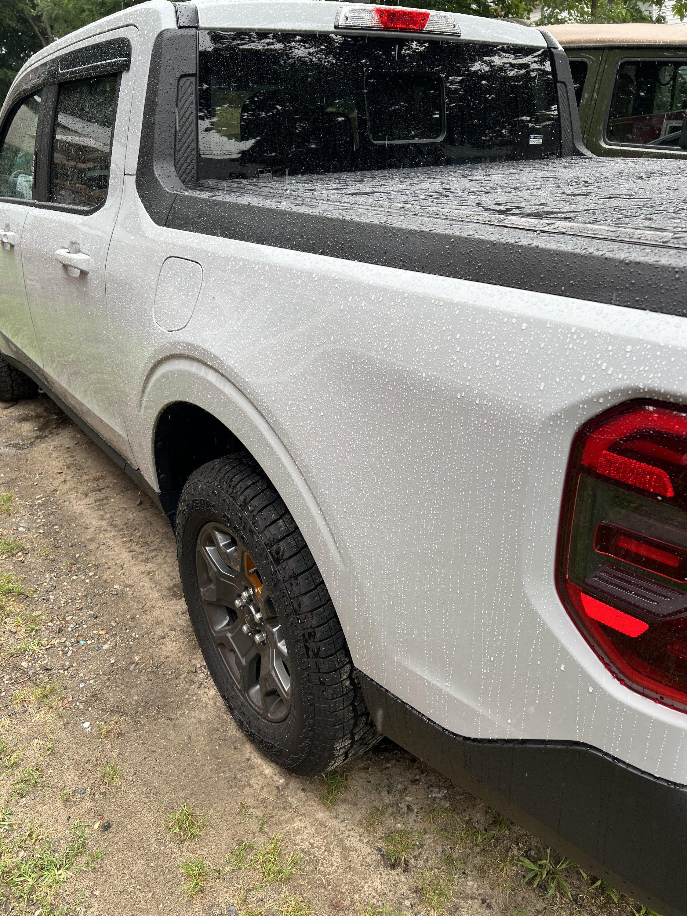

Please post side views of the de-stickered Tremor. How hard was that to do?

it was so easy. Honestly it was so hot outside I peeled them right off. I had the truck in the sun. But, if you have a small hair dryer you can heat it up pretty quick but move it back forth evenly and slowly pull off the stickers. Took about 3 minutes for both. 👍
Ford Maverick Tremor Badge IMG_4873
Ford Maverick Tremor Badge IMG_4872

I love that Tremor badge you added. More subtle and my style than the stickers.

I removed my quarter panel Tremor decals too..... BTW, it's best to remove them sooner than later because after being in the sun for more than a year (probably sooner) they get "baked" on by the sun and become impossible to remove without damaging the paint.

How did you go about removing them? I see how the OP did it, but it's winter so outside heat won't help.

May do the same it looks much nicer. Still stuck on good? Happen to have a part number? Are some on eBay, but I want to make sure it's the right size.

does anyone on here know where to find the 3D print file for the tremor badge? i looked on thingsverse and printables but its not there

I used a heat gun but a hair dryer should work just as well....just go back and forth to slowly and evenly distribute the heat. I removed the quarter panel badges/decals last fall outside in 60-ish degree outdoor temperatures. I removed the tailgate decal in January...but did it in my garage where the temperature was in the high 40's. I just took my time and the tailgate decal also came off easily. Peel them off slowly...I wouldn't "rip 'em" off.
