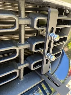

Thanks to @Darthie for posting his retro fog/driving lights. (Apologies for not crediting you previously) You inspired me!
After MUCH trial and error, I was finally able to install same lights on my Lariat. I was able to create an attachment to the grille grid without having to pull the bumper off. I did need to loosen the grille away from the engine bay in order to run my wires.
The Lariat's grille is surprisingly sturdy, but I reinforced the slots using metal braces in the openings. On checking the grille construct of the XL and XLT, I would say they are not sturdy enough to support these lights. The lights are attached to the grille using heavy duty "L" brackets and carriage bolts. All fasteners are stainless steel.
If you're interested, I will post more details including how to loosen the grille away from the body, what brackets I used and where to buy. Fasteners were purchased at Ace Hardware because those folks believe in customer service.
