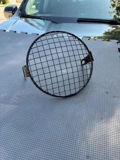

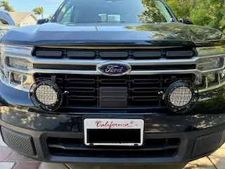

Hello, again. Thought I would update you on the stone guards I installed a few days ago in case you were thinking of doing the same.
Since it was next to impossible to find metal grid guards in a 5" size, I decided to get these 6" guards for $8.99 and see if I could adapt them to our fog lights.

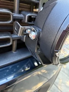

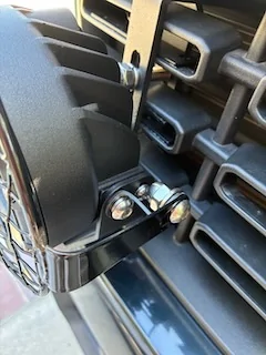

I took a small "L" shaped bracket and bent to more of a "Z" shape to accommodate the extra size. I used the existing screws on the lights to attach the brackets and then added screws to attach the other end to the grid. I think it worked out well.
Interesting. Looks pretty good.
