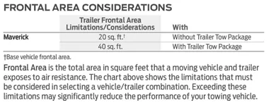

Really? Widthxheight
What really matters is the aerodynamic drag coefficient times the cross section area, CdA. You can find that for lots of vehicles, including trucks. It's harder to find for trailers, especially when you would have to account for how much the truck would "shadow" the drag of the trailer. I'm sure that's why they just give the frontal area of the trailer. There's too many variables.
There is no coefficient of drag limitations, nor a reduction from what is behind the truck. There is simply an area limit, wxh.

That Jayco weights 1585, the hybrid Maverick weights 3674, the Maverick's GCWR is 6010.
6010 - (1585+3674) = 751. As long as you, your family, friends, gear and fuel don't weigh more than 751 you're good to go.
I'd question the 20 SF frontal area limitations, since the frontal area of the Maverick itself is about 30 SF.
I think that restriction has to do the the effects of the turbulence coming off of the back of the truck and hitting what is being towed behind. "Exceeding these limitations" mean it is doable but your speed and your MPG will suffer greatly.
