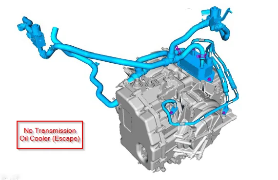

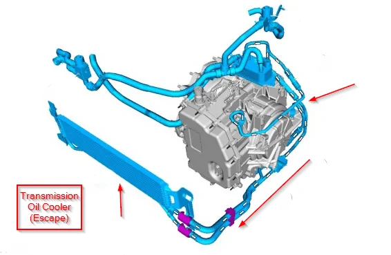

Same here. I'm guessing it'll be similar to the Escape Towing Package one, but wanted to confirm. Here's some pictures I found of it. If so, it does not look terribly hard to add one (for longevity vice towing).
Ford Maverick Transmission Oil Cooler - Possible add on?  Any pictures? 1634687989801
Looks like you literally tap off of one hose connection (far right arrow) to split into the out/in for the cooler then run the lines and mount the radiator. I'm sure there's more involved but certainly looks feasible if it is the same design.

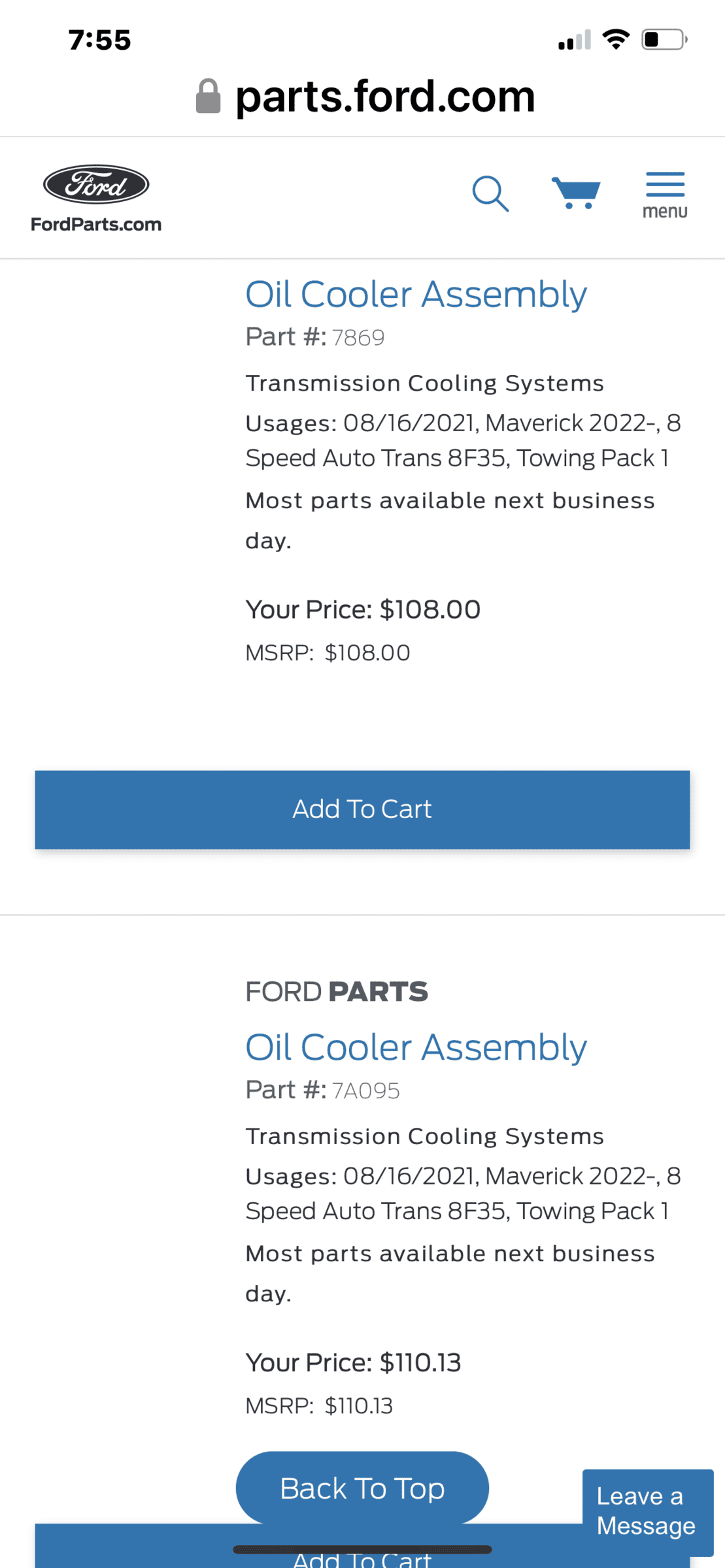

There are two different coolers available for towing pack one. The more expensive one is bigger. Not sure what the qualifier was to determine which one ford used. Hoses and mounts will probably be different as well. I have been researching this as well. Maverickxl2022 gave me some good tips. I got a vin for an xl with the 4K package to start my research. Now I just need to go on motorcraft.com pay my 27 bucks and lock the rest of it down. When I do I will report back with part numbers.
Paul

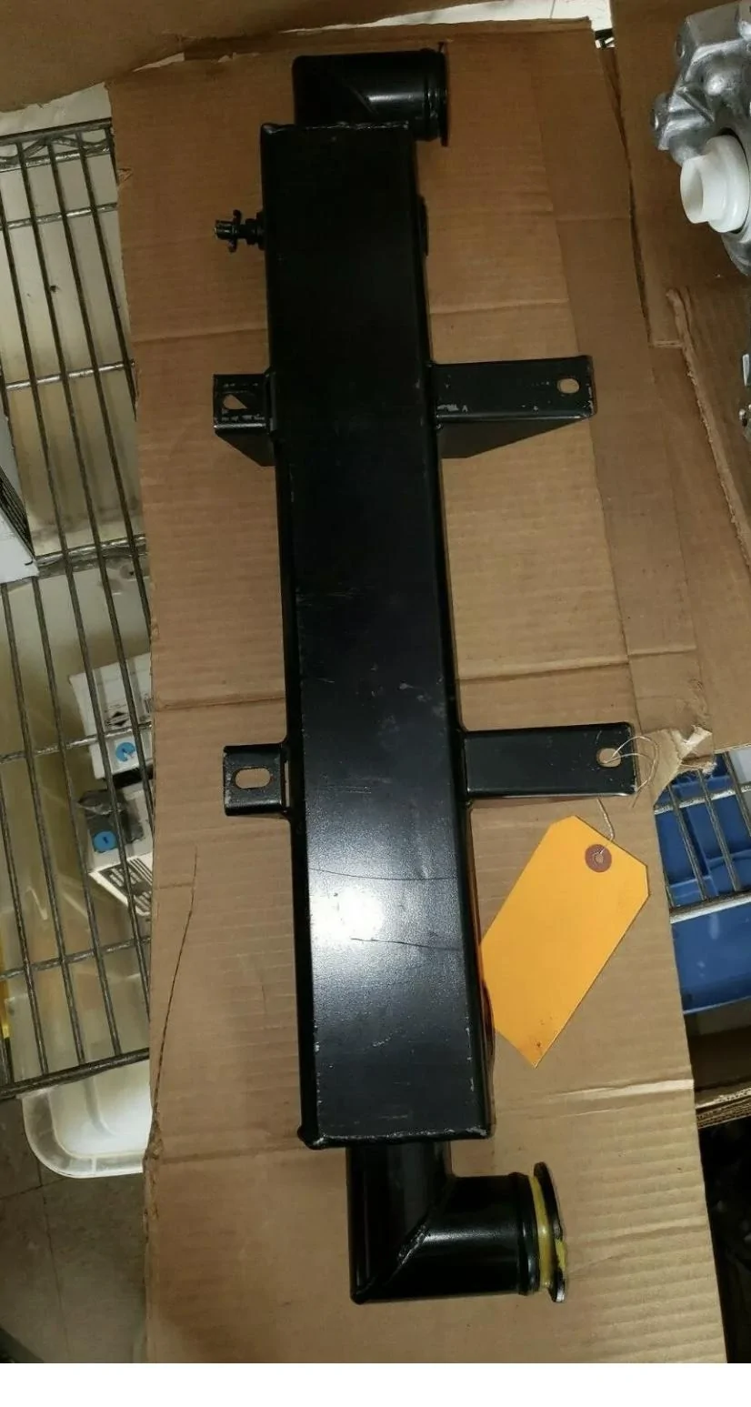

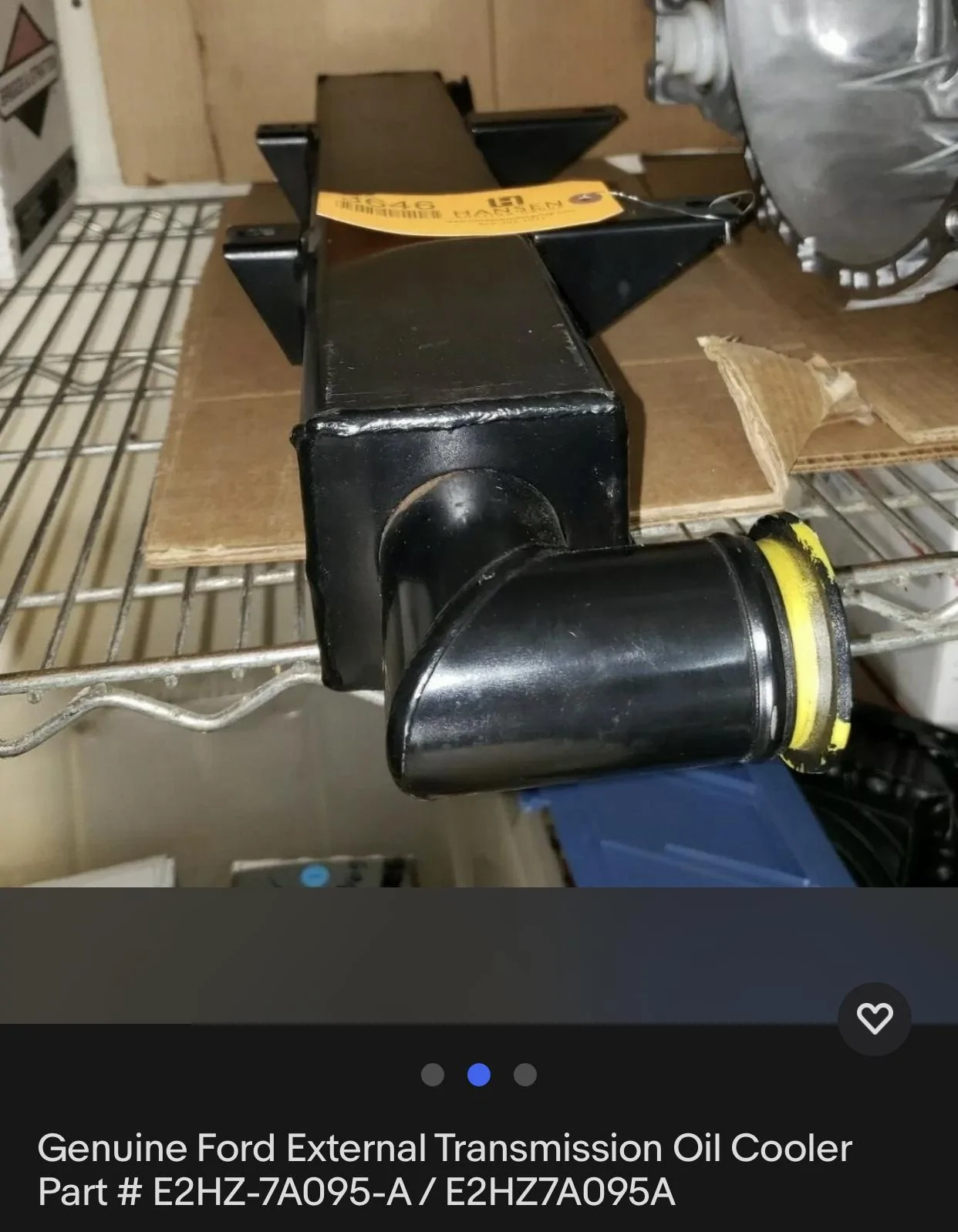

Partial part number match and what I think the larger one looks like, will verify and report back.
Ford Maverick Transmission Oil Cooler - Possible add on?  Any pictures? D7221B4F-A1ED-472E-A31F-72E6B727E1DC
Ford Maverick Transmission Oil Cooler - Possible add on?  Any pictures? 1FAD0784-F0B2-4CDB-8A44-083876A8D9A8
sabar
Oct 21, 2021
2022 Maverick Lariat
That cooler is for a heavy truck. It should be a plate-and-fin style small radiator (about the size of the intercooler) but with small hose connectors for the trans fluid lines. It ought to be very similar to the Ford Escape setup shown here:
