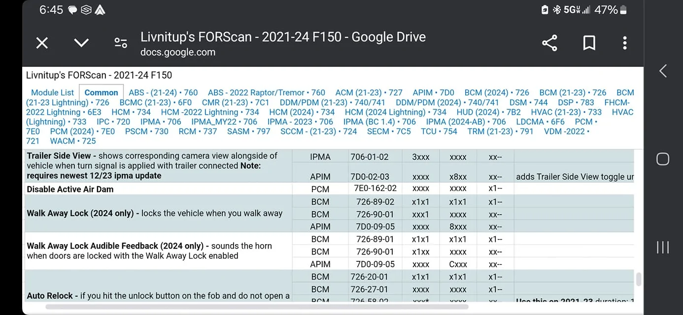

I was hoping there was a way to turn it on with FORScan rather than just fooling it with a trailer plug. I think fooling it that there’s a trailer connected all the time will lead to other things changing unintentionally.

Not to hijack the thread, but is there a way to turn this on for a 2025 with the 360 camera?
I found this for an F-150. I will have to hookup Forscan on mine and look around.
