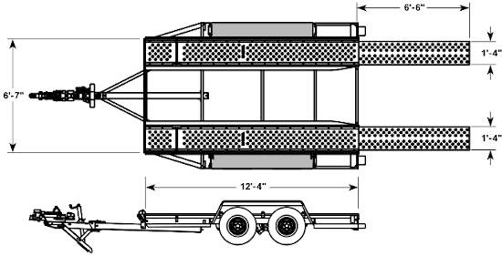

Source on those numbers? Seems you're under half the actual weight of the trailer, unless you're just looking for a dolly. 2210 lb trailer + 3200 lb Kona puts you at 5410 lb approx, with no additional load. That's 35.25% over the 4k tow package's rating. Even if the vehicle can move that weight, will it be able to stop when needed?
Presumably you'll be hitting some mountains as well which will push the vehicle and your skills that much harder. Are you experienced in hauling such loads cross country? If not, you may want to heed the advice above and get some quotes to have the vehicle shipped, if you don't have/want a second driver.
Bear in mind that being over the weight rating could give your insurance carrier grounds to deny any claims, should something go wrong. However, if you use a reputable shipper, you should be able to secure insurance if they don't provide it by default.
U-Haul lists a required 5,000 lb minimum tow rating, so even if you have a Maverick with the 4k tow package, that is below their minimum.
Not that anyone follows speed limits, but U-Haul also advises a max speed of 55 mph, which slows down the trip.
Bottom line is that without a bigger truck with a higher tow rating, they really intend for their AUto Transport trailers to be used with their moving trucks, not a Maverick.
Now, their tow dollies are 750 pounds with a minimum 3500 lb tow vehicle rating, which would have the rear wheels on the ground. You'd need to ensure the Kona is able to be towed this way. Still, you'd be right at the limits of 4k tow without any cargo.
https://www.uhaul.com/Trailers/Auto-Transport-Rental/AT/
Capacity
  • Max load: 5,290 lbs.
  • Gross vehicle weight: 7,500 lbs. max.
  • Empty weight: 2,210 lbs.
Towing vehicle requirements
  • Must be equipped with a hard top if it is an SUV. U-Haul does not allow any type of sport-utility vehicle not equipped with a hard top to tow U-Haul equipment.
  • Tow vehicle and trailer lighting must be operational at all times, day and night. All U-Haul trailers and towing are wired with a 4-way flat light connector.
  • Must weigh at least 3,500 lbs. (curb weight), and must equal or exceed 80% of the combined weight of the trailer (2,210 lbs.) and the vehicle being towed (up to 5,290 lbs.).
  • Must have a towing system that has a 5,000 lbs. minimum weight-carrying rating
  • Must have 1-7/8" or 2" hitch ball (5,000 lbs. minimum)
  • Must not exceed maximum allowable hitch ball height of 25"
  • Must have external mirrors on both sides
  • Must have fully operational lighting
  • Maximum recommended speed is 55 MPH
  • Load trailers heavier in front.
  • Reduce normal driving speed.
  • Wear a seatbelt.

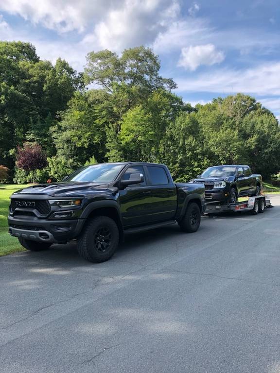

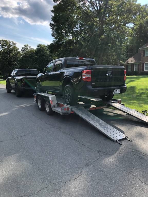

Um, yea, don't trust anyone when the pics I posted above are me towing my '23 home last month with the exact trailer the OP is considering and stating that the dry trailer weight is ~2200 lbs -vs- the OPs 1000 lb guess, and JSUS copying and pasting 2x actual trailer info from the U-Haul site showing the trailer weight is 2210 lbs, along with capacities and towing requirements of that and the dolly...
NOTHING in Ford's towing guide will state anything about the capabilities or weight of a U-Haul dual axle transporter.... and the OP knows he's got the 4k tow package...
