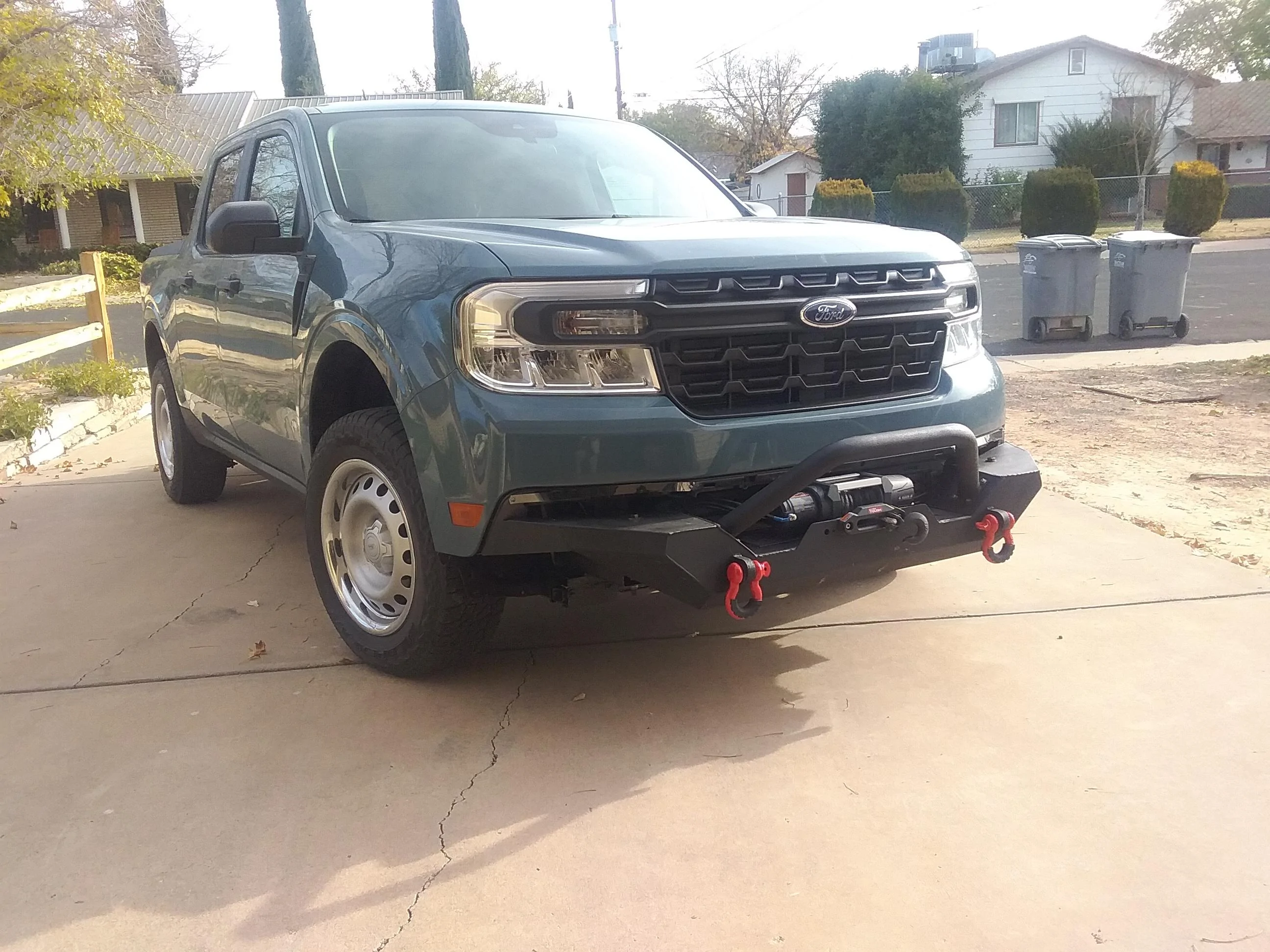

I had the same questions I used these two witching holes as the main attaching points for my winch bumper...turned down 1" bolts to snuggly fit holes, welded these to plates which sandwich this portion of chassis.
Bumper itself is a modified jeep bumper for a 90's style jeep (widely available at e-bay for about $140)

More pics please!

That's pretty cool.
In the top 5 mods on this site.
Nice.
