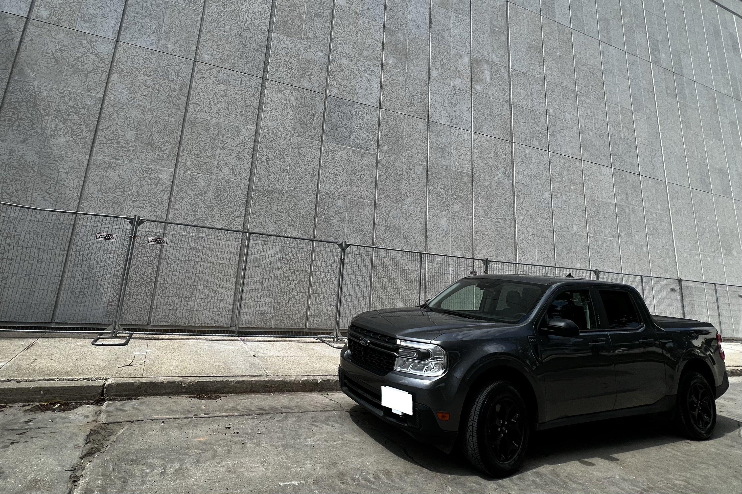

I have an XLT, tow-package carbonized grey (removed fx4 stickers)

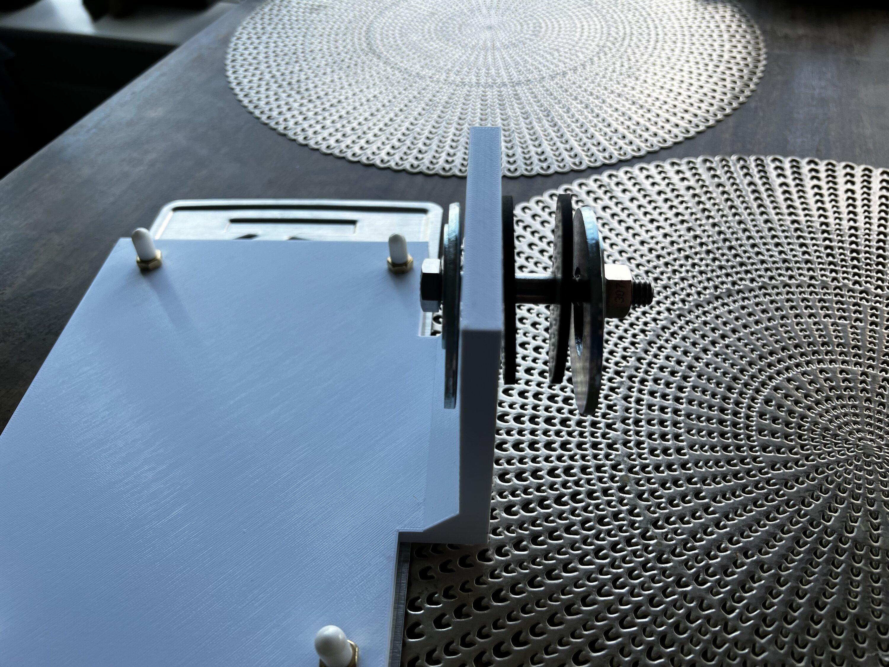

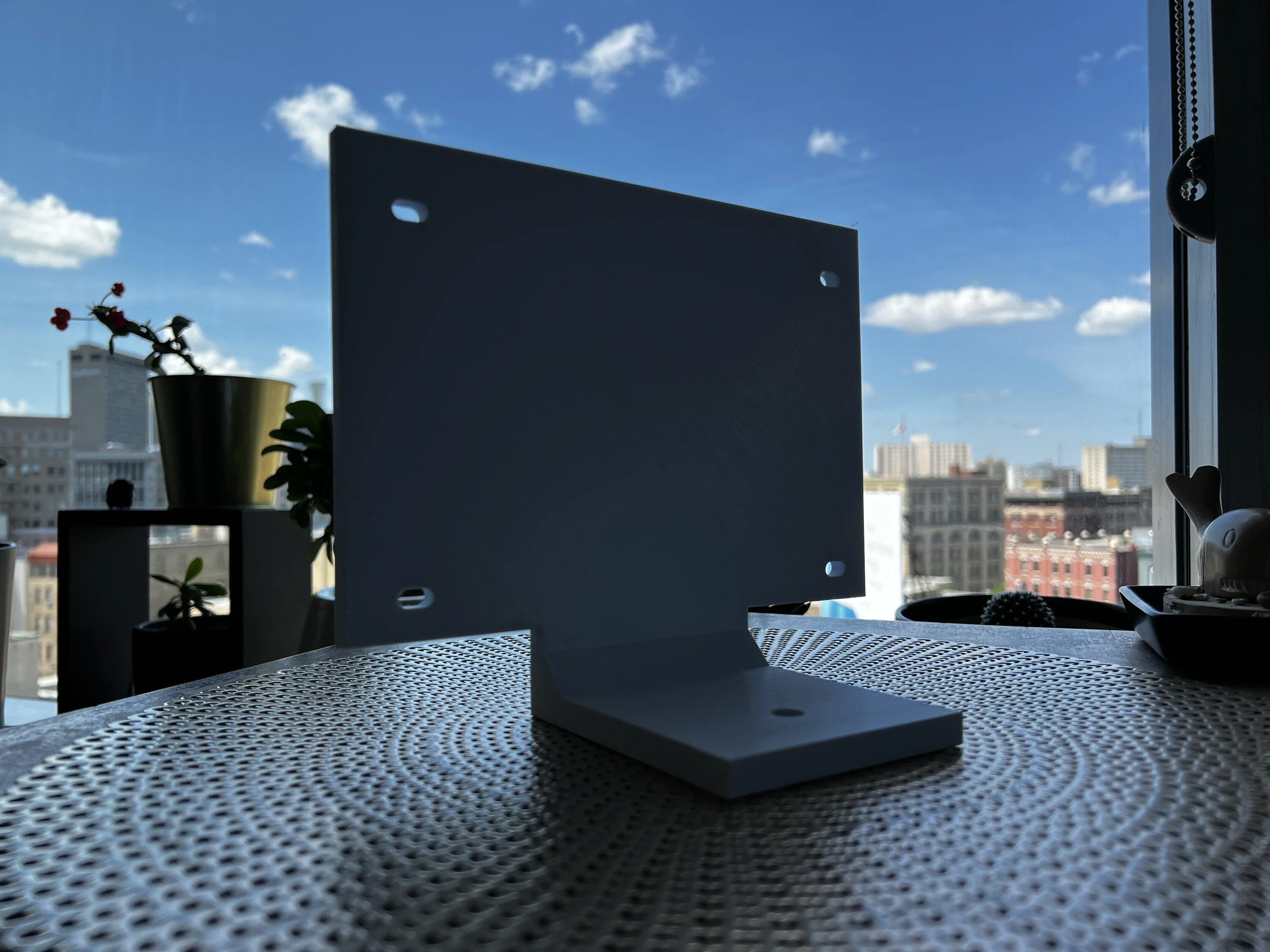

I decided to research 3d printing companies locally and found Alpha Play in Winnipeg. I put together a sample made from cardboard to meet my expected dimensions. They did they're magic and redesigned it into something that would last. I was able to buy hardware off the shelf at my local Home Hardware: 1x 40mm bolt, 1x nut, 2x large washers, 2x large rubber washers. I recommend stainless steel in order to avoid rust.

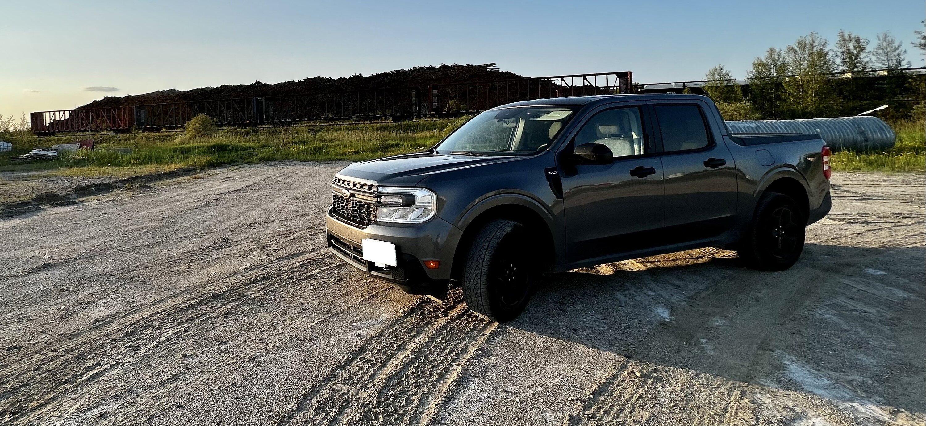

I road tested the unit on a trip from Winnipeg to Montreal and back. 5k kms without the unit requiring any care or tightening, not to mention taking direct hits from a million or so bugs en route. Very happy with how it turned out.

If any of you are interested in keeping your Mav pristene - Alpha Play has put up a link of the design they refined for me.

Does this only work with the fx4 m9dels with tow hooks, if not where does it mount up at?
lostdime10
Jul 29, 2022
Winnipeg
It only works with the tow hook models. You could contact the 3d printing company I worked with to see if they would make a grill or lower bumper version. They were great to work with. I’ve seen JDM mounts for the f-150 that hooks to the grill - you could use that as a base plan
