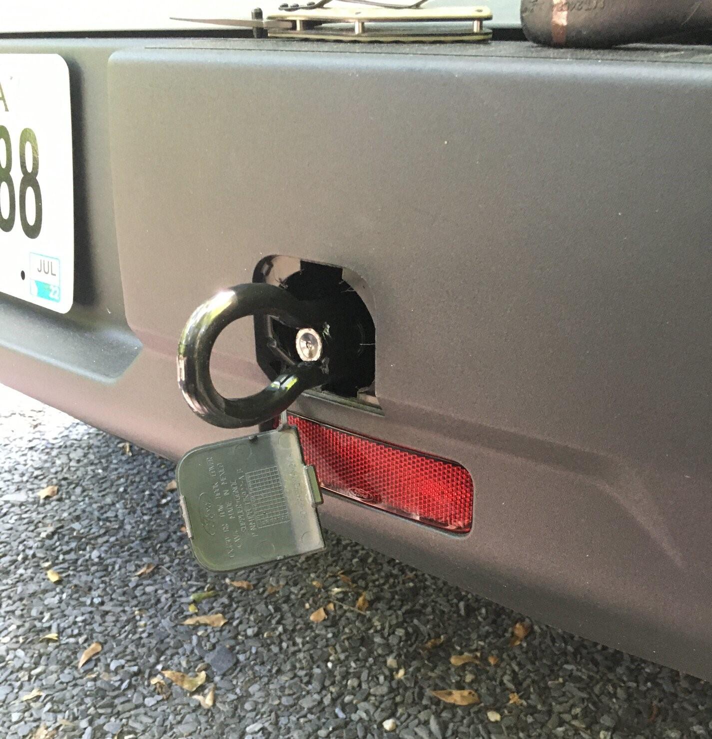

Exactly. On non-hitch equipped Bronco Sports, they have a plate covering a threaded hole for a recovery hook to thread into. I'd like to see this feature on the front of non-FX4/Tremor AWD models.

Ford Maverick Front tow hook would be nice Bronco Sport rear recovery hook

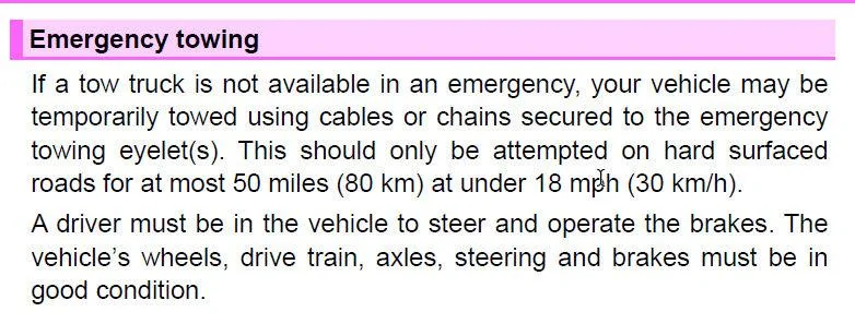

Interesting what some expect from a vehicle that was never designed for off road, one look at the front bumper tells you that. Sure there are 2 softroad options with minimal recovery equipment. Same is true of the Sport with only one version actually advertised as off road capable.
Ford is not alone in this regard as even the vaunted 4Runner (with a frame BTW), even the TRD version, only has one minimal and unrated "emergency recovery point". From the owners manual -
Ford Maverick Front tow hook would be nice TRDTowing
"This should only be attempted on hard surface roads" is the punch line.
There is a whole small industry for add on tow hooks for the 4Runner no thanks to Toyota who does not recommend them.
