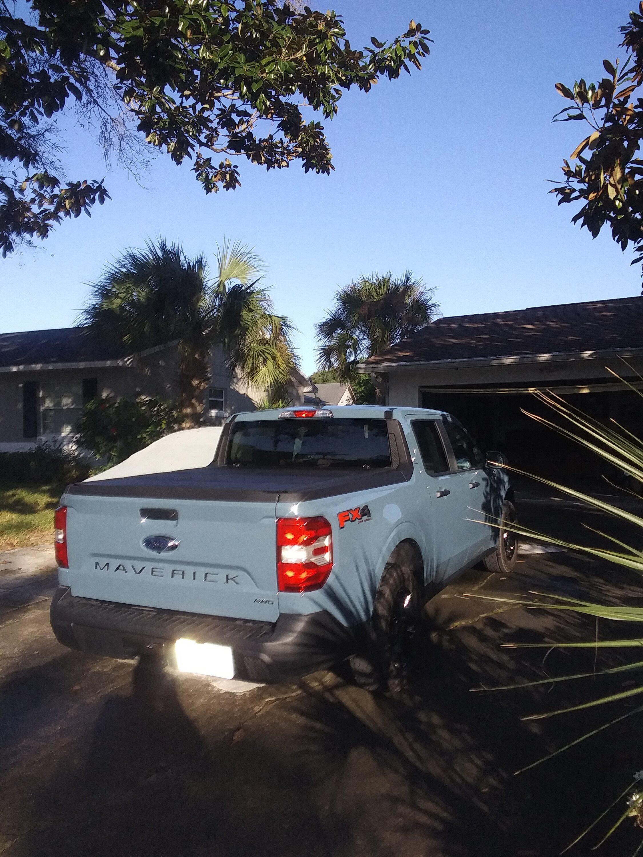

I personally believe any mpg savings of drag resistance is off set by the weight addition of the tonneau cover . at least in my case . I have undercover armor tonneau . mpg remains the same for me in city and on highway . I Like it's utility and security .

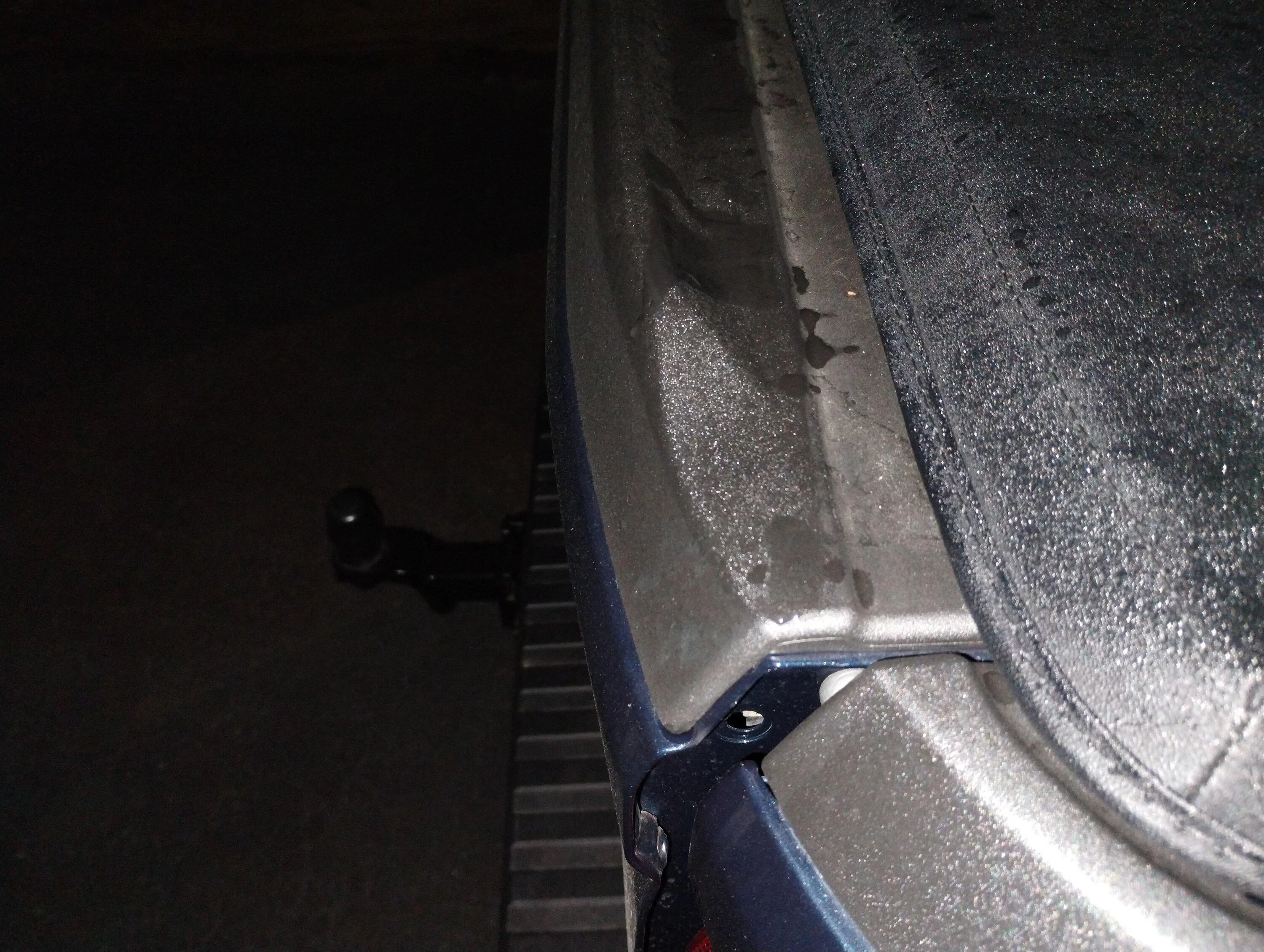

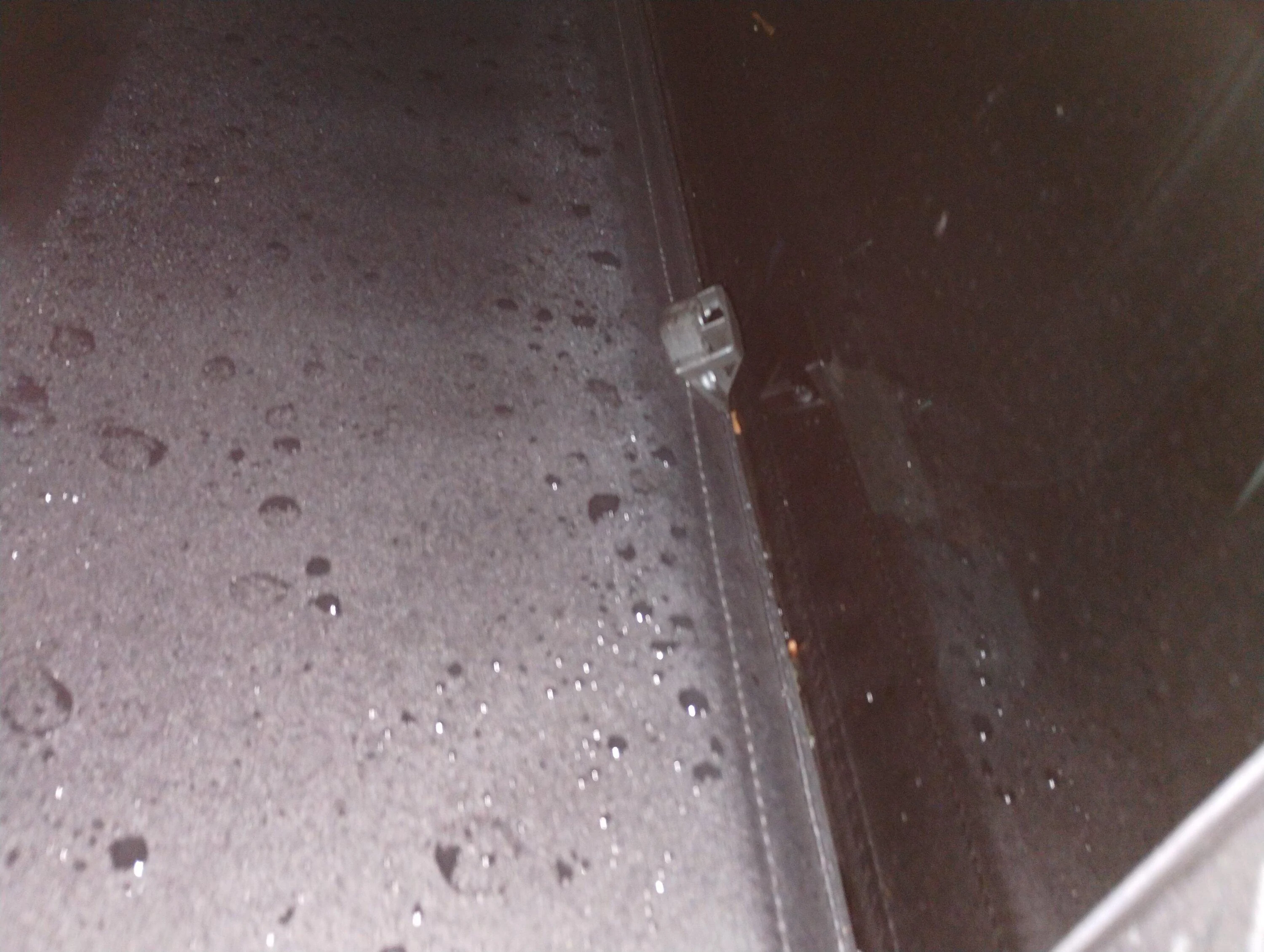

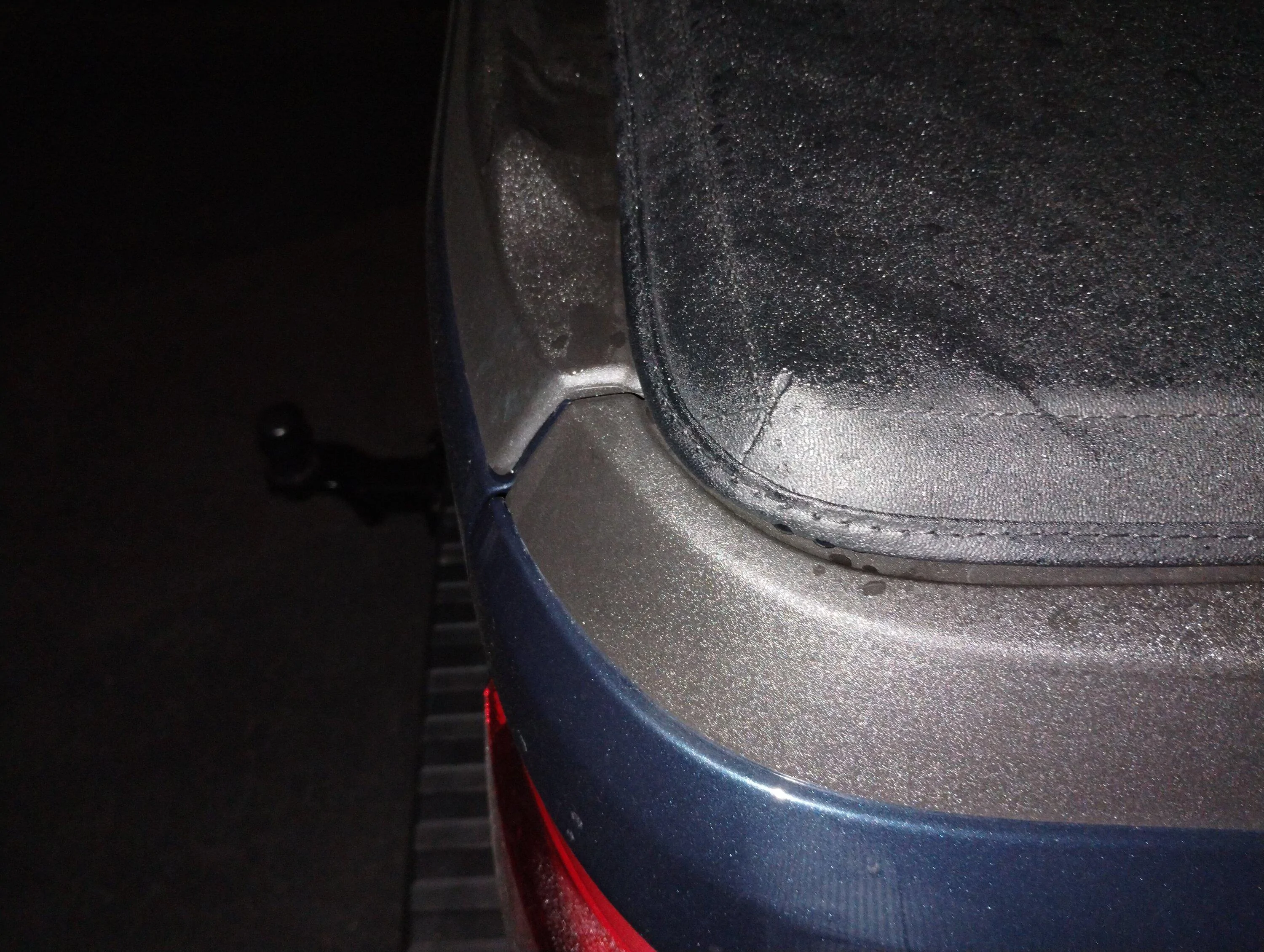

My cover does not go nearly that far back. If I have mine all the way to the window, there is a gap at the tailgate. Looking at it from underneath, I can have either the front seal touching the bed or the back seal touching the tailgate but not both. This is consistent with the 3 or 4 covers I have seen in person as well as about a dozen or so posts on this forum. Yours is the longest I have seen. When was yours built? I wonder if this is an issue that has been fixed and I just got an old stock?
