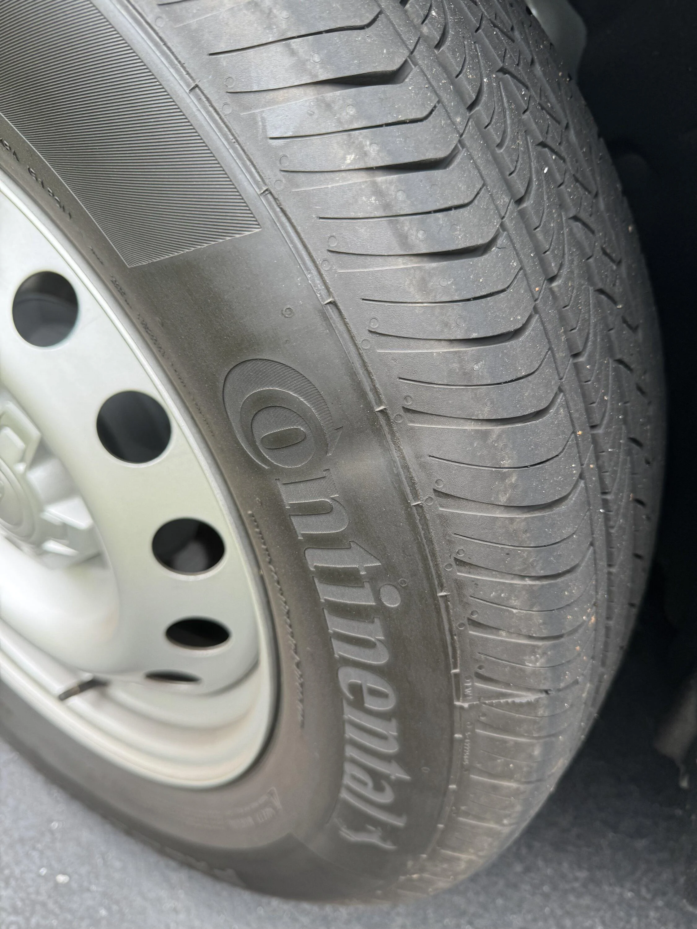

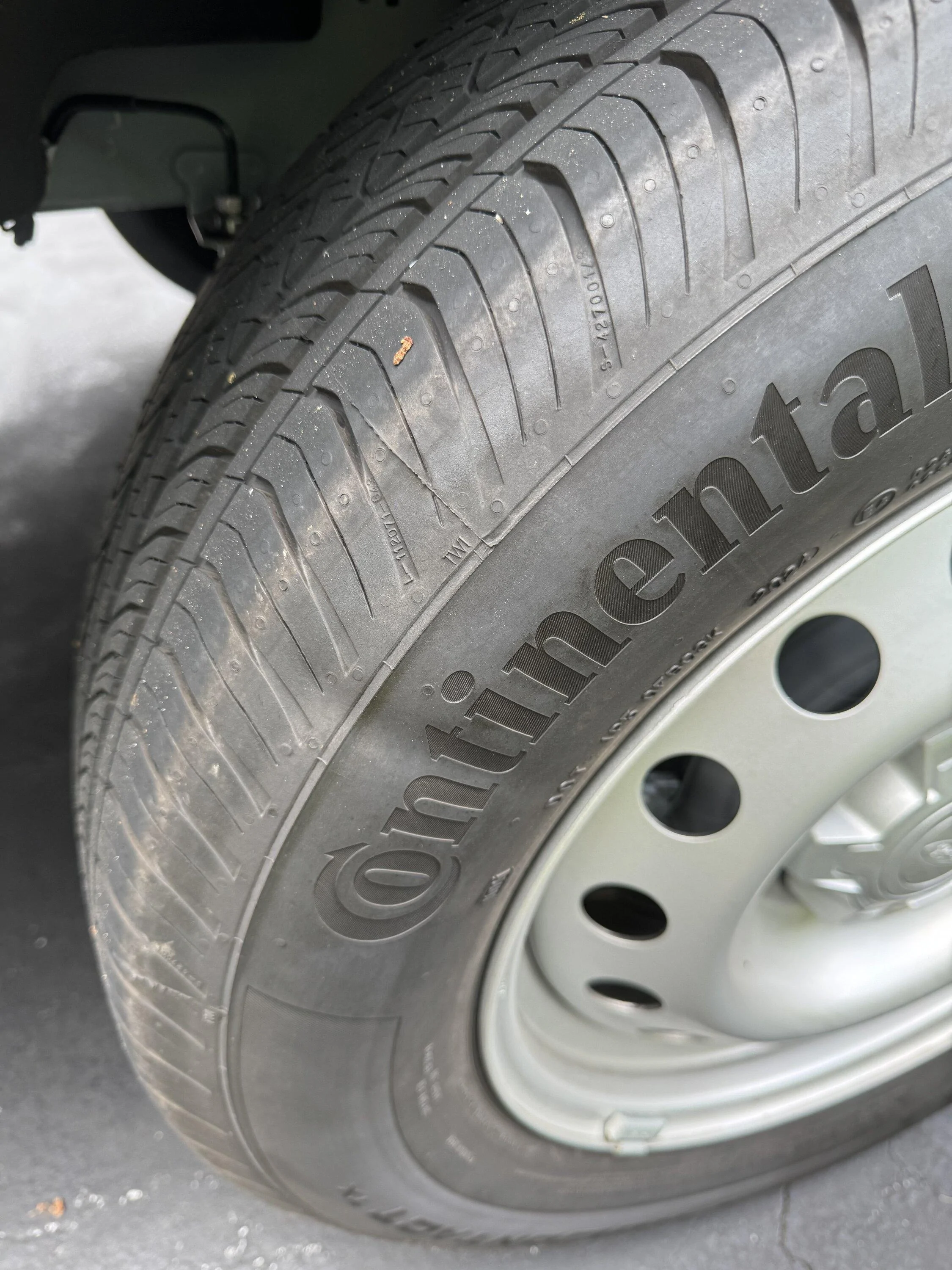

Tires problem, just realized today. 6/30

Normal, although it doesn't look it...
Watch to make sure that the tires are blowed out on the rims all the way . There is a little bead by the rim that should be the same all the way around the rim. I had a F150 with Goodyears on it that we tried to balance 4 times till a tire technician caught that all 4 tires were not blown out on the rims right.
No balance issues, just the dimple from the manufacturing process.

FIY about the appearance:
SSM 51381 2021-2023 Various Vehicles - Tire Sidewall Wavy/Indentation Appearance
Some 2021-2023 Ford and Lincoln vehicles may experience a tire sidewall wavy/indentation appearance in the radial direction on one or both sidewalls. Sidewall wavy/indentation appearance is a common cosmetic characteristic of radial tire construction and will not affect the performance of the tire.
Mine look the same as yours.
