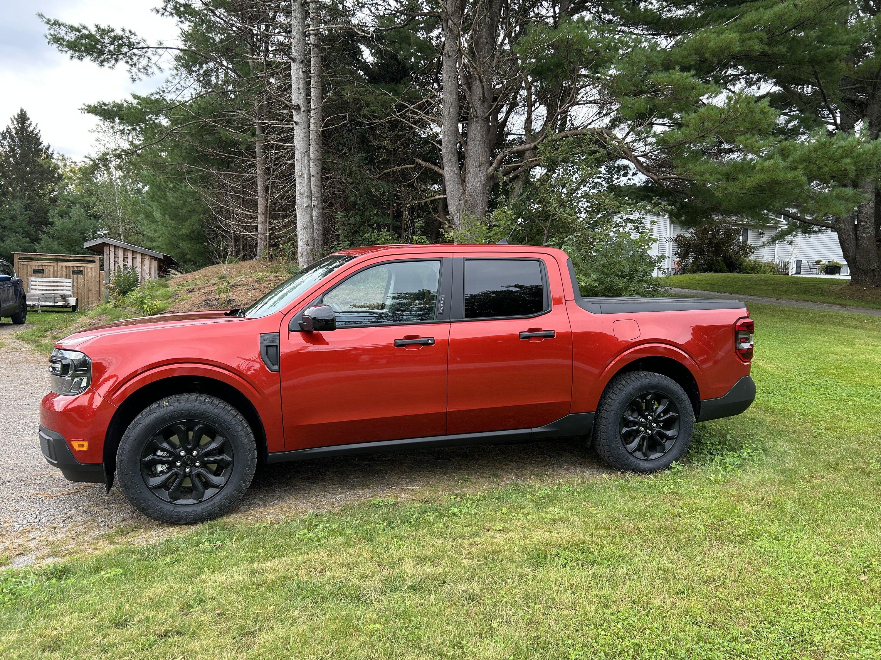

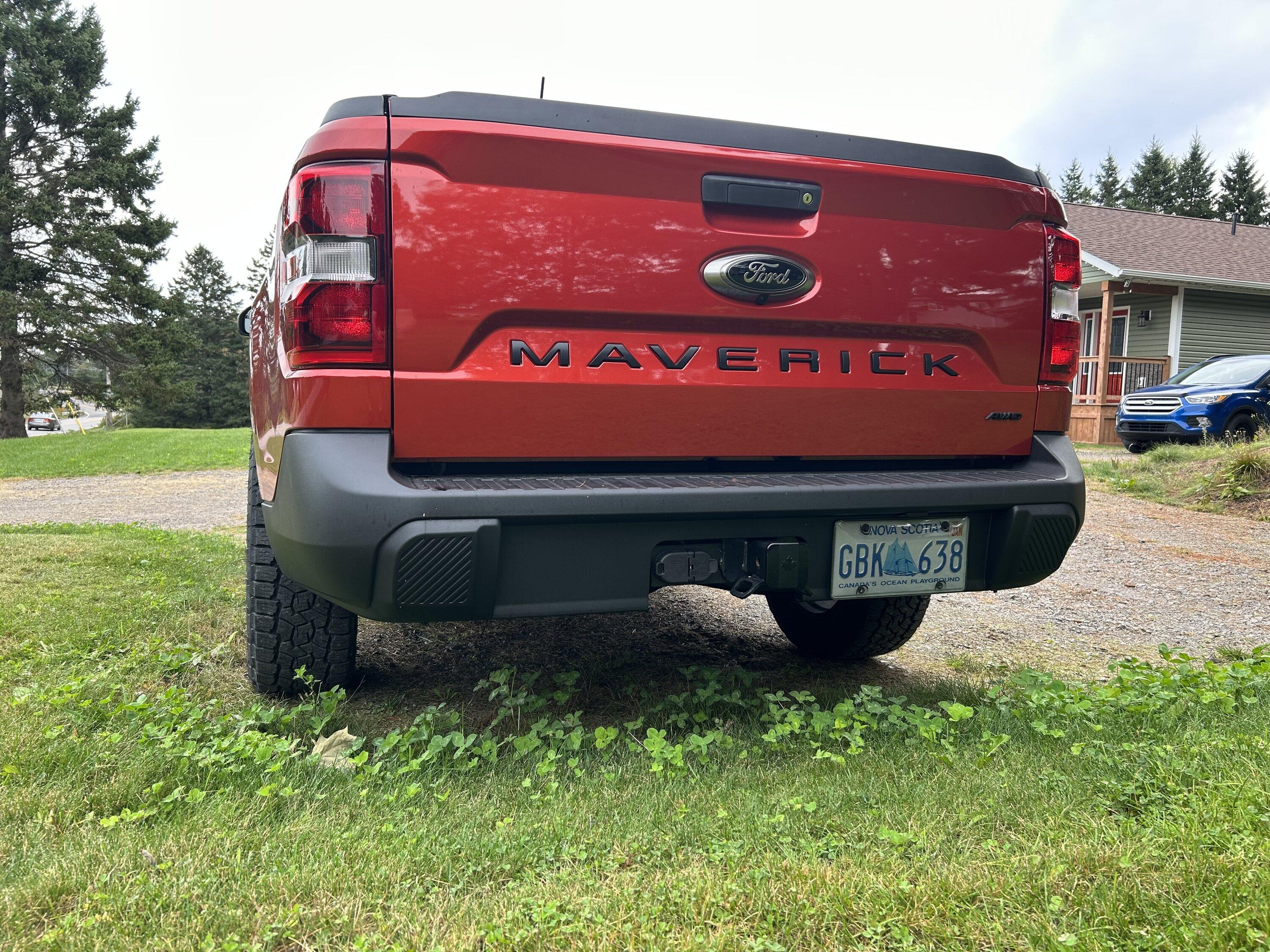

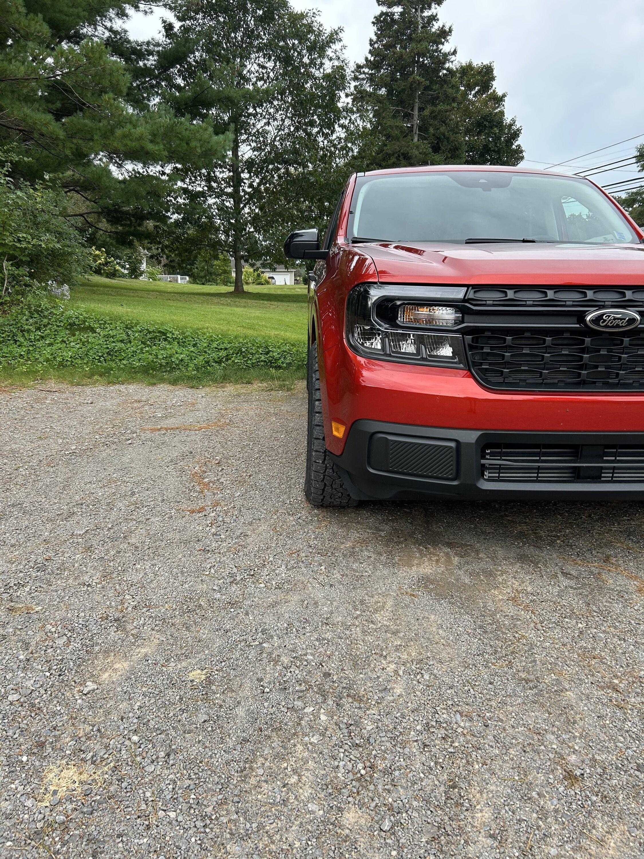

They will fit perfectly with no modification or lift. This is a 245/60/18 Toyo.

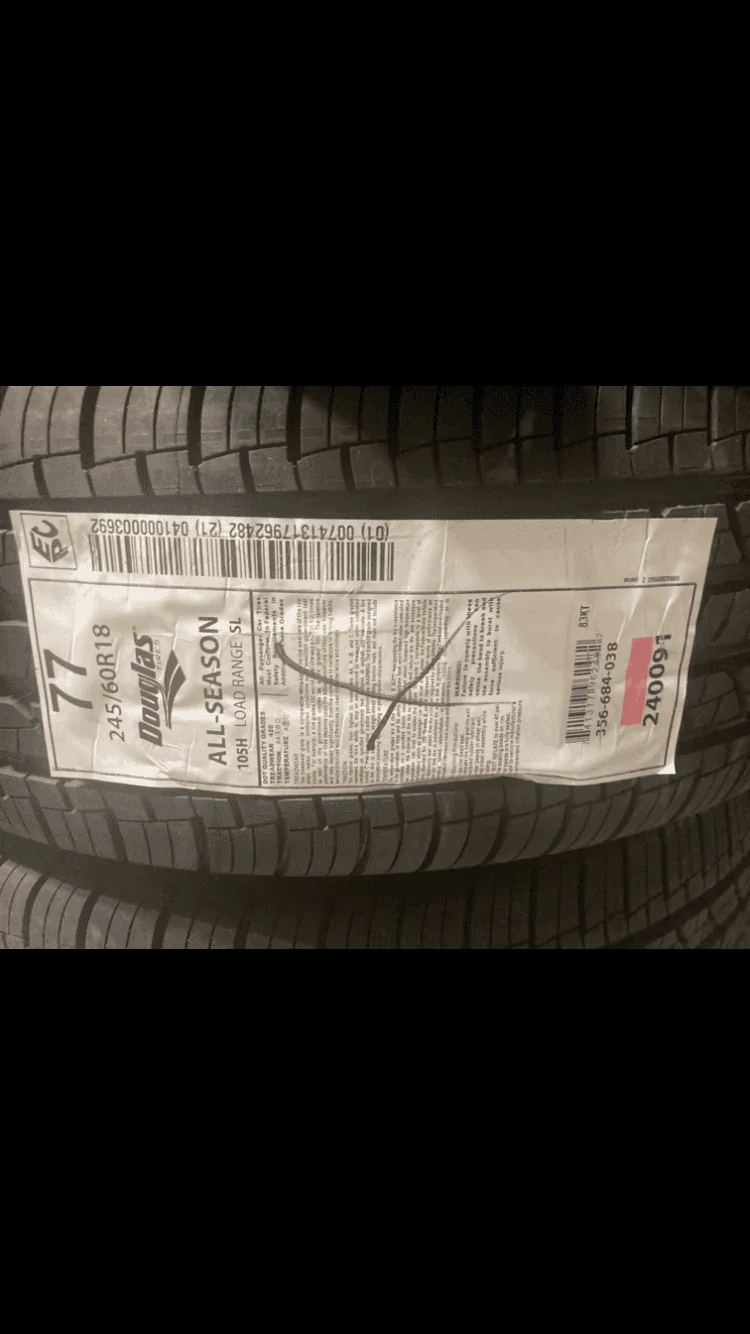

Don't buy Douglas brand tires. I have them on my Focus and they hydroplane quite easily. On dry pavement I spin the front tires without trying to. They are okay when brand new but at 1/2 tread mine started to spin quite easy in water streaming across the road. I have to remember to lift off the throttle when encountering big puddles and water gushing across the road. I will go with Mastercraft tires the next time.
Fyi Mastercraft tire was made by Cooper tire co. Cooper tire Co has been purchased by Goodyear co.

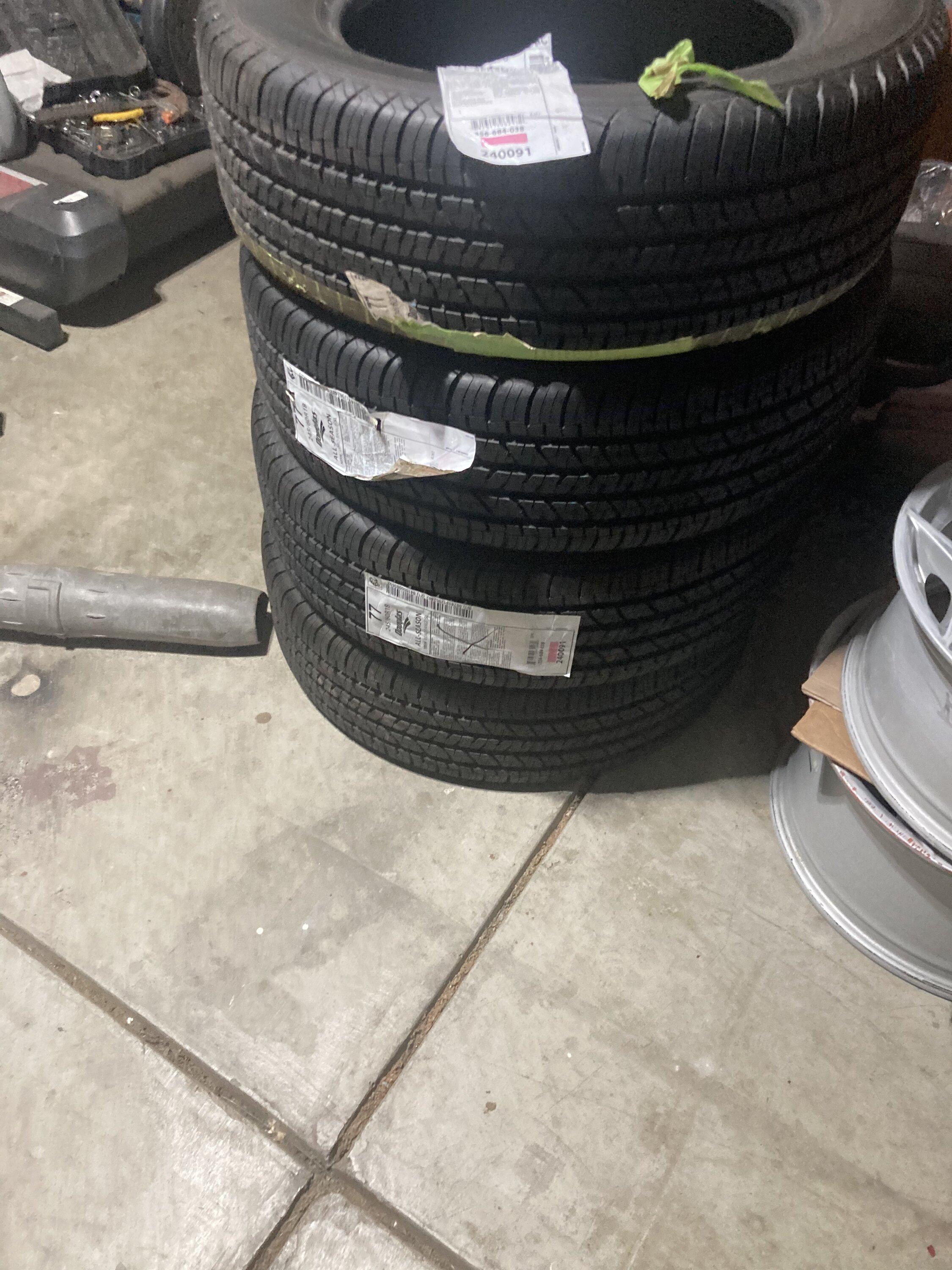

Thank you so much for your answer only reason I got them cause they where $250 for all thank you again I am always lookin for sales lol
Keep us posted as to how they hold up over time and distance?

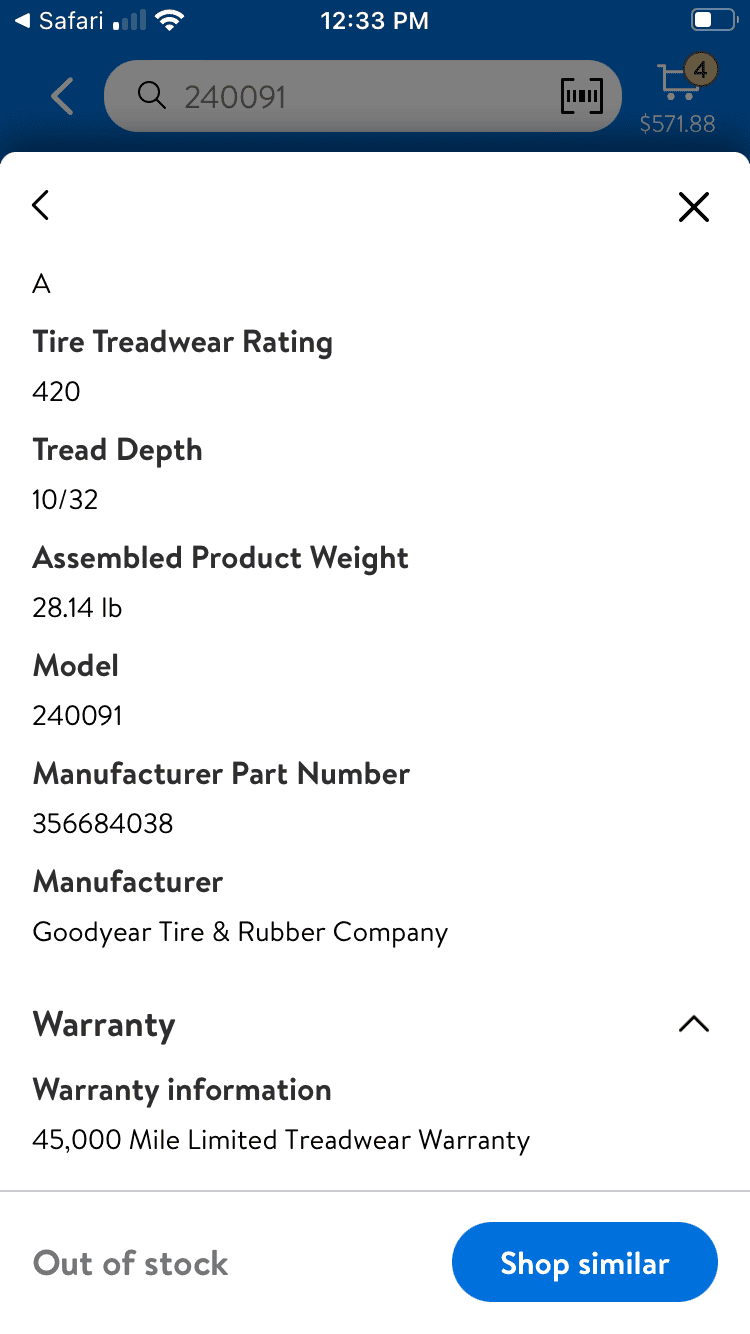

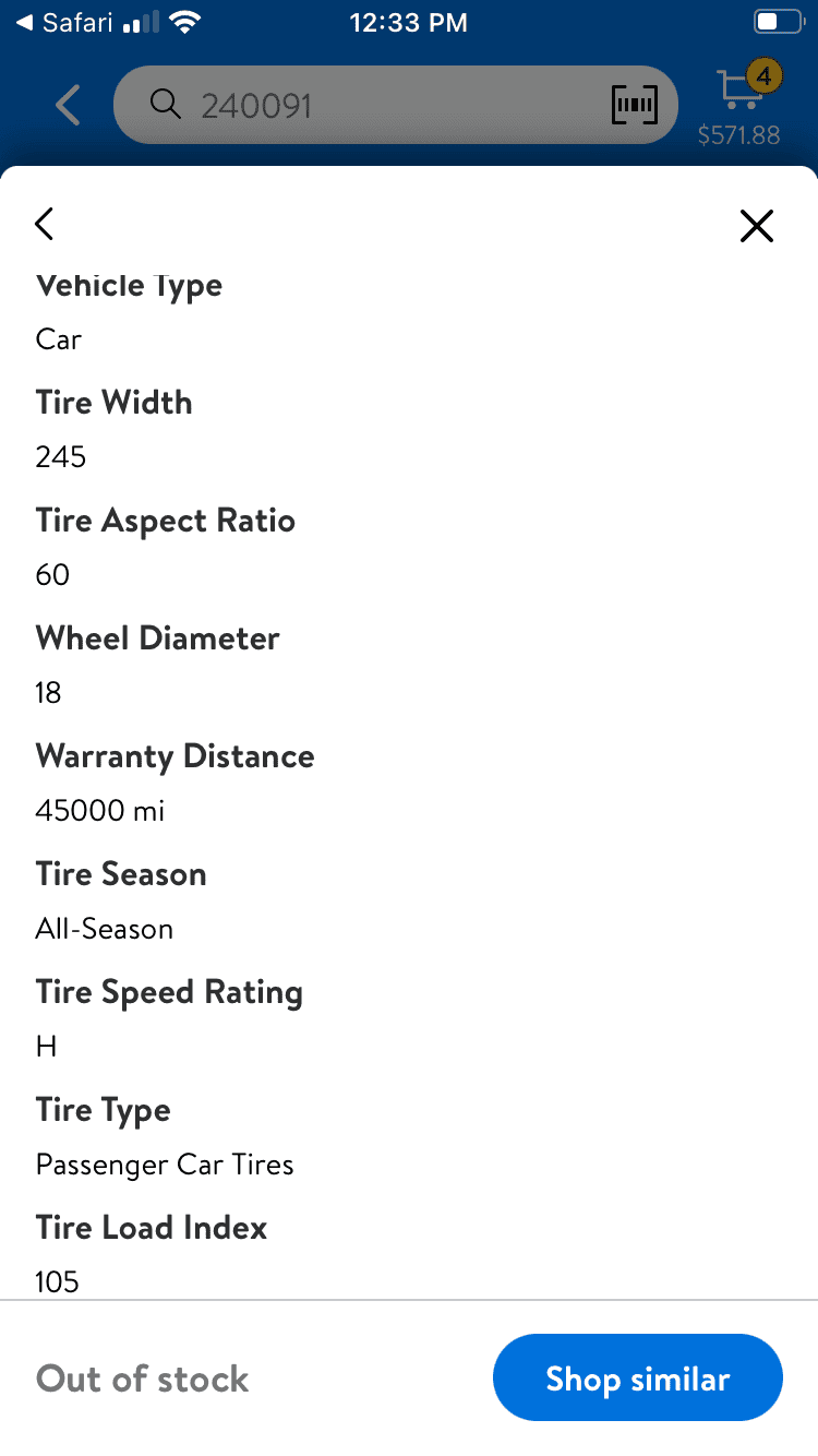

Hi everyone I run to this deal at Walmart will this tire be ok on my maverick I ask Walmart employee he said it’s ok I want to check here before I decide to install on my maverick thank you
Just out of curiosity, I always like to look at the manufacture date on the tire. Not that there is anything we can do about it, but it is nice to know if the tire has been sitting for 2 years or 2 weeks. Hopefully, all four have the same manufacture week.
Good to hear the 245 fits just fine on a mav with no lift. I’m planning on putting a set of 245/55r18 on mine as soon as my original tires wear out. I’m going with 245/55 r18 as the 55 profile won’t change the circumference of the tire so the speedo and odometer are still accurate. A 245/60r18 would be just over a 3% change in speedo and odometer. That would mean if speedo showed 70 you’d really be doing 72 and a tad. And odometer and mpg would be off by same 3%. If you drove 100 miles you really traveled 103 mile and if you calculated the mpg by using odometer readings or computer a 30mpg would really be 31 mpg.
