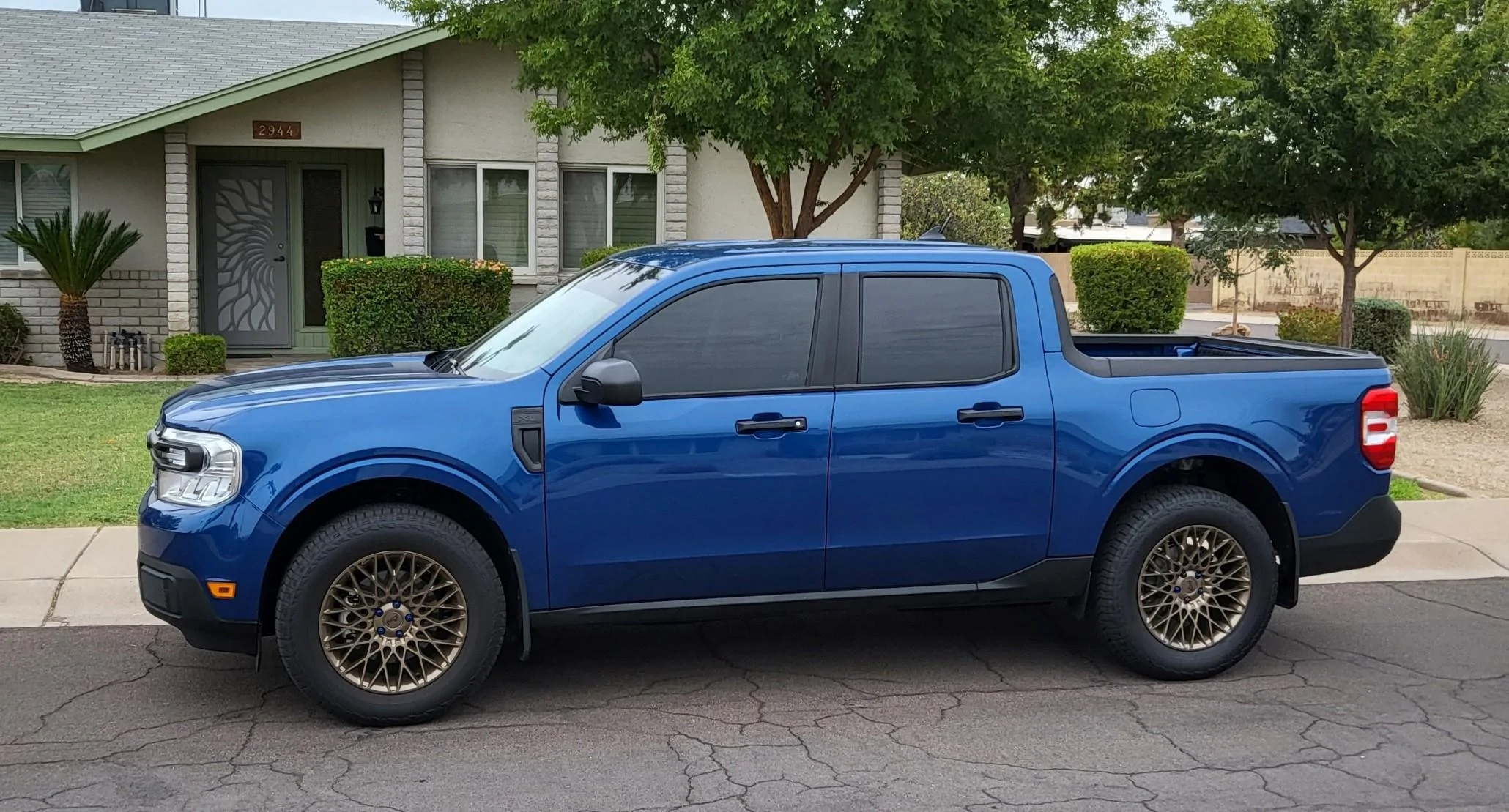

Any TPM with 315 mhz will work, I got these for $18.00 and they work:
https://www.ebay.com/itm/335180651727 (no programing needed)
I also answered your original question about tire size on Facebook.
265/60/18 on my stock suspension

they will work, you need 14mm lug nuts (not the 12.5 mm)
Nice thank you where I can can find some black ones
will they be 14mmx1.5 ? Thank you

These are only $21.00 but the head is 3/4" (different than factory lug nuts)So you will need a different lug wrench to carry in the truck. or you can paint your factory lug nuts.
https://www.ebay.com/itm/384752452326
There is info in here about my window tint and some other mods that may interest you:
https://www.mavericktruckclub.com/f...ud-flaps-budget-bed-mat-other-upgrades.32650/

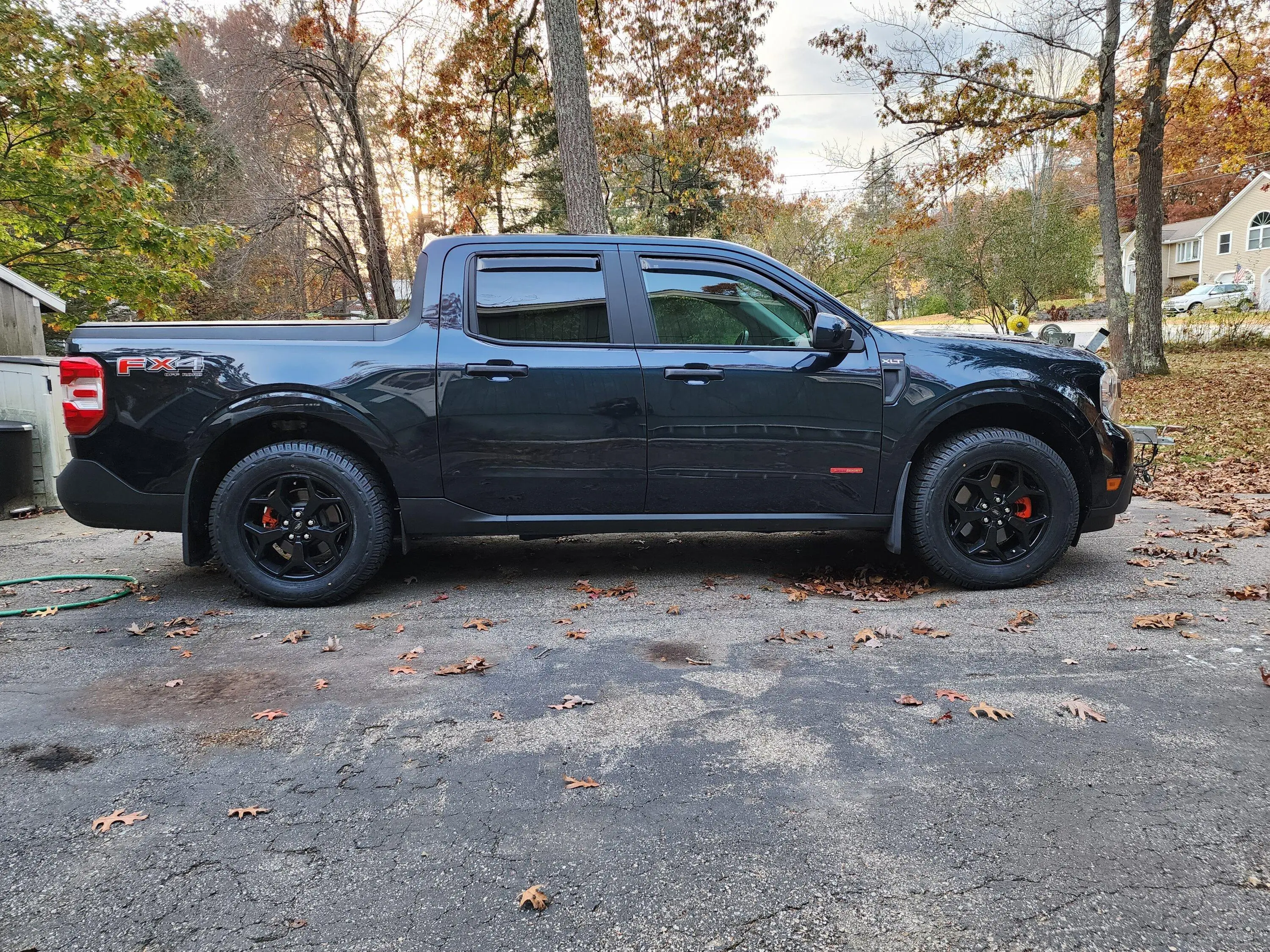

I just installed 245 65 17 on my xlt 4k from a 225 65 17. I lost gas mileage and final gear ratio. Can definitely feel it in the seat of the pants and towing. I pull just about 4k. I'm going back to a short tire next spring. Although the all terrain tires are great in the snow vs the stock tires.
Ford Maverick TIRES FIT MY MAVERICK? 20231101_163958
