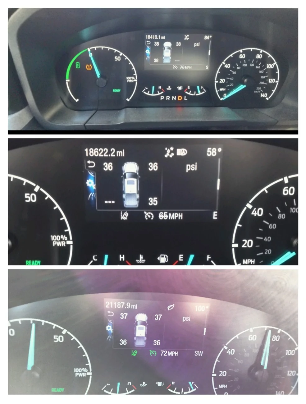

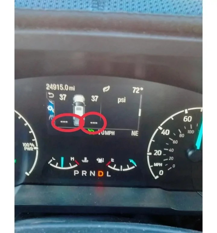

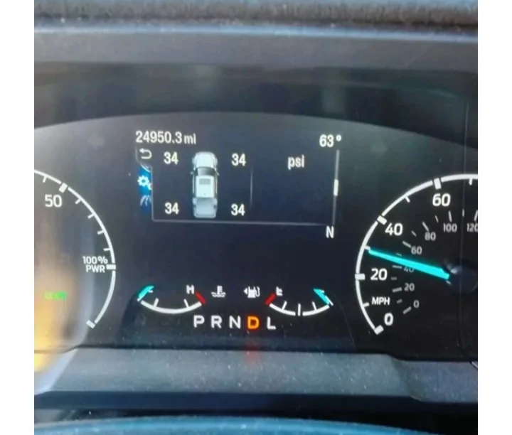

I guess I'm lucky. Not quite a real inconvenience for me. Part of something I've gotten used to owning a Maverick.
When my sensors go out they always come back on within 20-50 miles. They ALWAYS come back on and show the correct pressure. I'm convinced the majority of these incidences with the Maverick is not the sensors themselves but something in the truck. Hopefully the dealership that you have your truck at will actually show you what was wrong and you can update us.
Here's one example👇I have more.
Ford Maverick Tire pressure sensor fault 20260713_082110
Ford Maverick Tire pressure sensor fault 20260713_082203
I'll post another picture of a different location. If I can find it.
I've had a driver side left go out but come right back.
