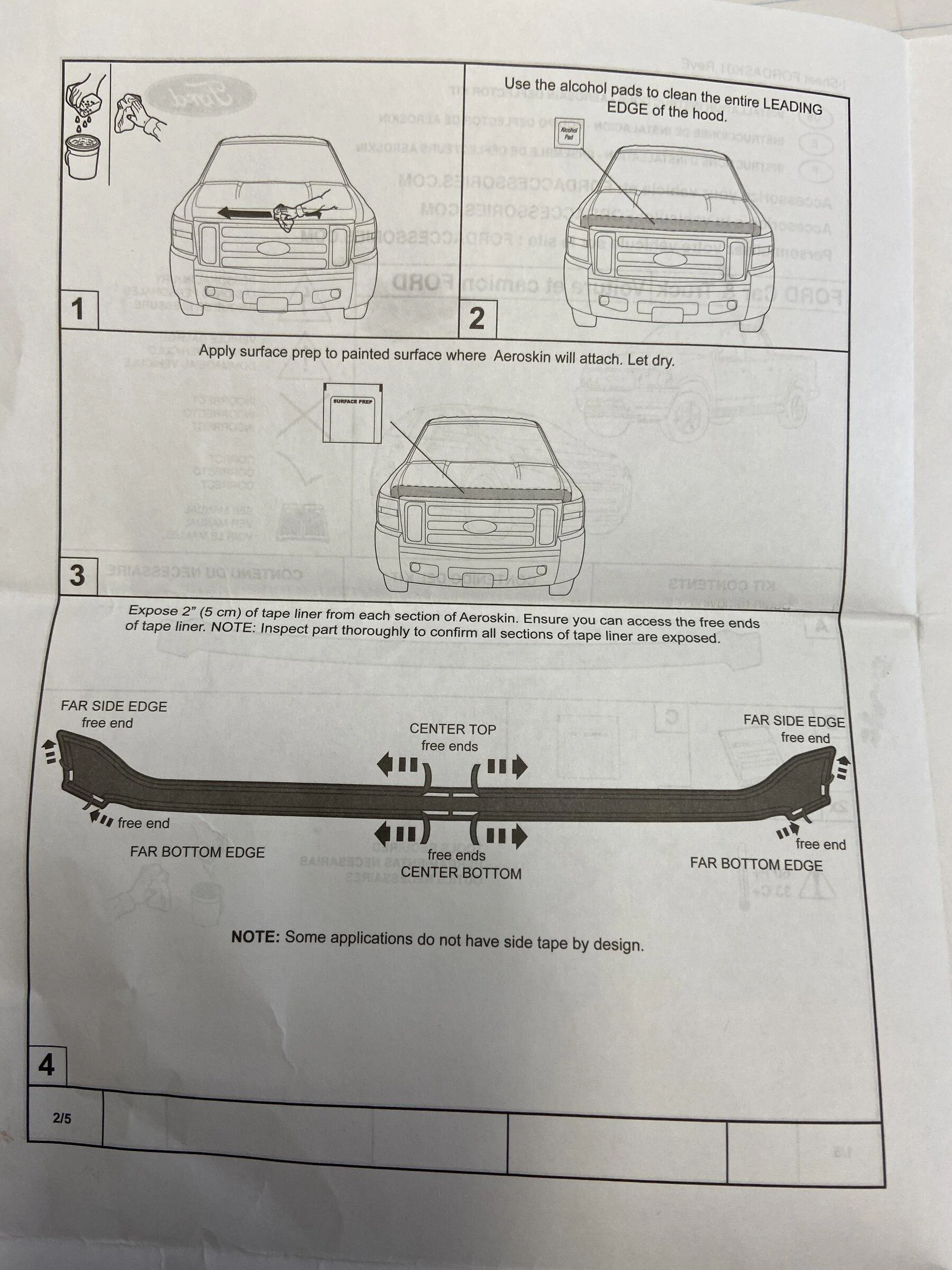

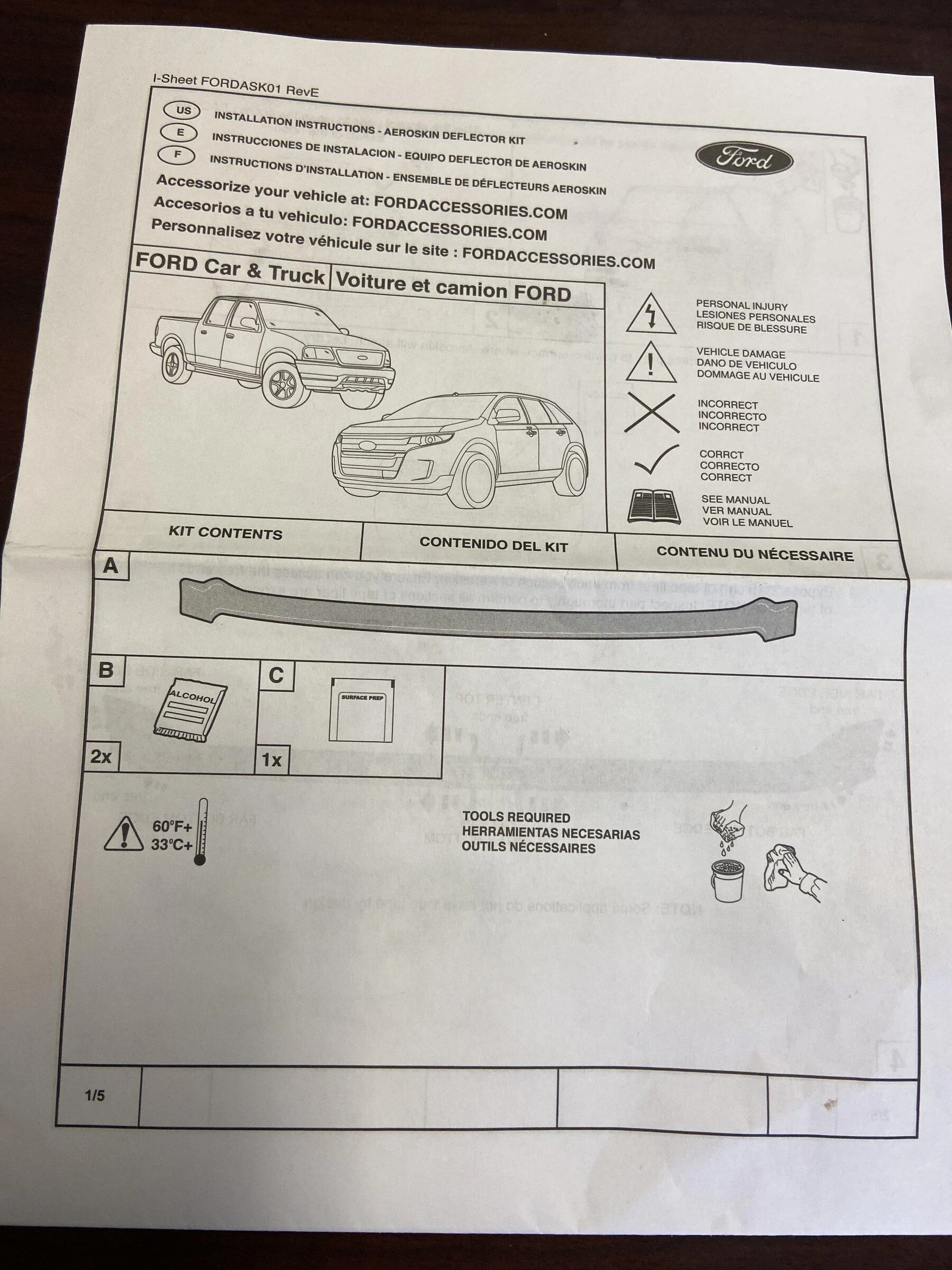

I took delivery on my Maverick on St. Patrick’s Day, and I love it. I’ve spent some extra cash tricking it out with a tonneau cover, mud flaps, etc.
I also purchased the “official” Ford factory hood deflector shield and installed two nights ago.
Lessons learned to pass along:
1. When pulling the red adhesive tape back prior to the initial install, use some scotch tape to hold back the red tape. I had the misfortune of having one of red tape pieces get tucked under the deflector while making the initial placement on the hood. Reaching under the deflector to retrieve the end of the trap is very tricky at this point.
2. I also quickly learned at this point the plastic shield has sharp edges. See photo below for my cut index finger. Luckily I had some clean paper towels with me to serve as a bandage. Luckily the bleeding wasn’t too bad, and I managed to complete the installation.
Overall I would give myself a B- on the installation. Considering my mistake with the tape and my cut finger it could have turned out much worse.
Hope my experience is helpful….
