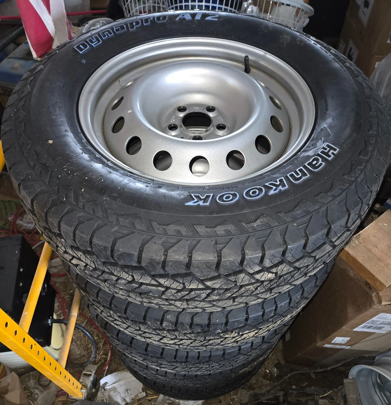

235/75R17 Hankook AT2
Ford Maverick Thoughts on 225/75r17 20250119_140959
