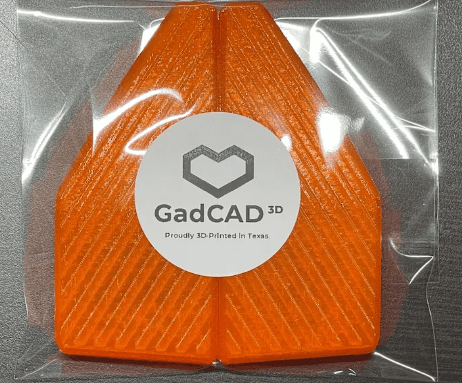

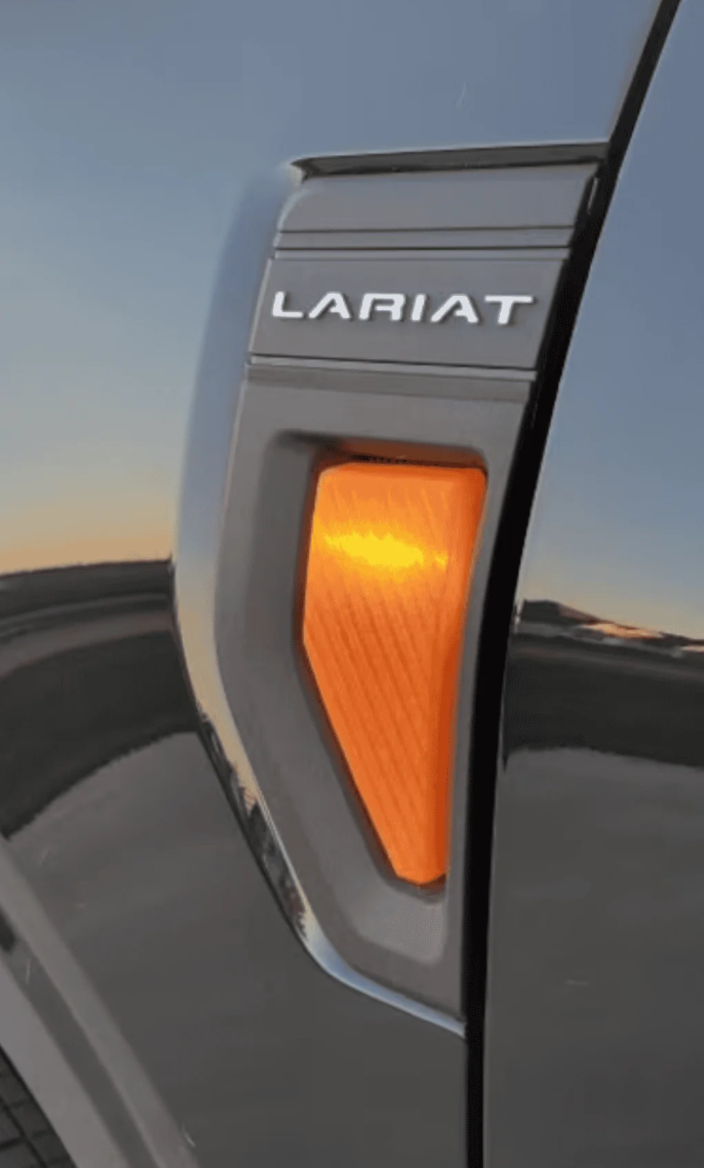

Found these on Etsy. Simply light housings from a cad print with no lights or wires. DIY. They're a little too orange but I think I'm going to use them anyway.
