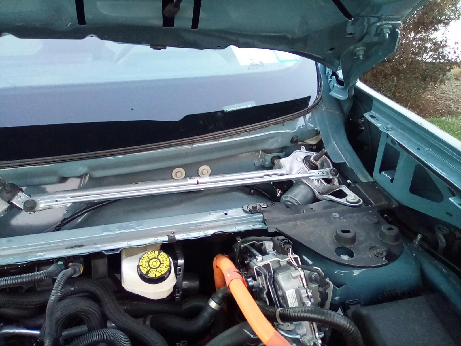

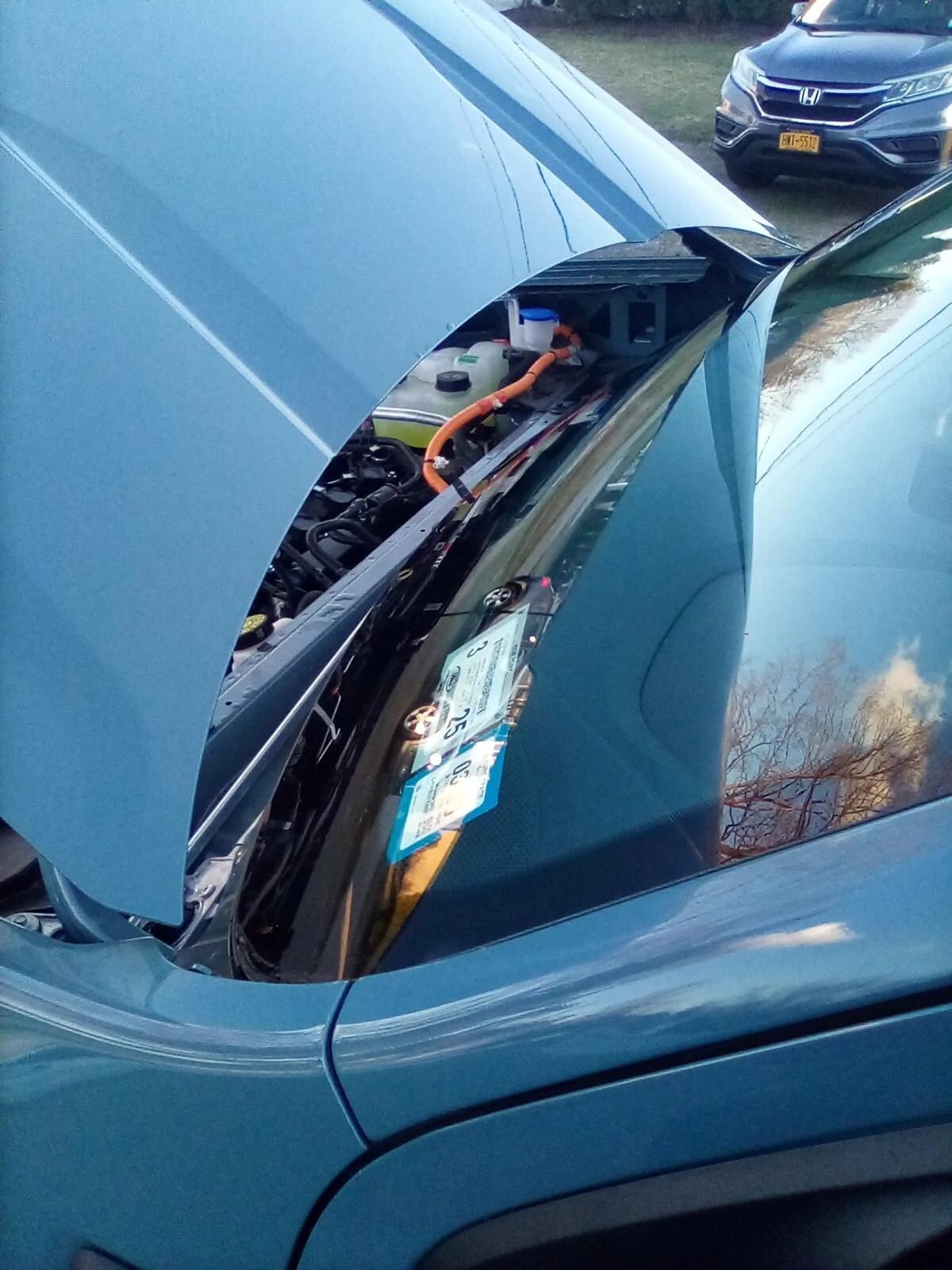

I usually remove the cowl when I am having a windshield replaced. I find the mobile glass guys are good but always in a bit of a rush. My son's Honda Civic had the windshield replaced the week before my Mav windshield. I didn't have time to remove the Civic cowl and of course a couple of clips weren't reinstalled!
The Mav cowl snaps into the plastic groove on the windshield firmly.

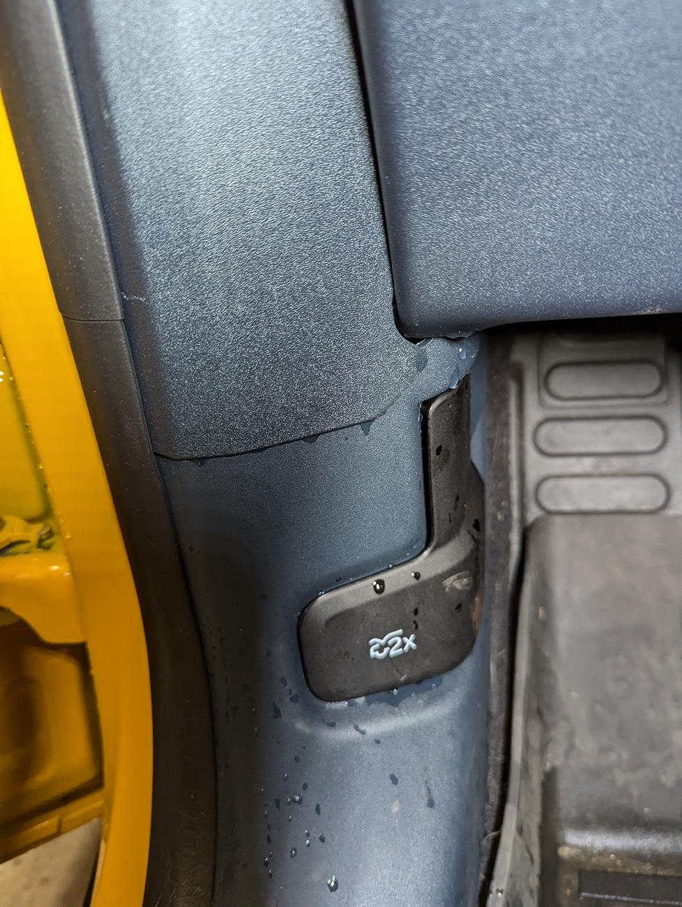

Safelite replaced my windshield a few weeks ago and today in the rain I noticed a puddle developing in the driver footwell. What process did you need to go through to get them to address the issues? I hesitate to just go directly to them since I had issues with them also chipping the paint and saying their tools couldn't do that....until I provided photo evidence.

I poured some water on the windshield and noticed the dripping from the seam on the left where 2 plastic trims overlap.

A call for warranty should take care of it. Your leak is probably where the glue seal ends meet. That's the leak I noticed and it wasn't "the big one" I had.

I had Safelite sent a different tech out from a different location to address my leaks. He had indicated the previous tech didn't do a very good job sealing everything but he was very confident that I wouldn't have anymore issues.
I washed the car with a pressure washer yesterday and no signs of water inside.

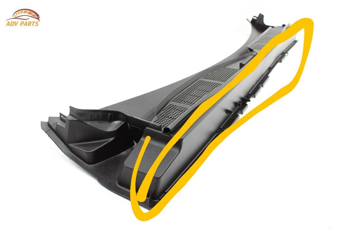

Has anyone ever considered modifying this part of the panel to vent the engine bay for heat extraction? Is there a downside to this that should be considered?

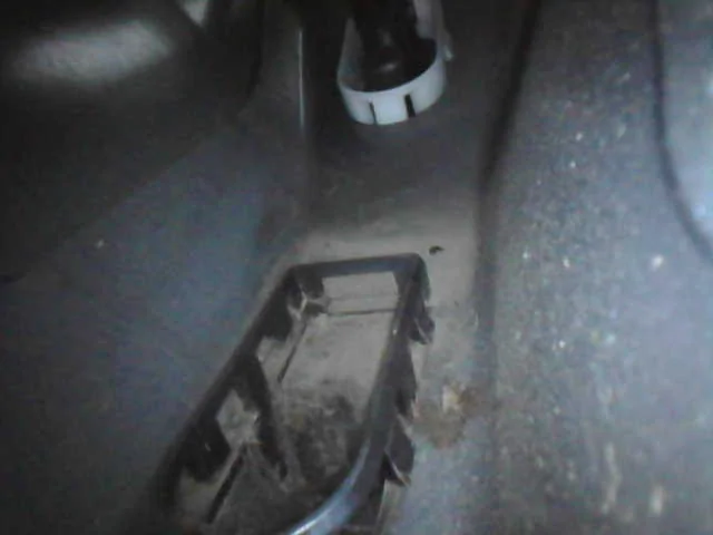

Where is the harness plug and leak into the interior by running down the firewall on the inside?
this is were mine is leaking

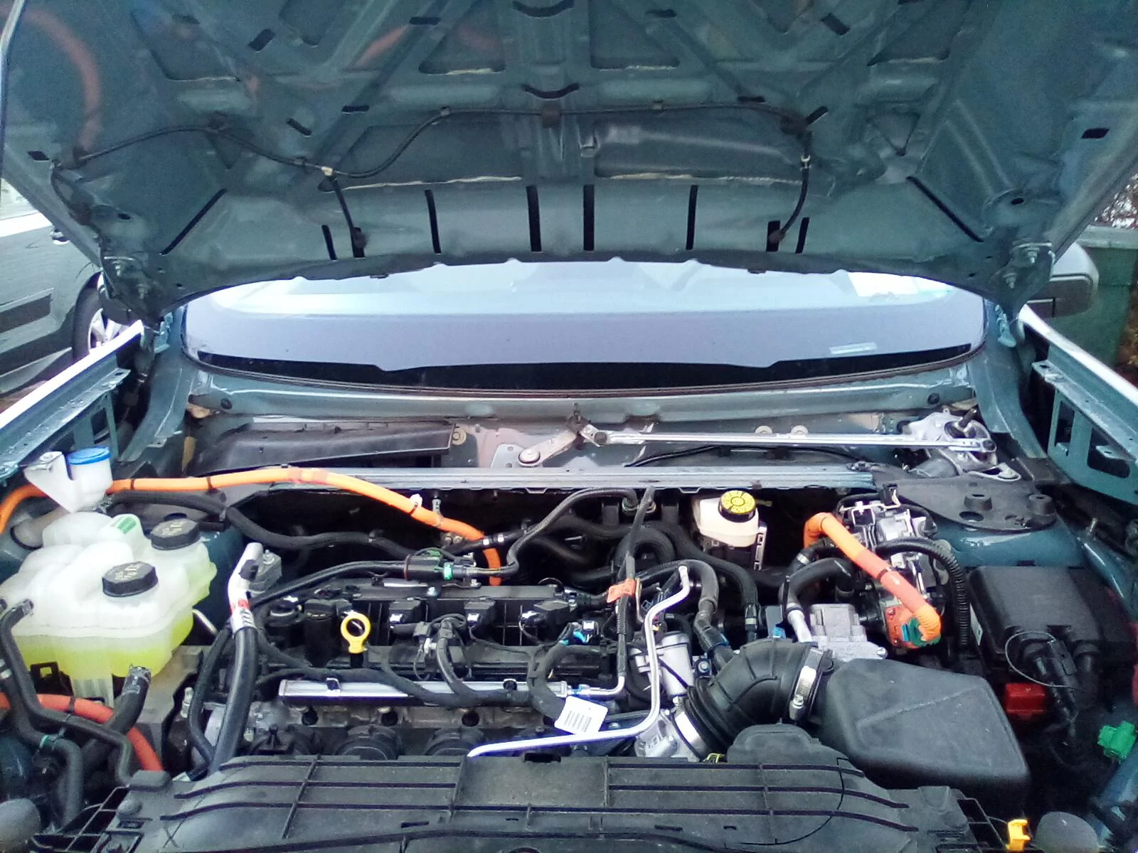

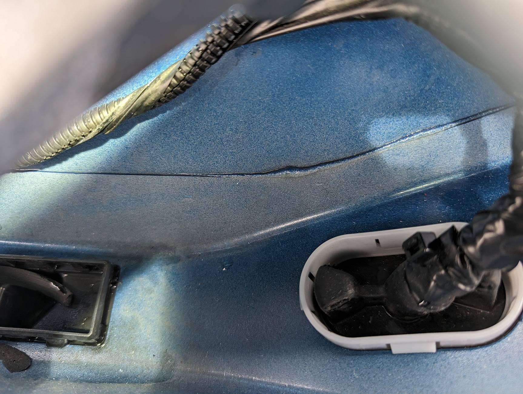

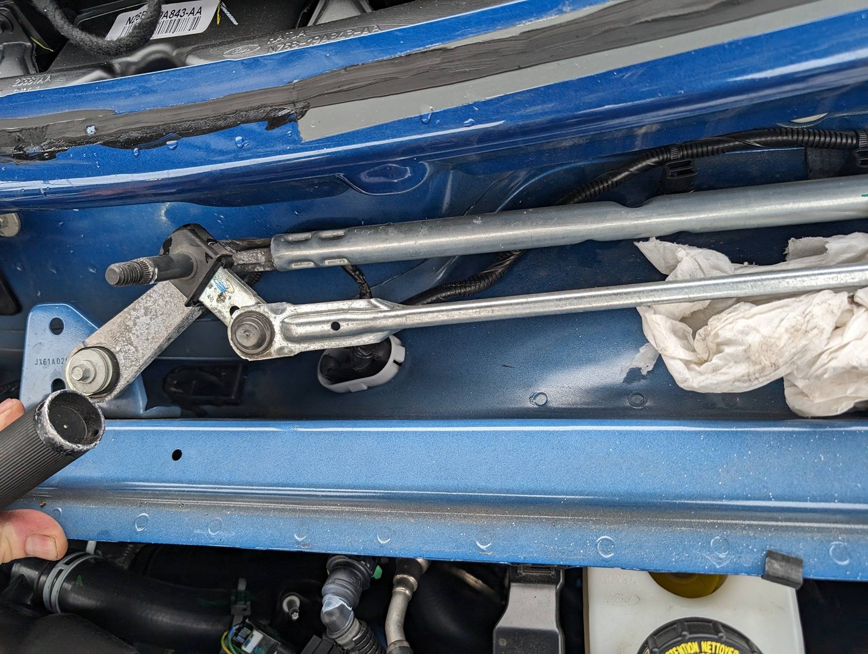

Another poster has pics, you can see a black harness under the wiper arms in the main shot of the area with the cowl removed. This was taken during the leak repair, the windshield is removed and you can see the sealant. Edit: the harness plug is white, the drain is the black on the left.

I could just see(borescope) that drain and grommet from the air intake with the filter out.
I have a new ‘25 Lobo and was thinking same thing. That big gap between the windshield and hood is like a big cowl hood scoop.
Although the AC and Heater might draw air through those top vents? Would not want to mix hot engine bay heat into the mix. You go first and let me know before I drill any holes in mine:)
If the interest is venting heat out from under the hood. I see Ford has the side vents in the parts catalog now that replaces those black plastic filler fake vents. That may move some air out from under the hood. I didn't poke around to look at them too closely however.
