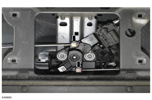

Starting a different thread for this problem. 2350 miles and this am the tailgate won’t release. Worked fine till now. After taking 8 screws out of access panel immediately saw problem. There are 2 thin metal rods on a cam that when rotated (pull handle up) pull left and right to release locks on both sides. Lots of slop in operation. First notice that one rod had more threads exposed from the CHEAP plastic holder than the other. In my case the left rod was too long and wouldn’t pull enough to loosen the lock. So I unlatched did I say CHEAP HOLDER GRIPPING the rod (it is not thread, just pinched) and shortened it a few threads. Works for now.

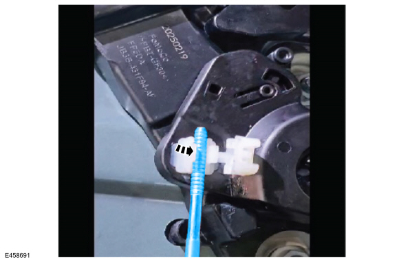

1. Disconnect both tailgate latch actuating rods from the tailgate latch control assembly. Refer to the WSM, Section 501-14 Handles, Locks, Latches and Entry Systems > Removal and Installation > Tailgate Latch. (Figures 1-2)

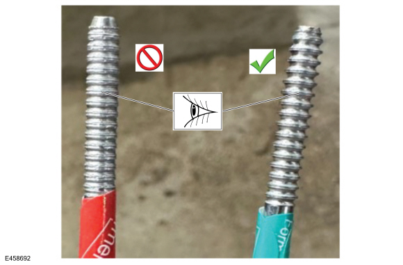

2. Inspect both tailgate latch actuating rods for damaged threads as shown in Figure 3. Do the tailgate latch actuating rods exhibit damaged threads?
Figure 3
Ford Maverick Tailgate won’t unlatch IMG_7354
(1). Yes - remove and discard the affected tailgate latch actuating rod(s). Refer to the WSM, Section 501-14 Handles, Locks, Latches and Entry Systems > Removal and Installation > Tailgate Latch. Proceed to Step 3.
(2). No - this article does not apply, perform normal diagnostics outside of this article. Refer to the WSM, Section 501-14 > Handles, Locks, Latches and Entry Systems > Diagnosis and Testing > Pinpoint test AB.
Figure 3
