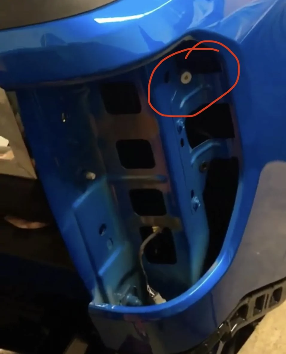

Tail Light Socket/attachment

Without pics we just have to take your word for it then. Good luck!

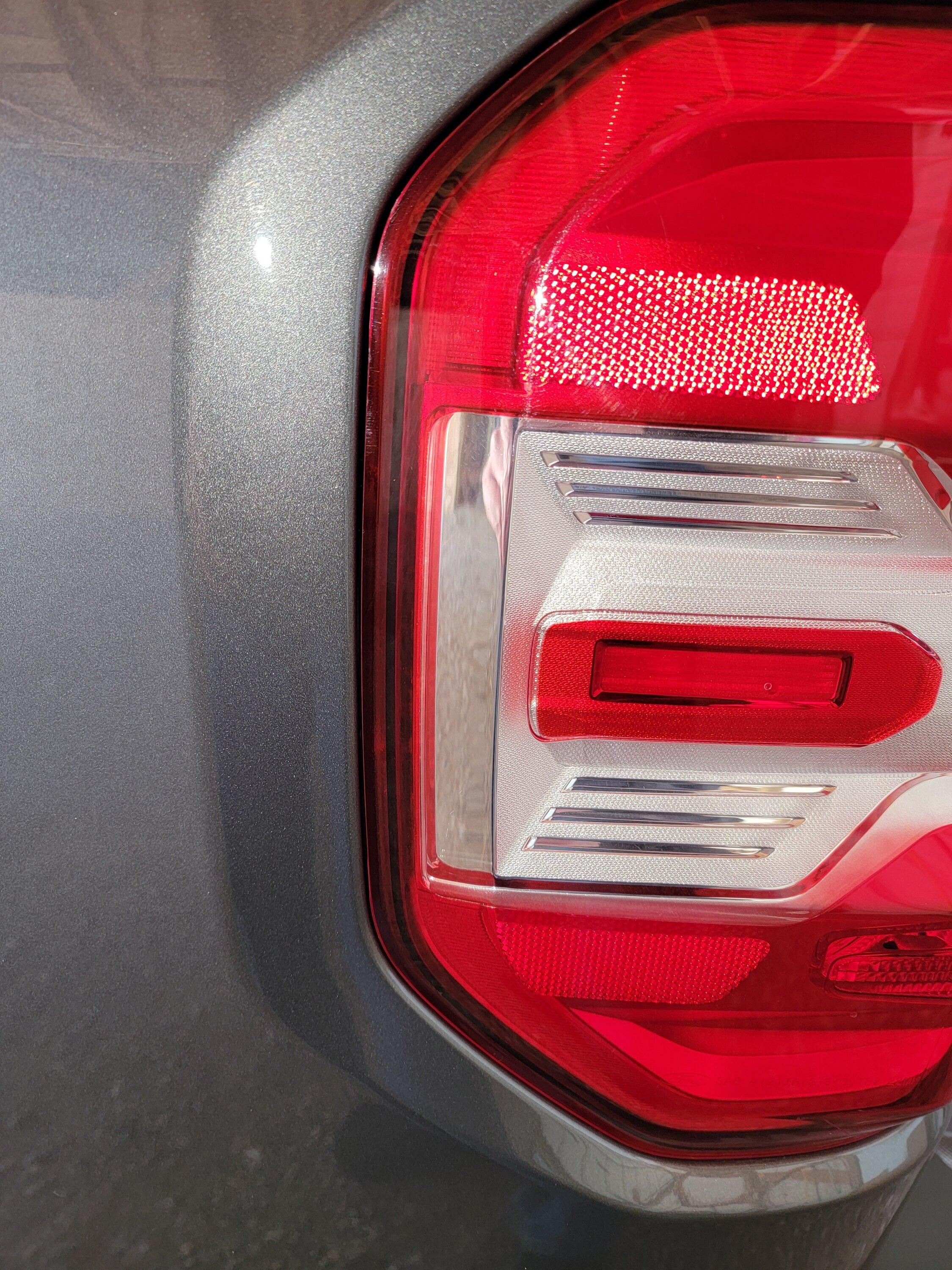

All I did was try to HELP confirm it was seated correctly. If you chose to take me asking for confirmation personally, then you had your mind made up before you even posted. Don't get mad because someone wants to start at the beginning and HELP to CONFIRM it's the clip. Like I said, I noticed the same issue and I told you how I diagnosed it. It's the internet... you expect everyone to just assume you did everything right all the time? You never make a mistake... huh.

Is a picture REALLY that hard? Jeez... At this point I'd be willing to wager you'd just leave it loose on purpose then take a pic. So, Take care. Good luck with your tail light. Like I said... we'll just take your word for it then.
"I'll end it" with a confirmation that mine is seated correctly and this is what it should look like:
Ford Maverick Tail Light Socket/attachment 20230724_135236
I was hoping to help save you the need for the clip, that's all. I'd wish you the same luck but after that response, I couldn't care less.

I had the same issue and posted about it under Fit and Finish. Basically, once you have everything lined up with the bolts started but not tight and the studs on the light fit firmly into the sockets (so you think they are fully installed) on the truck then just give the taillight a couple of strong taps with the palm of your hand over the spots where the mounting studs are. This will seat the mounting studs into the sockets. Mine haven't come loose since.
Good luck.

New retainers did the trick.
Sometimes the old ones just don’t hold no matter what you do.

It is plastic and like a lot of re-usable plastic pieces, some are, and some are not. It has a part number, order a new one...problem solved. Some of these plastic "seats" are damaged at the factory late on a Friday afternoon or early Monday mornings. I had to pull my RF fender splash shield off because I dropped the bracket for the hood strut down the inner fender. I retrieved the brkt and re-used all six clips. two popped loose and I replaced them with new ones. I bought a box of 320 of these various clips for $12 and have yet to regret my decision to get into the truck repair business this deep. LOL

I have ordered them. Just wasn’t sure what they were called exactly or a part number and was sure someone had ran into it before. Luckily they had and the part numbers were posted (and thankfully because I didn’t realize they installed completely differently till posting and looking at the parts diagrams). I used to keep all kinds of small parts for interior panels when I was doing car audio for people so I get it on why you keep a bunch of them

I'd call a body shop and ask what they cost before going to the parts department at Ford. The shops may have aftermarket replicas. They're usually cheaper.

They were $2 for 4 uppers and $2 for 4 lowers (only need 1 of each on each light). They’re $15 thru the ford parts website so the dealer would probably be $17 or so. I ordered thru ford.oempartsonline and got these and a replacement stone deflector (the mudflap/wind deflector in front of the rear wheel) for $30 shipped. And I didn’t have to spend time driving around (time saving is a big thing for me).
