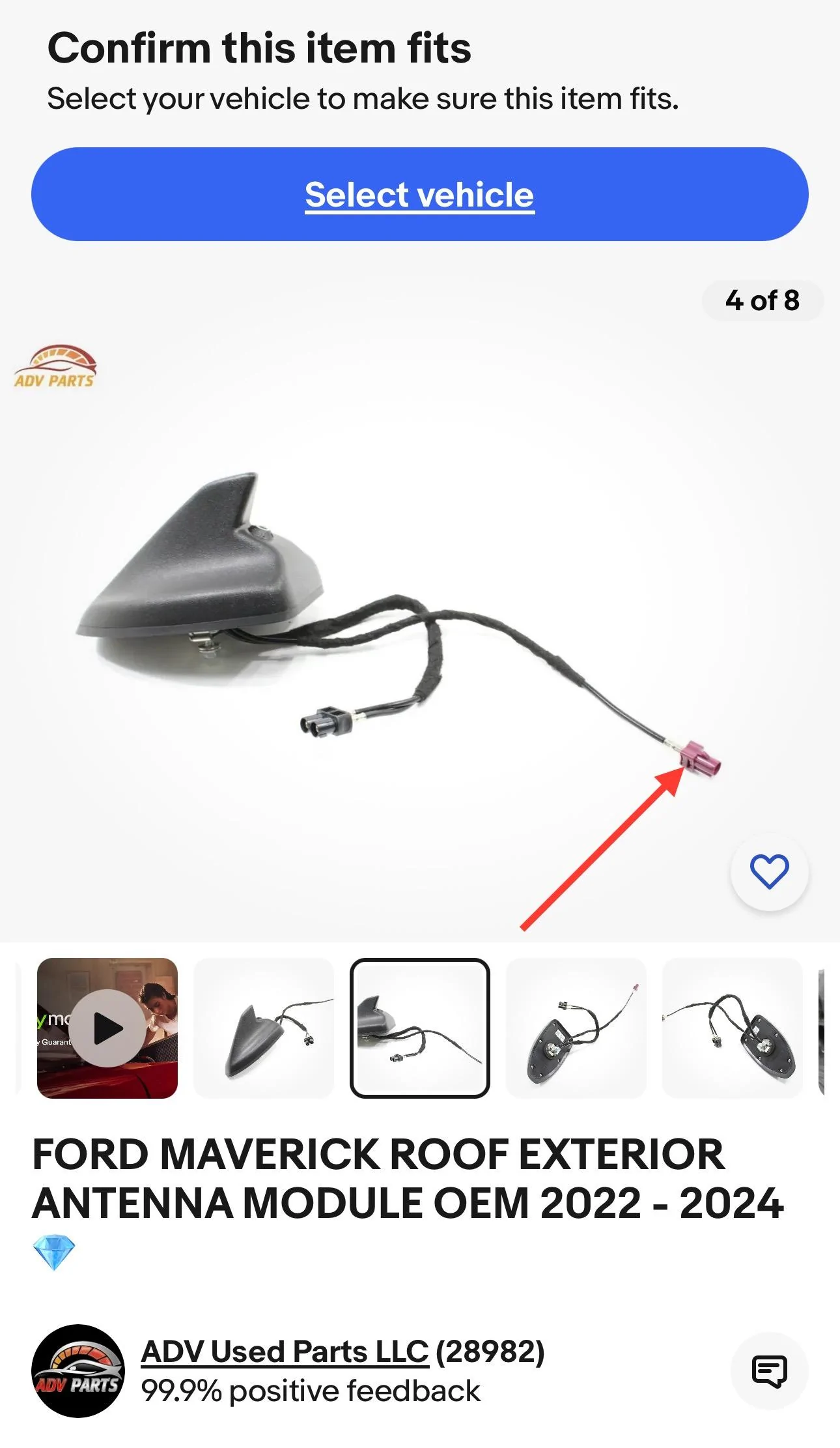

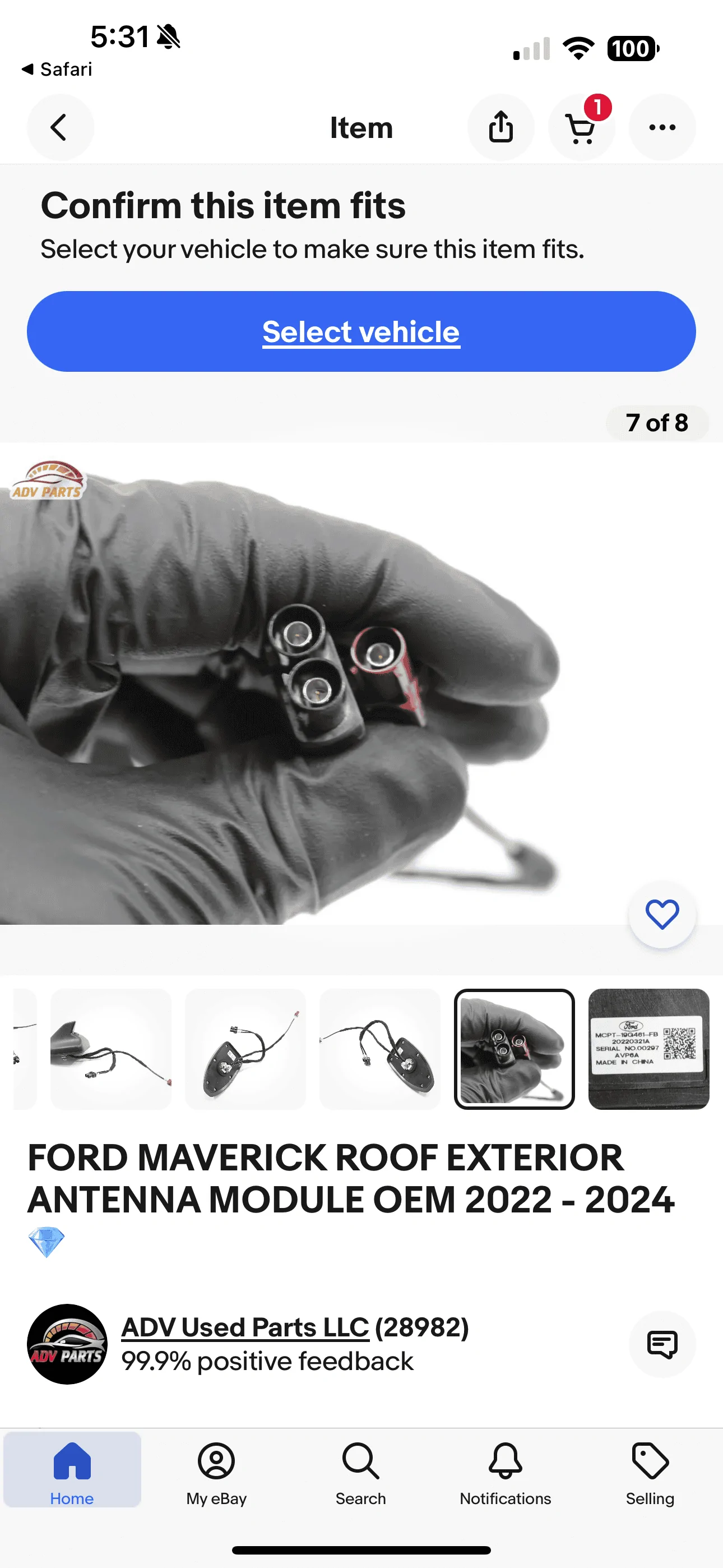

I apologize because I tried to find the post but I am struggling, where someone very knowledgeable has made a few scarce comments about this stuff. It's like the one thing they come on the forum to do, and their post on this issue was very informative. I've searched and searched and nothing is showing up, and sometimes we get lucky with the "similar threads" below the comment section here but it's not coming up with the results to clarify what that 3rd wire does. I'll keep an eye out or maybe that person will show up in this thread eventually and help shed some light on the issue for us.
The only thing I was able to come up with for sure is that there are two types of maverick antennas. One with satellite interface and cell interface and one without this more then likely is a lariat vs every other trim. In this link I found ford oem that specifies an antenna w/o cell and sat interface and in the blueprint pic it only shows one connector.
I’ll know for sure in two weeks when I take delivery of my truck I don’t even have it yet.
https://parts.lakelandford.com/p/Ford_2023_Maverick/Radio-Antenna-Base/103063137/MCPZ18936A.html
