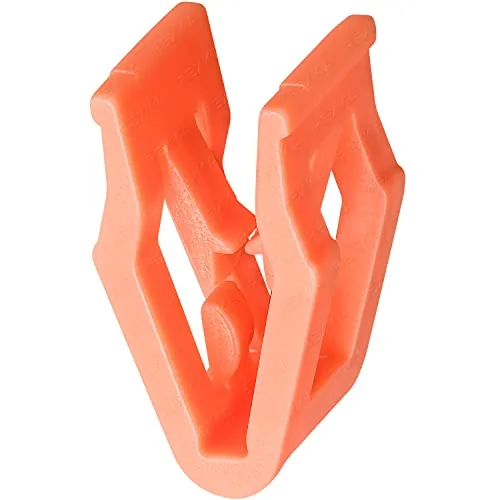

Best to pry them up using a plastic trim removal tool. They are held in place by number of push clips. But be careful to put something behind the tool so it doesn’t dig into the main dash plastic, which is very, very susceptible to being gouged.
Ford Maverick Speaker Grill Removal 1710537070332-zy
But I found the center speaker grille was solid, and the side speaker grilles were more likely to be rattling against the A pillar trim than against the dash. So pulling the A pillar and placing something soft between it and the grill may eliminate the need to lift the side speaker grille.
My biggest problem now is a periodic creak coming from the defrost ductwork, which is buried deep in the dash and inaccessible. I haven’t heard of others with this problem, so I’m still trying to track it down.

Thanks...I'll give that a shot first with some felt material and see if it resolves it.
