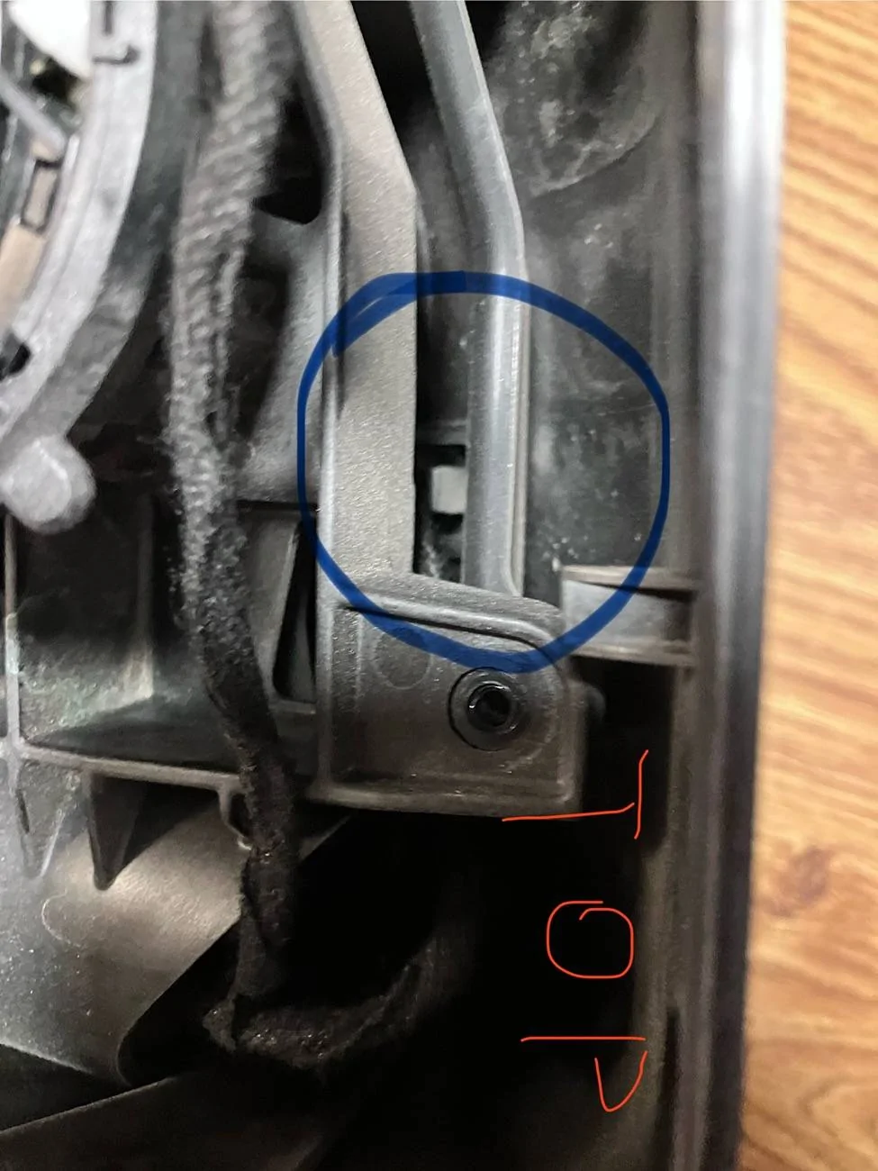

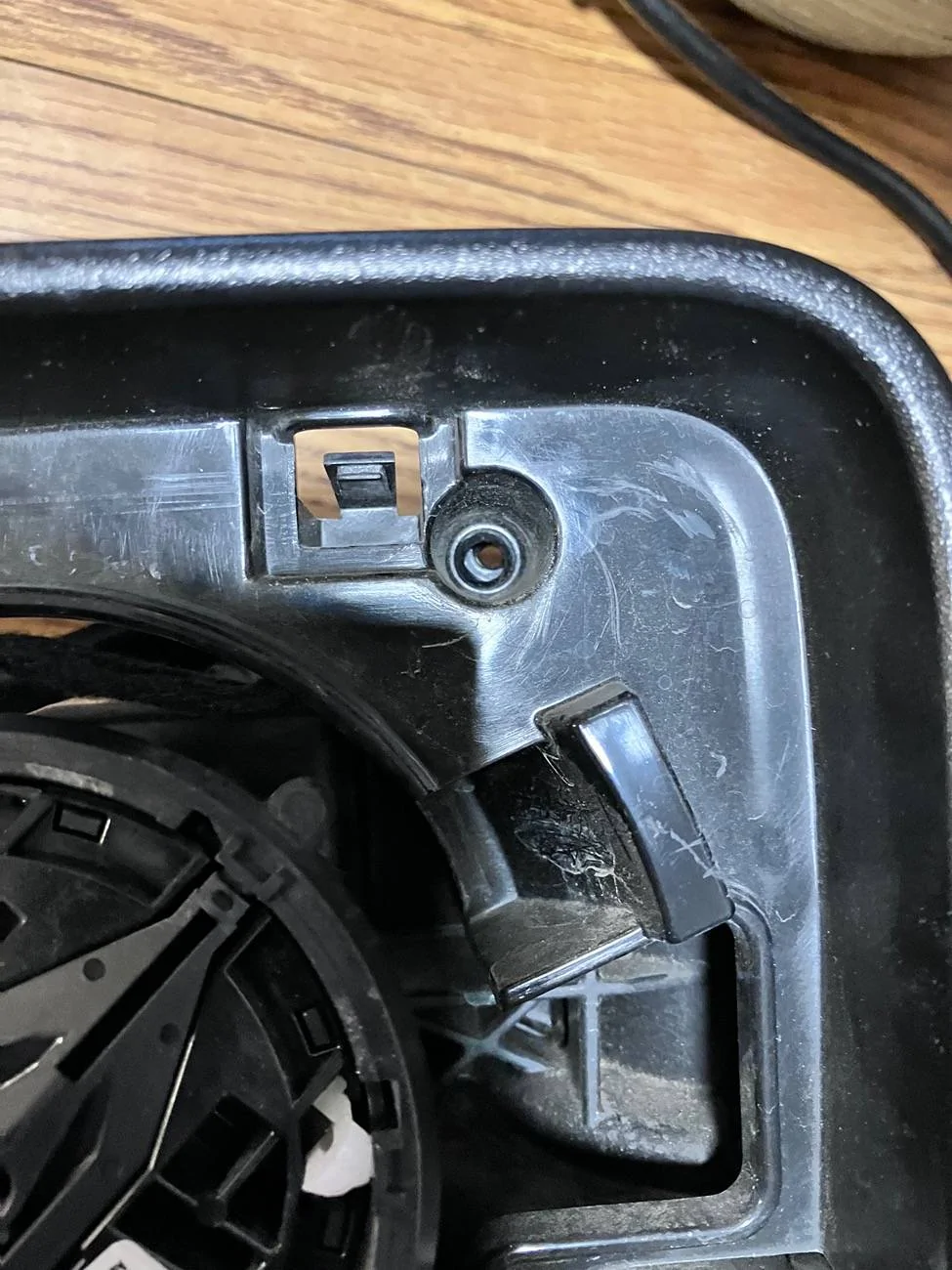

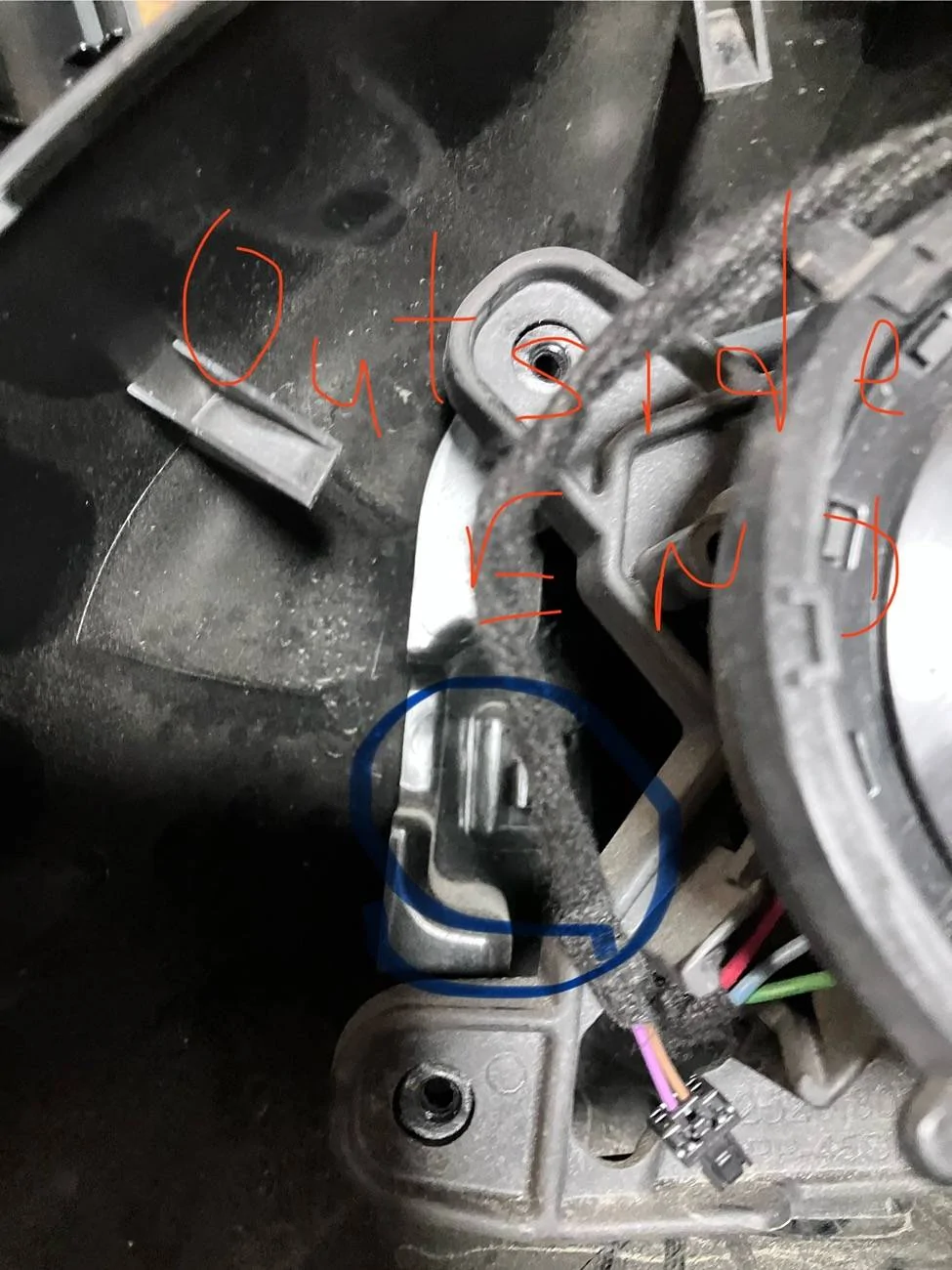

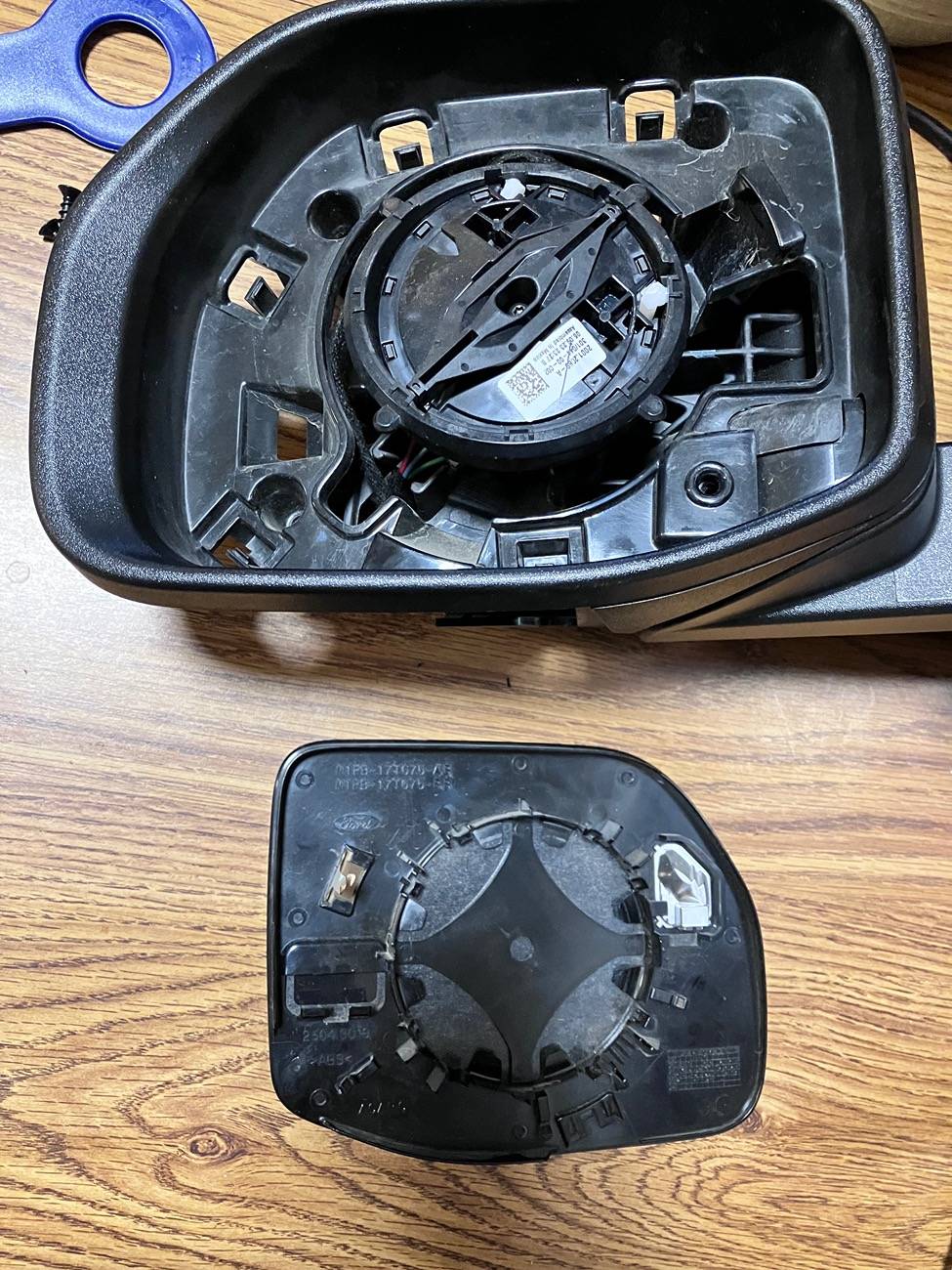

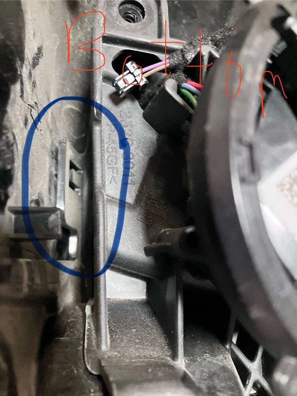

Found it. I had to replace the driver side mirror after my wife got too close to a wall in the parking garage at work.
First, remove the mirror glass, if you don’t have plastic trim tools try a plate spatula or wooden spoon. Form pressure increasing gently till it pops off.
Next, remove the 4 screws in the front bezel.
Then, move the five tabs away from the stands, they act like metal and will stay back to remove the front bezel.
Now, you can see the three tabs in the back on the rear cover. Bottom one is about an inch wide pry between that and the cover, second and third are on the outside end and on the top…very difficult to see and get to. This will allow the rear cover to slide off the back.
You cannot get to the tabs without removing the front
Ford Maverick Driver side Mirror Cover Removal IMG_4537
Ford Maverick Driver side Mirror Cover Removal IMG_4538
Ford Maverick Driver side Mirror Cover Removal IMG_4543
Ford Maverick Driver side Mirror Cover Removal IMG_4544
Ford Maverick Driver side Mirror Cover Removal IMG_4545
hopefully this is what you need to do what you want .

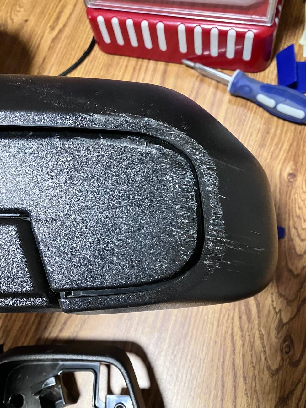

here is why I replaced it.
Ford Maverick Driver side Mirror Cover Removal IMG_4546
