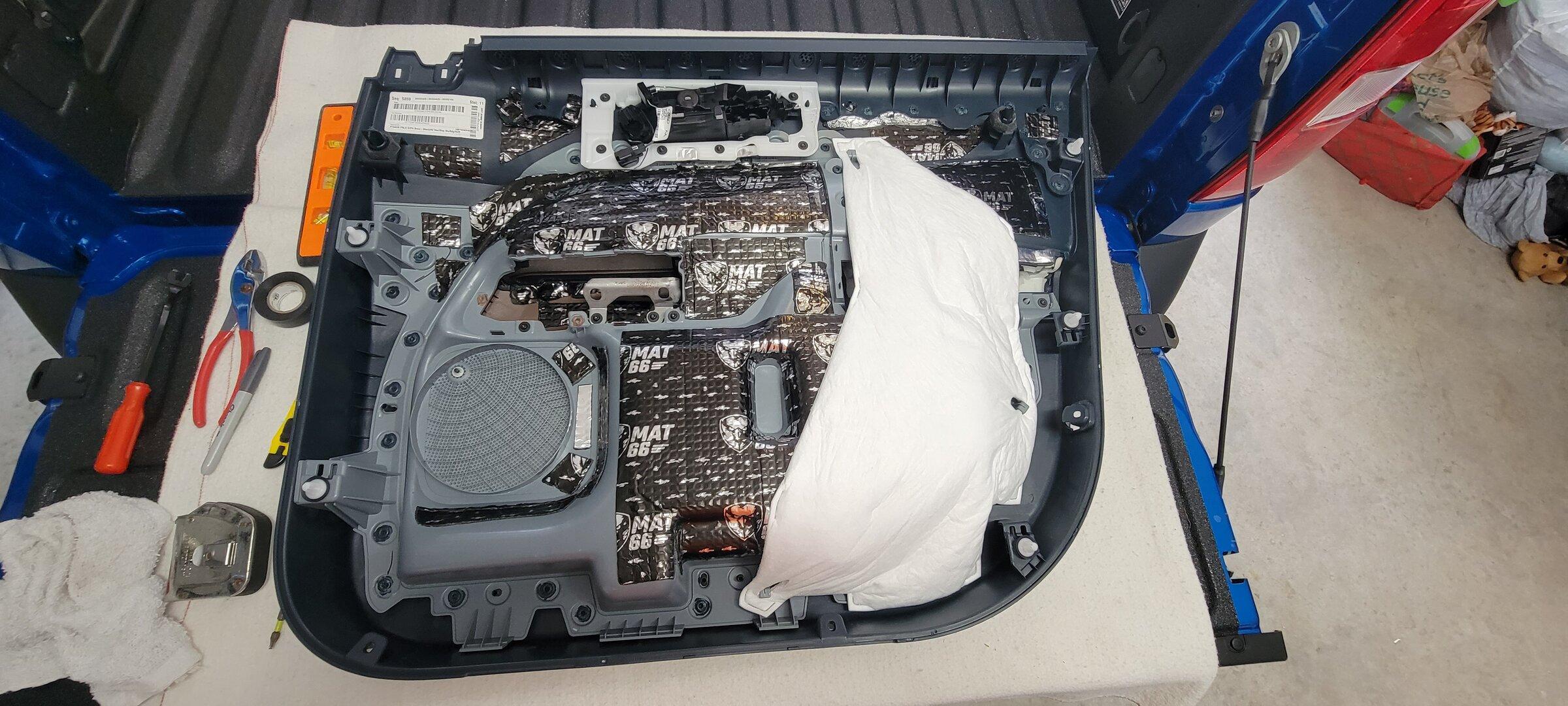

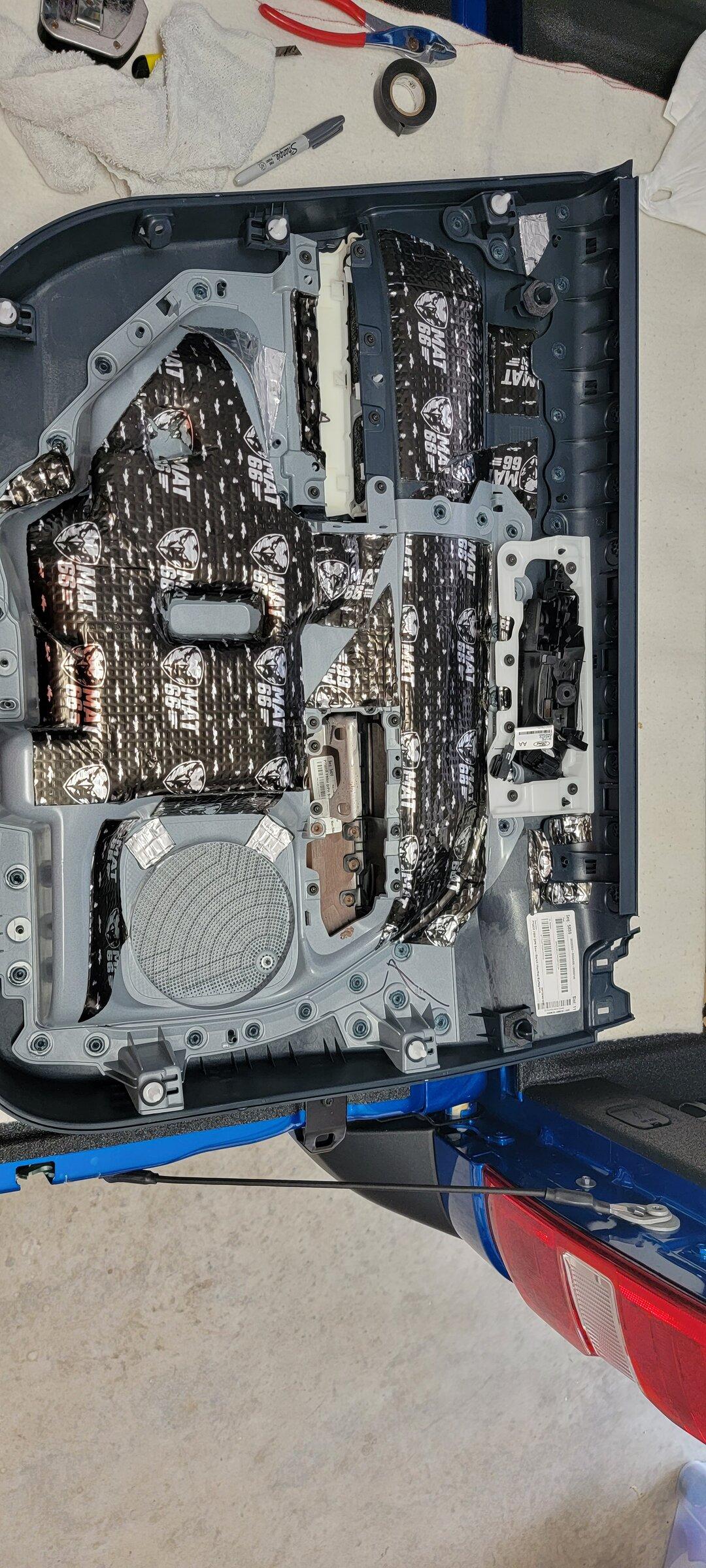

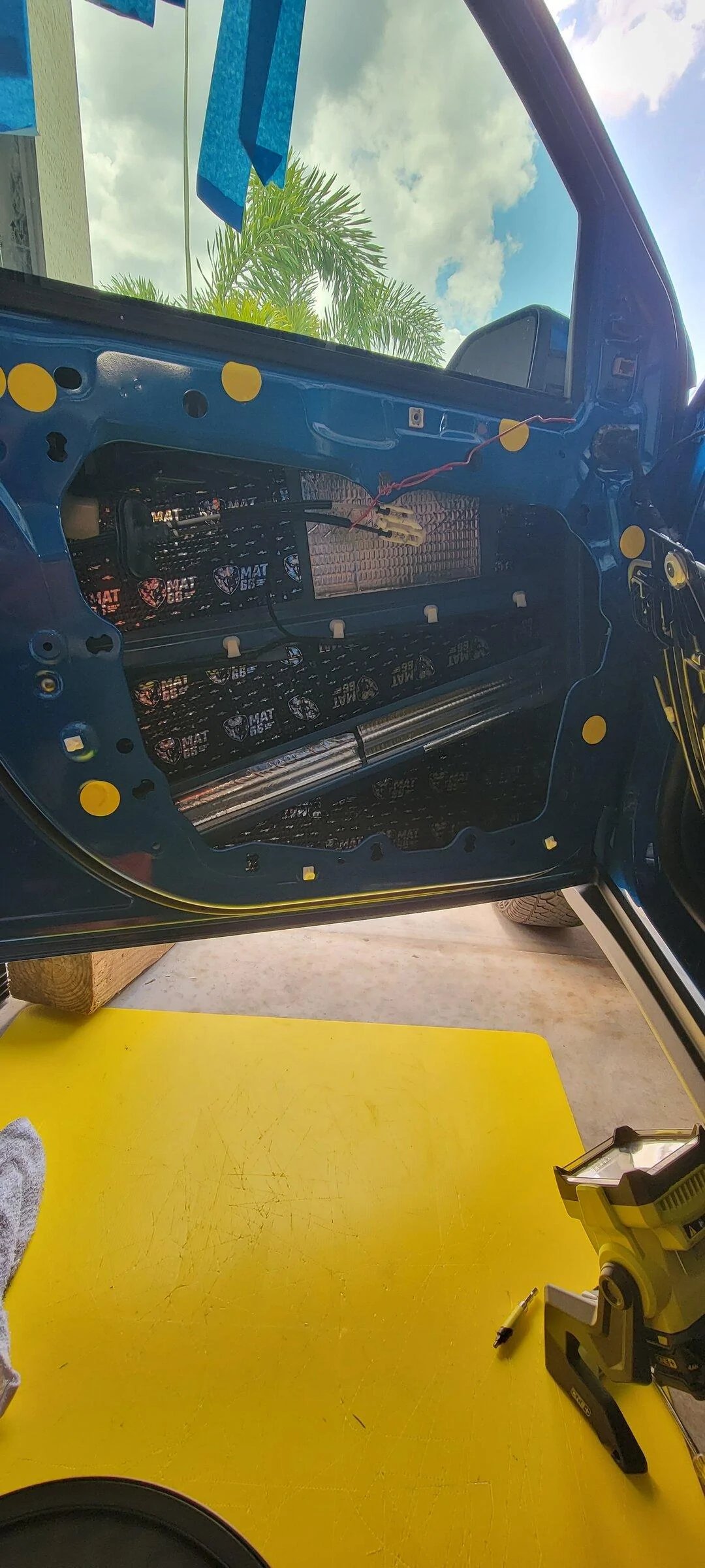

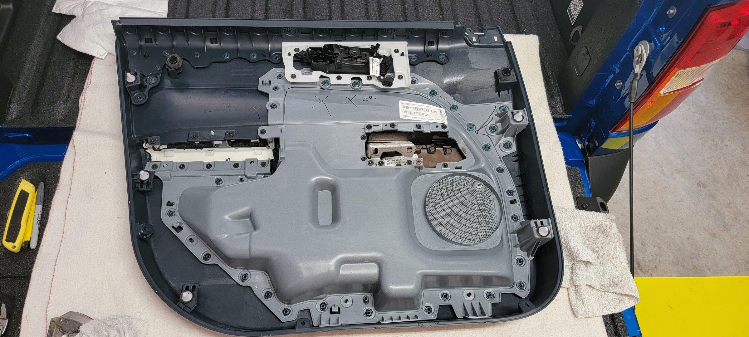

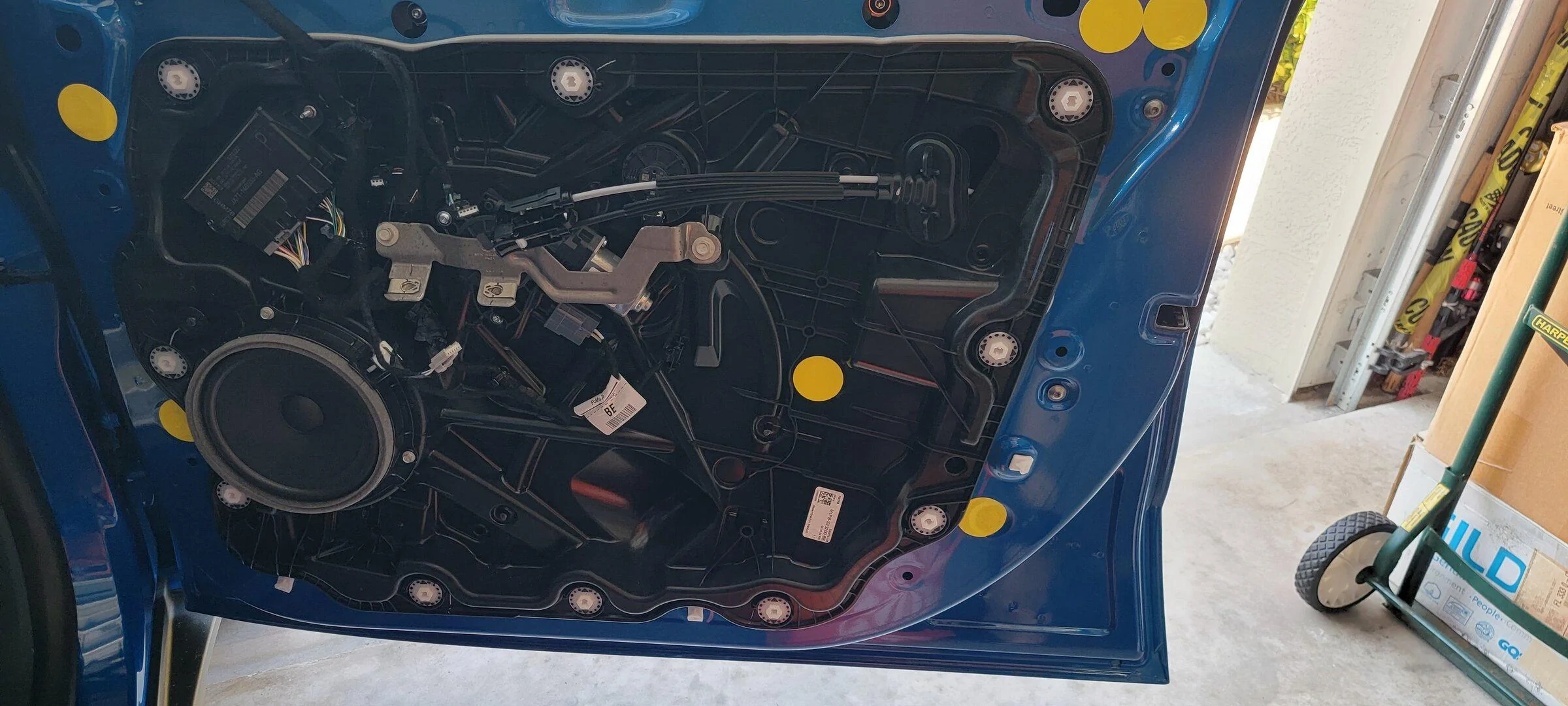

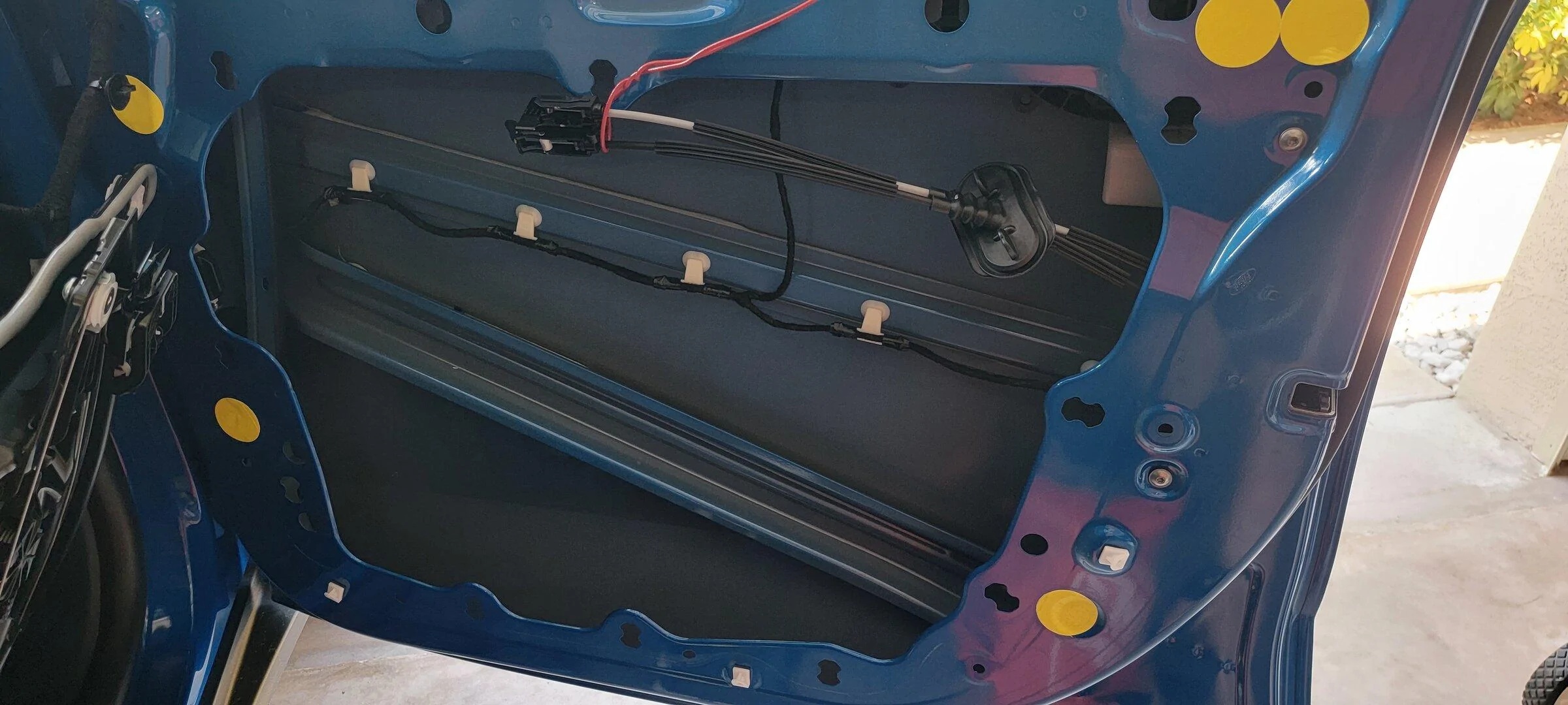

Much easier than expected. The doors are really easy to get into as long as you have the proper trim tools. The back wall was the biggest pain due to all the little cuts and shapes plus having to remove all the computers speaker and amp stuff. Here's a few pics. Absolutely no more rattling anywhere.
did you need to do both the metal side and the plastic side of the doors? Did you do any before and after sound measurements?
Thank you for laying this out. I plan to do the same. Do you have guidance on how to disconnect the lock cable from the back of the door panel? I've seen several videos on pulling the door panel but they seem to just leave the panel connected and move it to the side. Thank you
